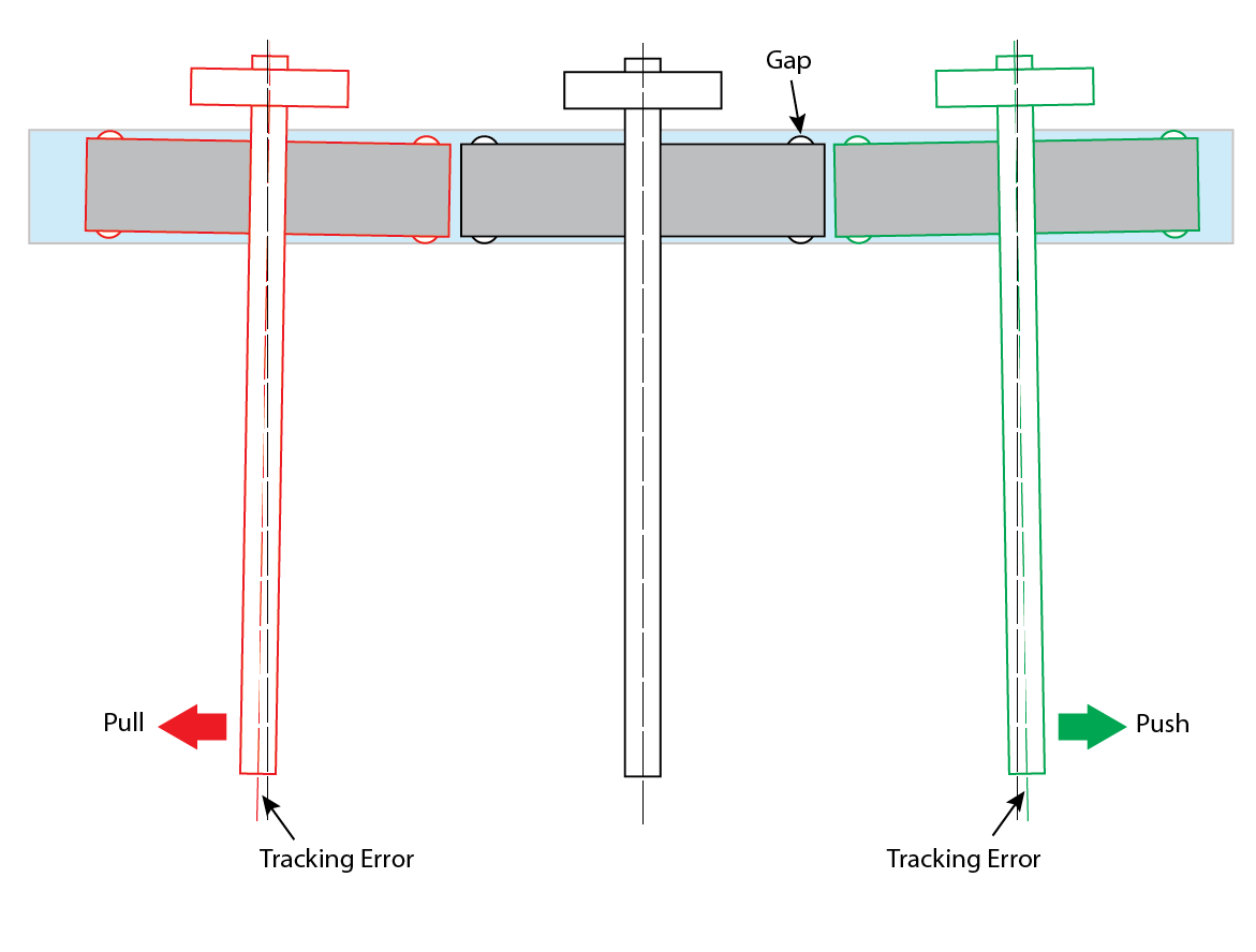

An interesting arm, real fresh water thinking.
With an air bearing friction is virtually zero. The addition of a silicone damping trough adds resistance to carriage movement that increases with velocity. The faster the carriage moves the high the resistance.
With a purely mechanical bearing the resistance to movement will be constant regardless of carriage velocity and no additional damping is required. (ignoring stiction)
By floating the carriage in water the load on the bearings will be reduced which will reduce bearing friction. Water has a much lower viscosity than the silicone fluid used with an air bearing, typically several thousand times lower. The contact area between the paddle and silicone fluid is normally very small. The contact area between the float and the water will be much higher. The resistance to movement offered by the water is likely to be not that different from that of the silicone fluid. The exact amount will be dependant on the shape and surface texture of the float.
A point that Mike made that I would like to back up is regarding the use of PTFE for making the wheels. As the wheels are designed to roll and not slide on the rail the coefficient of friction between the wheels and rail is not important. What is important is the rolling resistance. PTFE, being very soft will have a very high rolling resistance. Making the wheels out of a very hard material such as stainless steel will dramatically reduce rolling resistance. Think of a push bike tyre that is pumped up really hard, it rolls more easily than a soft tyre. The hard tyre still has high friction with road but still rolls.
The increase in the mass of the wheels using steel compared to PTFE will be negligible when taking the entire mass of the carriage into account. A harder material should have better mechanical coupling as a bonus. I would recommend making the bearing yoke as a more rigid structure linking the armtube to the wheels with the float as a separate structure.
One question. How do you prevent mold growing in the water. If this grows on the rail and wheels it will coat them with a soft layer that will increase rolling resistance.

They roll on glass in exactly the same way as steel, but the sliding material of the PTFE allows you to slide very well on the stainless steel axles.
Also, fluoroplastic does not oxidize and does not rust in water, nothing happens to it at all. The same tonearm worked for me for about a year, that was 9 years ago.
The room is very dry, but I still thought about a couple of silver coins in the water for my aqua tonearm. Well, in order to avoid mold, although ... I think I'm more likely to get moldy than the water in the aquarium.
Off in a different direction now Havun!! if you configured the carriage like an air bearing but instead immersed it in a bath like your aqua and pumped incompressible water (a fish tank pump?) would you get the best of both types?Since a vinyl player is a resonant machine, it is clear that it will be as you described - with one pronounced resonance, one instrument or group of instruments will sound better, and with another pronounced resonance ...

I think this is a legit argument. However, I am still not convinced yet. Further investigation is needed.Here they offered something other than water, glycerin for example, but precisely because water is very malleable, I used it, we must immediately consider the purpose for which it is used, if we are talking about a speedboat, then yes, water will resist.
Here is a diagram to illustrate my viewpoint when I said that the accuracy of the wheels and the wall of the water container is problematic. From the diagram, you can see there is a gap between the wall of the water container and the wheels. Once the record moves, as in your video, the eccentricity of the record will pull or push the arm sideways. It will cause tracking errors. There is also a dilemma. If the gap is too small or nonexistent, the effects of record eccentricity will put all the effects on the cantilever. The cantilever will be bent unless there is very small friction between the wall and the wheels. If the gap is too large, it will produce large tracking errors.Knife wheels have a very small area of contact with the ideal glass surface, they are also attached to thin stainless steel axles, in the working position they are moistened with water, so they work out the eccentricity fabulously, it's nice just to look at it (I'll shoot a video .
I am not convinced either. Further investigation is needed, too.The float is large enough and does not sink in water, when loaded, the water level does not even reach half of its thickness of the foam material. Yes, and there are no such loads to change its position in the vertical, there is only a load in the horizontal, this is the sound track of a rotating plate pulling the tonearm .
