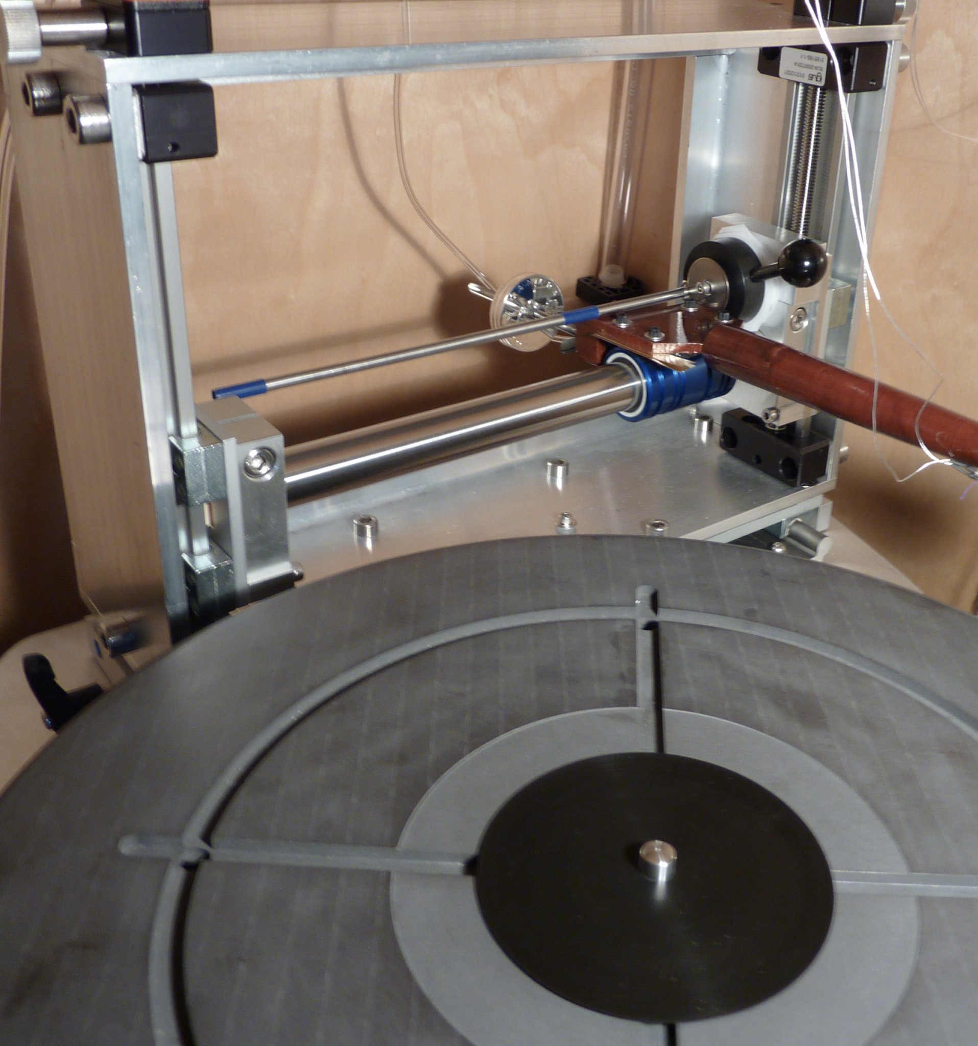

Hi.The main disadvantage of an air bearing is that the air gap is a spring.
Niffy
Let's compare the "spring" of the thin air film with the "spring" of the bearing backlash of the tonearm, what will be the values, or do you think that backlash does not exist🙂?
Further, if we consider the modulation of the groove, we see that it has the greatest deviation in the horizontal plane, and this in turn means that the horizontal mass of the tonearm must correspond to it.
The vibrations caused by such a groove will certainly affect the vibration of the bearing of the tone arm, so the tone arm will sing its own song 🙂.
In my case the tone arm has one rigid structure moving parallel to the airfoil, there are no bushing or ball bearings with their backlash and wobble in them.
In the horizontal area it is a very rigid design, that is where the groove (its modulation) has the most deflection, which means that the hammer (head needle) corresponds to a heavy anvil and will fly off it well.

Niffy, you've really helped me with my warped record problem. And with many other topics related to linear trackers. A question, though. You mention a 60mm washer underneath the label, which I have approximated by a linear slope rather than a sine. Which part of the sine do you recommend? That is, what is the domain of your curve?
By the way, my current implementation of air tonearm and air turntable, proudly displaying it's Delrin washer.

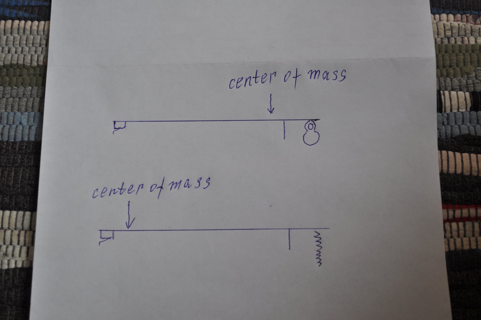

I have an idea to use an air bearing parallel arm without a weight (weight) and use a spring instead, but this requires another rail with air supply.
Details for this have long been made and lie for several years.
The bottom line is to reduce the horizontal mass of the tonearm and not only.
I've tried this on a regular tonearm (spring instead of weight), it works and avoids one of the biggest resonances that a long shaft on one side and a weight on the other side ringing like a bell.

Hi Havun,
Wouldn't the mass of the second air-bearing/sledge add more horizontal mass than that saved by losing the counterweight?
One of the points I have raised several times in this thread is that higher horizontal effective mass, that is inherent with linear arms, is beneficial.
If you are using a long armtube then the total mass might end up being a bit high due to the need for a heavy counterweight. If using a short armtube the mass of the counterweight will be lower reducing its negative consequences such as the lowering of the arms resonant frequency and increased reflections from the weight.
In my book any additional mass should add to the rigidity of the arm. The addition of the second bearing/sledge will not add to the rigidity of the arm.
Niffy

We are interested in the stiffness of the structure - the tone arm + the length of the skids, it is this triangle must be large and rigid.
For this purpose, in my design the length of the skid is sufficient (large) to create such stiffness.
Of course, the weight of the additional slide (for the spring mechanism) is several times less (you can weigh it on a scale) than the weight of the load, but this is not the main advantage, the main advantage is the center of mass, it in the case of the spring is moved to the head and it eliminates to a large extent the biggest resonance of all tonearms with the load.
Hi Havun,We are interested in the stiffness of the structure - the tone arm + the length of the skids, it is this triangle must be large and rigid.
That all makes sense. As you are not using a moving bearing type design the additional mass of the extra "skid" will be much lower than I had envisaged. It is a very interesting idea.
Have you considered placing the counterbalance spring and skid in front of the main bearing? This would allow you to shorten the armtube as you wouldn't need anything sticking out behind the main bearing. As the lever length from the main bearing to the spring can be made longer a more compliant spring could be used (more linear?). The second air track could be positioned above the armtube so that an extension spring can still be used and to allow easier record changing. The spring could be above or even slightly in front of the cartridge.
Niffy

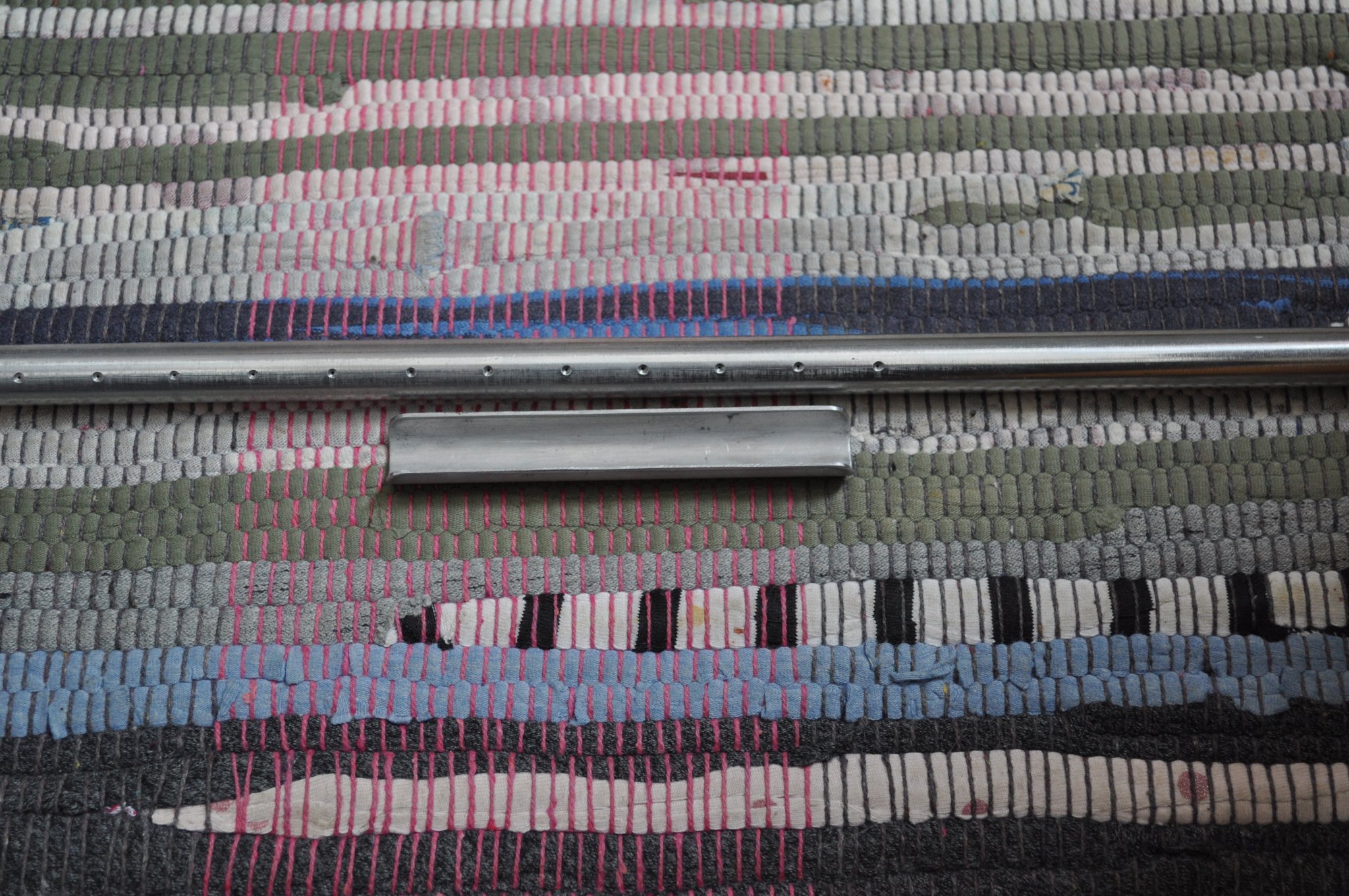

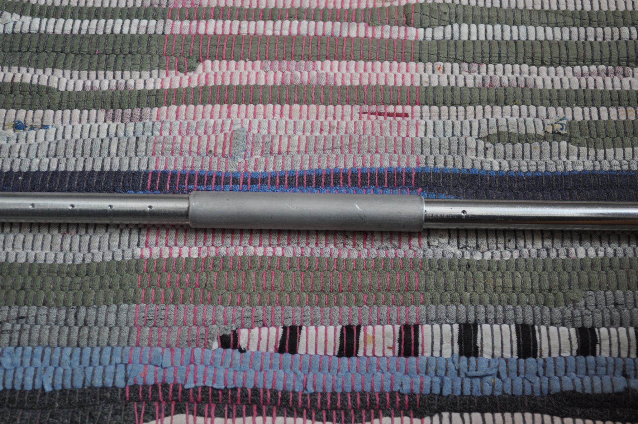

I am not a supporter of the short tube tonearm, consider it my little whim🙂.
First of all it is uncomfortable, it complicates the construction with all kinds of knots, which tend to loosen and create backlash, which we are trying to get away from here.
That is, everything should be extremely simple.
I use a thick-walled tube of small diameter, which already takes the resonance down in frequency.
The second air rail for the spring I plan to place at the bottom of the main one, make a notch on the tube of the tone arm where the load is now and with the help of a thread to adjust the tension by 1.5-2 grams in the area of the needle, it's elementary.
Two air bearings will move in parallel, because the friction in them is minimal, almost absent at all.
It is only necessary to roll up the sleeves and...do.
