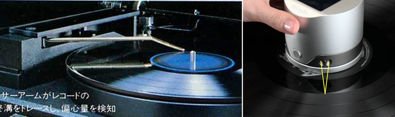

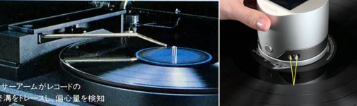

yes - but how does that device know the runout of the grooves? The Nakamichi measured it with one small arm and centered the platter by consequence - No magic.
In the video this device instead is simply used above the spindle of an everyday TT and, by rotating, those recesses (laser+photocell?) measure the runout of the engraved area?
attachment - just my guess.
carlo
.... with a reamer - funny!

I guess the device uses optical light to detect final runout groove and then it determine the true center of the record. However I am not sure if you need to modify the records or the center spindle in order to use the device. If you have to modify the record or the spindle, the device is meaningless not to mentioning the price.
Glad you all are confirming that my #4686 hypothesis of the inner groove laser reading is correct*. And now i understand why it must be held steady at start.
