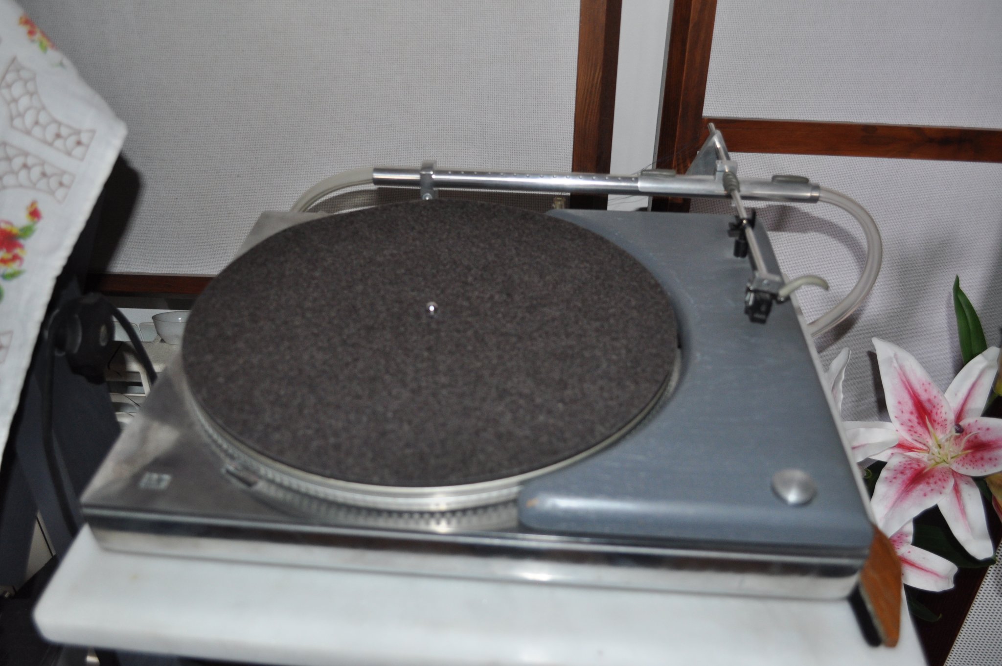

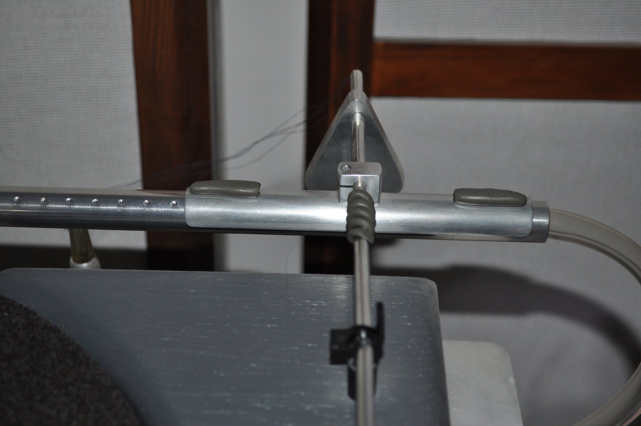

Hi friends. Guess from three times why I did this, namely, I placed a special mastic in some parts of the tonearm🙂?

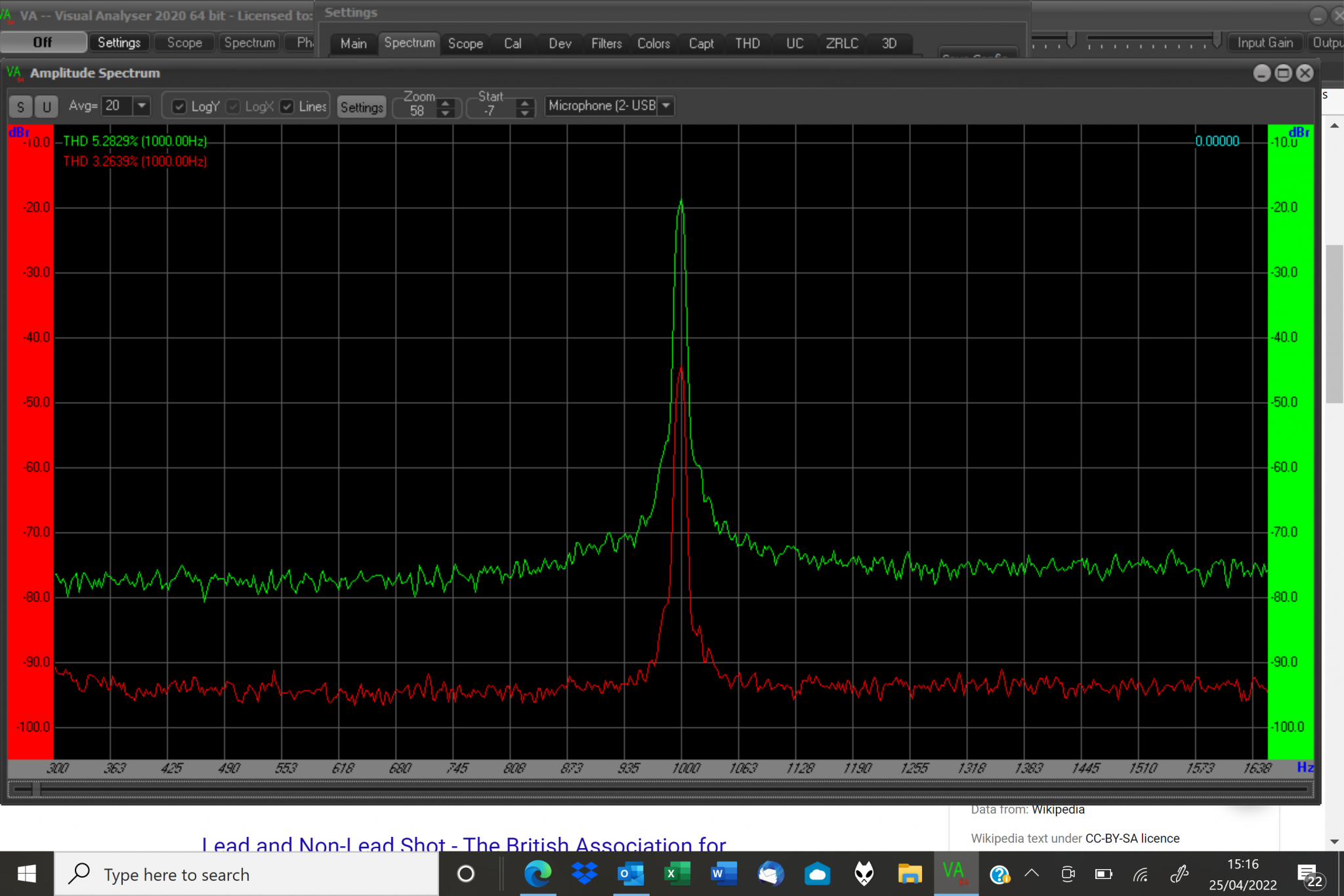

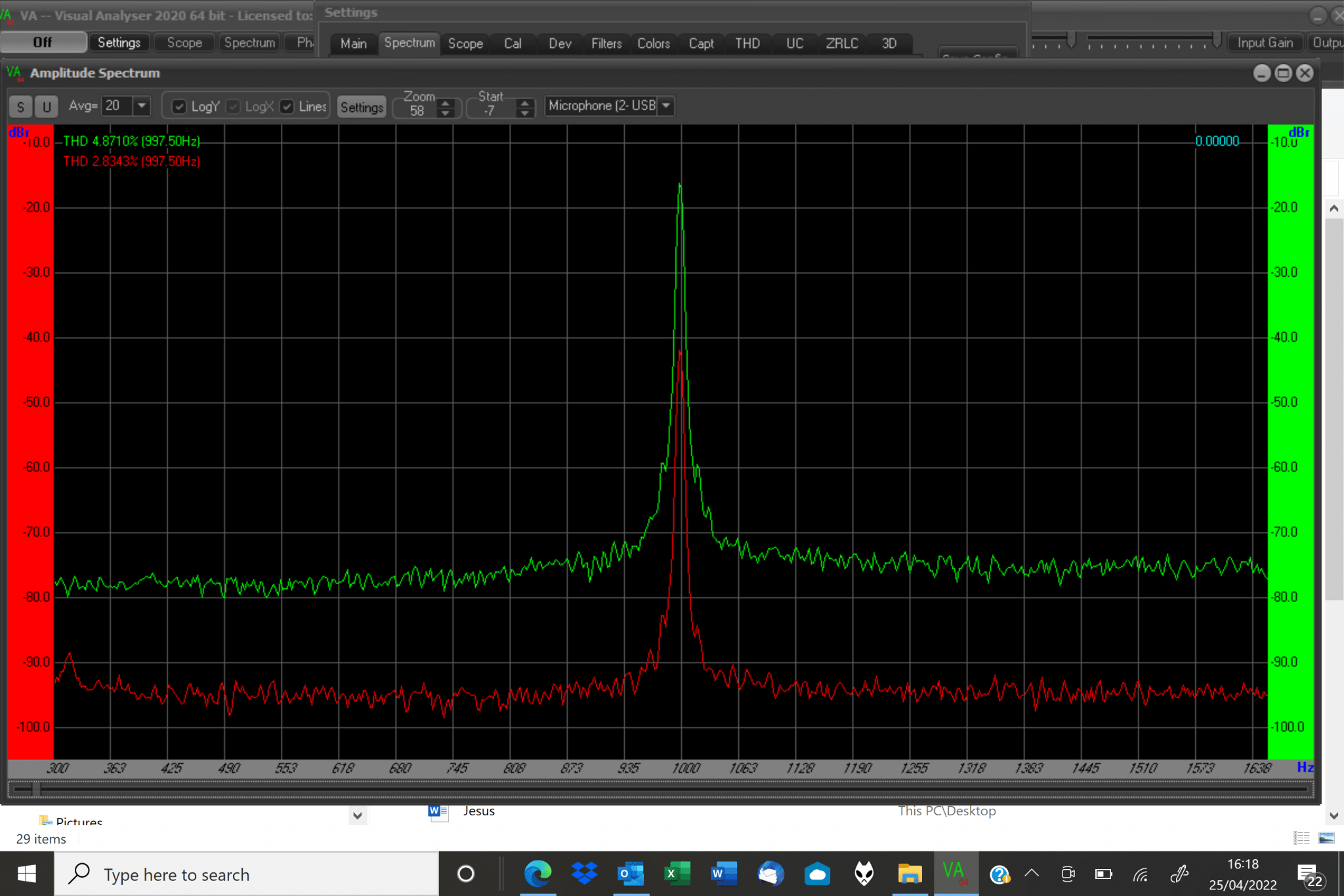

I guess you did this for damping but the weight will have some effect as well. it is definitely interesting. My experience when i do something similar on similar arm parts is that it sounds clean but dull and the measurement changes from a sharp spike which shows artefacts to a wider spike which masks them.
Here first attached is a measurement of my current set up 1416 with no damping of any mobile parts, just very stiff and light parts. if i damp those parts it masks what is happening see 1414, so i find that damping is very critcal and sometimes misleading. Do you measure your results as well as listen?

Mike, I'm glad I'm finding a soul mate, I use Google to translate one language into another, so unbalanced actions are possible. Yes, I completely agree with you that the damping of one spectrum interferes with another, but our task is to reveal the subtleties of this process. Do you agree with me that the vinyl player is a resonant instrument in every way? We are with you and other people who are passionate about this process, we only find and reveal these subtleties. For fun, of course.
In this case, I wanted to remove the sound of air, which is certainly present in this, this is air pressure. You will probably laugh, but I record the analog sound of Vinyl on a video tape recorder, as a carrier of analog sound, and its technical characteristics such as 15Hz-35kHz at 0 dB recording can cause many feelings in the head of an audiophile. 😀
Of course, the air bearing is the most ideal in the case of a parallel tonearm, but it also has its drawbacks, and this is the sound of a compressor, in order to suppress this sound of a compressor, I use two receivers (ordinary water filters), at the beginning of the air hose and at the end, this works . In the presence of a good vinyl corrector, all artifacts are reduced to a minimum, that is, the musical signal is given the cleanest. Subjectively.
Not just weight or mass, but horizontal mass, and if we imagine what a sound track milled with a cutter is, we can find that the horizontal mass of the tonearm is very important, because the tonearm stylus works like a hammer in relation to a heavy anvil and what a big difference of such masses, the needle will track the groove of the record better and better.
