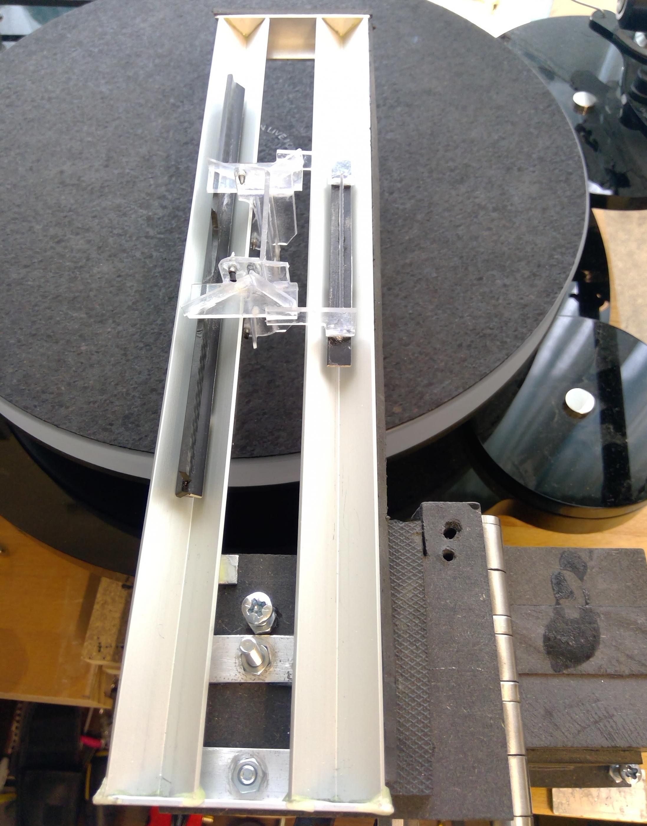

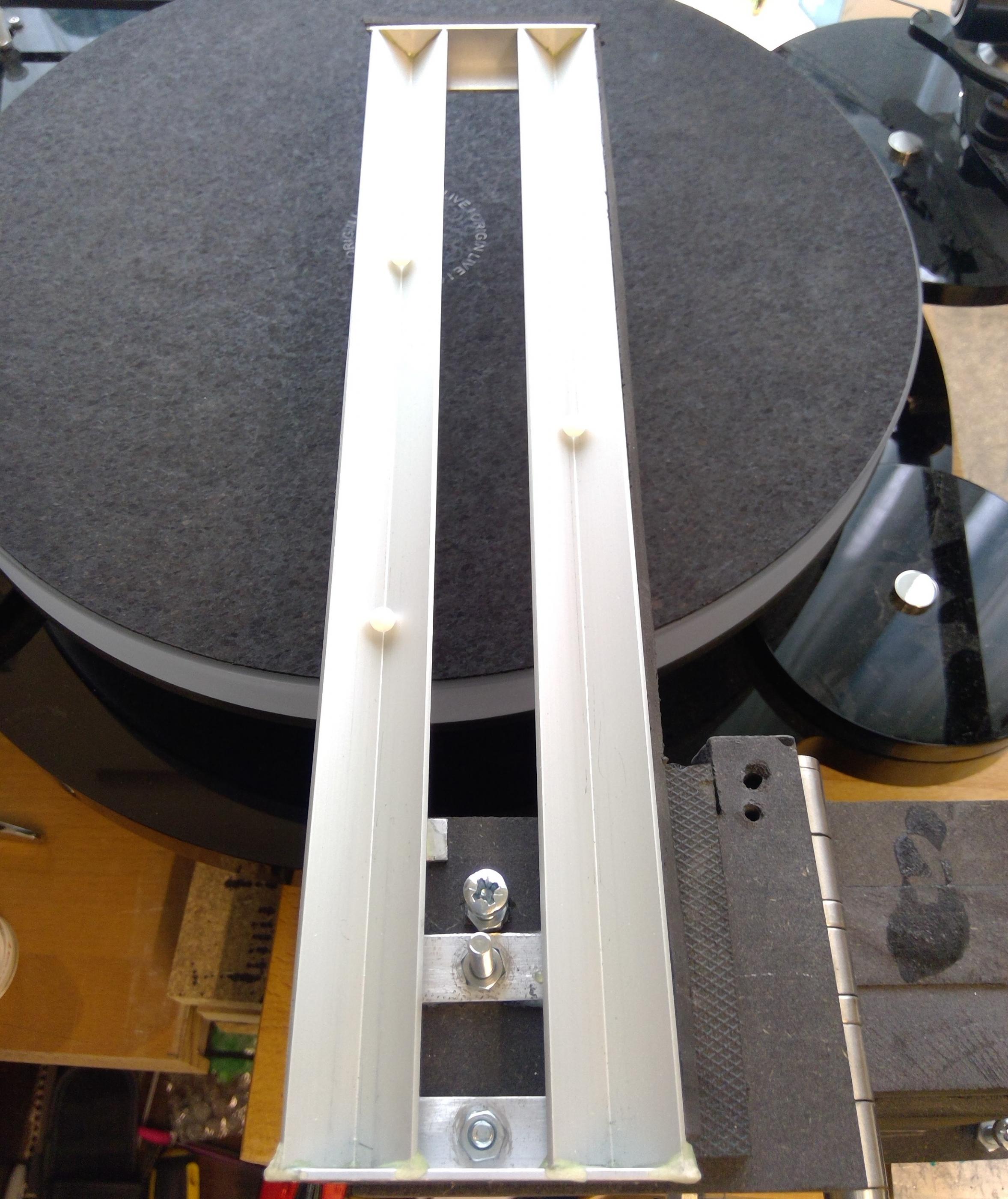

Hi Carlthess, i attach hereto pics of the current state with apologies for poor workmanship, its been "adjusted" many many times. It is also made with hand tools only, saw, file, drill.
Some white background aids visibility
Six pictures
1. Rails and balls
2. Cart on rails

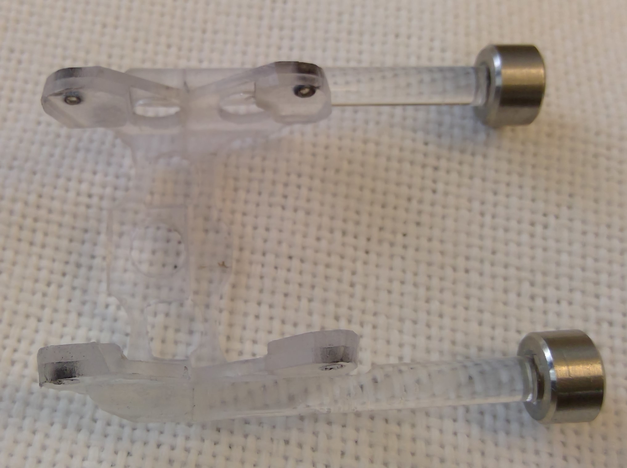

3. Cart with pen tip pivots mounted

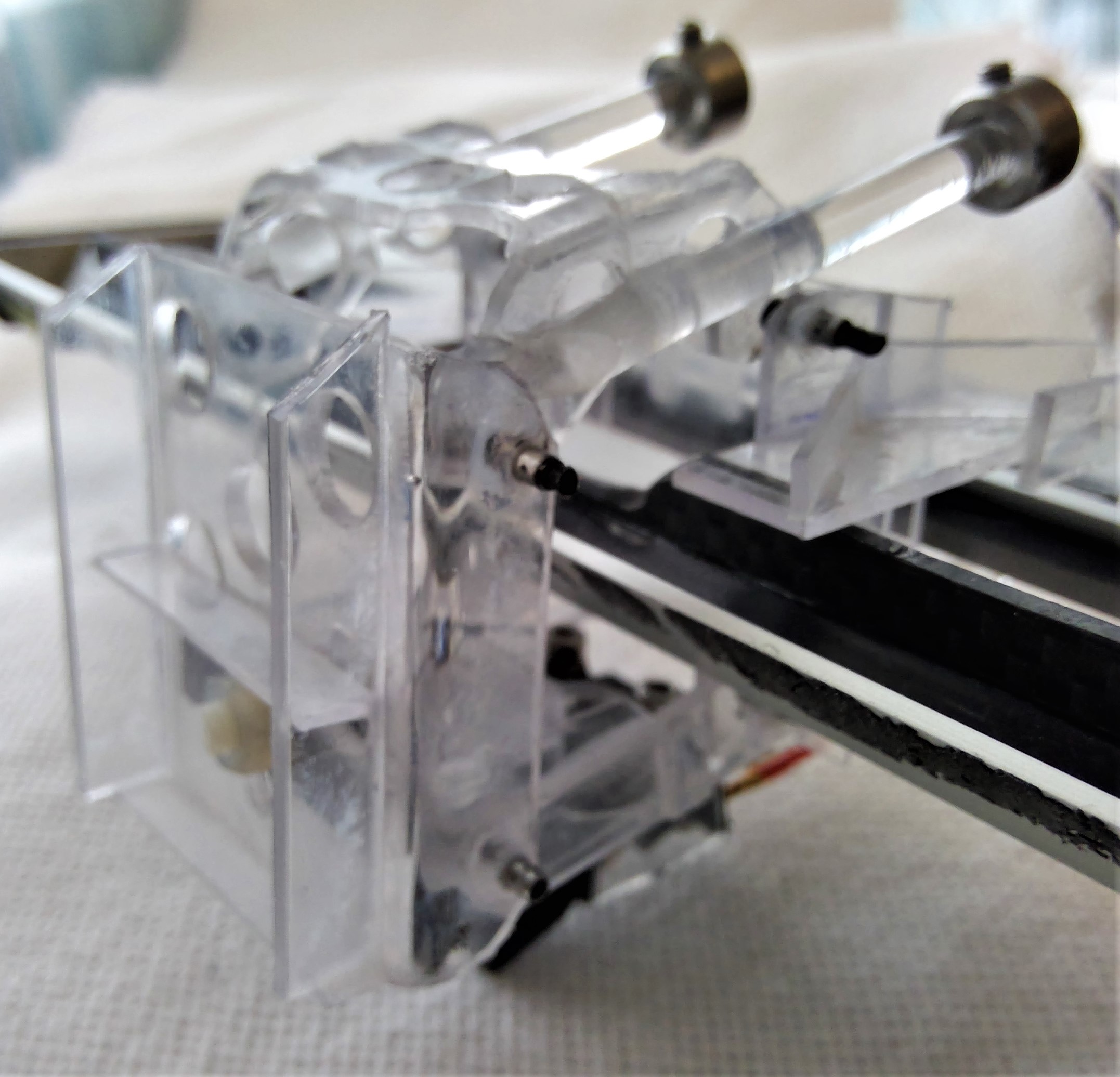

4. Top parallelogram plate that fits between pen tips

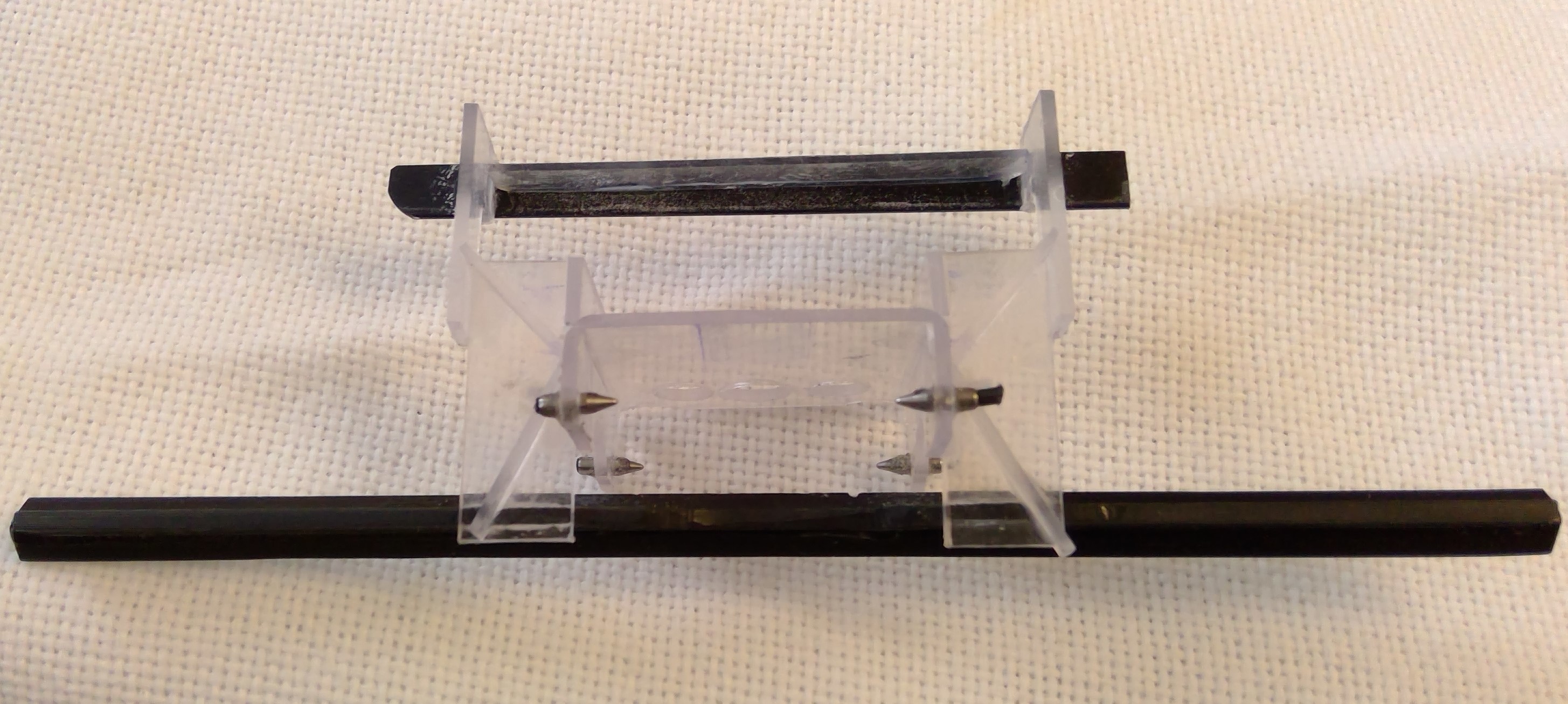

5. Paralellogram on cart

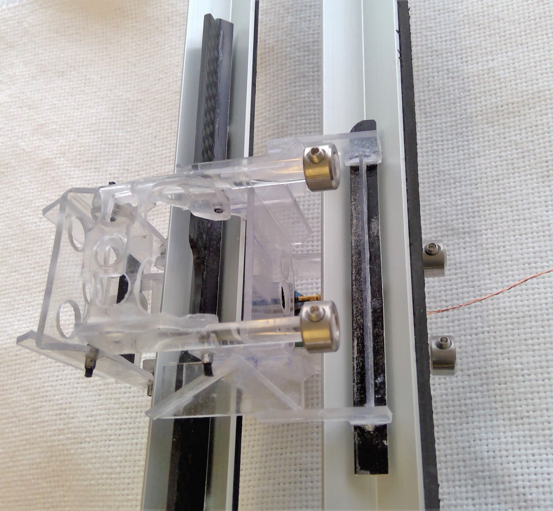

6. Other view
Hope this updates all
M

Hi Mike,
First, usually, a heavy carriage does sound better. But you need to think about other factors as well, such as friction, resonant frequency, and compliance of cartridge. If the friction is zero, the carriage should be as heavy as the resonant frequency and the compliance of the cartridge allow.
This thread is long. I have confused with your previous version of the arm. Now, I saw the latest version of the arm. I have to say it is a very clever design. You have put your mind and passion into the arm. I have been enjoying the process as well. Although the arm is not perfect, I would say the ideas are very creative. Kudos to you and carlo!

Thanks for your thoughts and comments above, and also to other recent respondees. I am pleased it raises interest and that some of you like parts of it.
How about you all (Jim, Carlthess, DD, Carlo, Koldby, Ed, Warrjon etc to name a few in no particular order and apologies if i have missed anyone out) team up to help me make improvements as my virtual design team on this thread? - respond if you wish, not if you don't?
Two topics to start with;
Resonant frequency,
1. how much does it matter and why,
2. is it likely that this configuration compares in any way to a conventional PTA in terms of analysis
3. Maybe there are a series of RFs in various planes in different parts
4. How might i measure it/them
5. What to do about it/them
Friction.
The current configuration has quite low friction. It will only occasionally stick after re-assembly but seems to settle after a few sides and will only stick if i inadvertently dump dirt in the rails. However i would like it reduced and have more tolerance. This is ceramic 5mm balls on anodised aluminium surfaces
1. How can i reduce friction most easily and gain tolerance
2. has anyone tried teflon self adhesve tape on the rails?
BTW, one of my aims is to build with inexpensive parts by hand, depending on what you buy or have there is very little material cost involved here.
Any other areas anyone thinks should take priority?
Best to all
Mike
