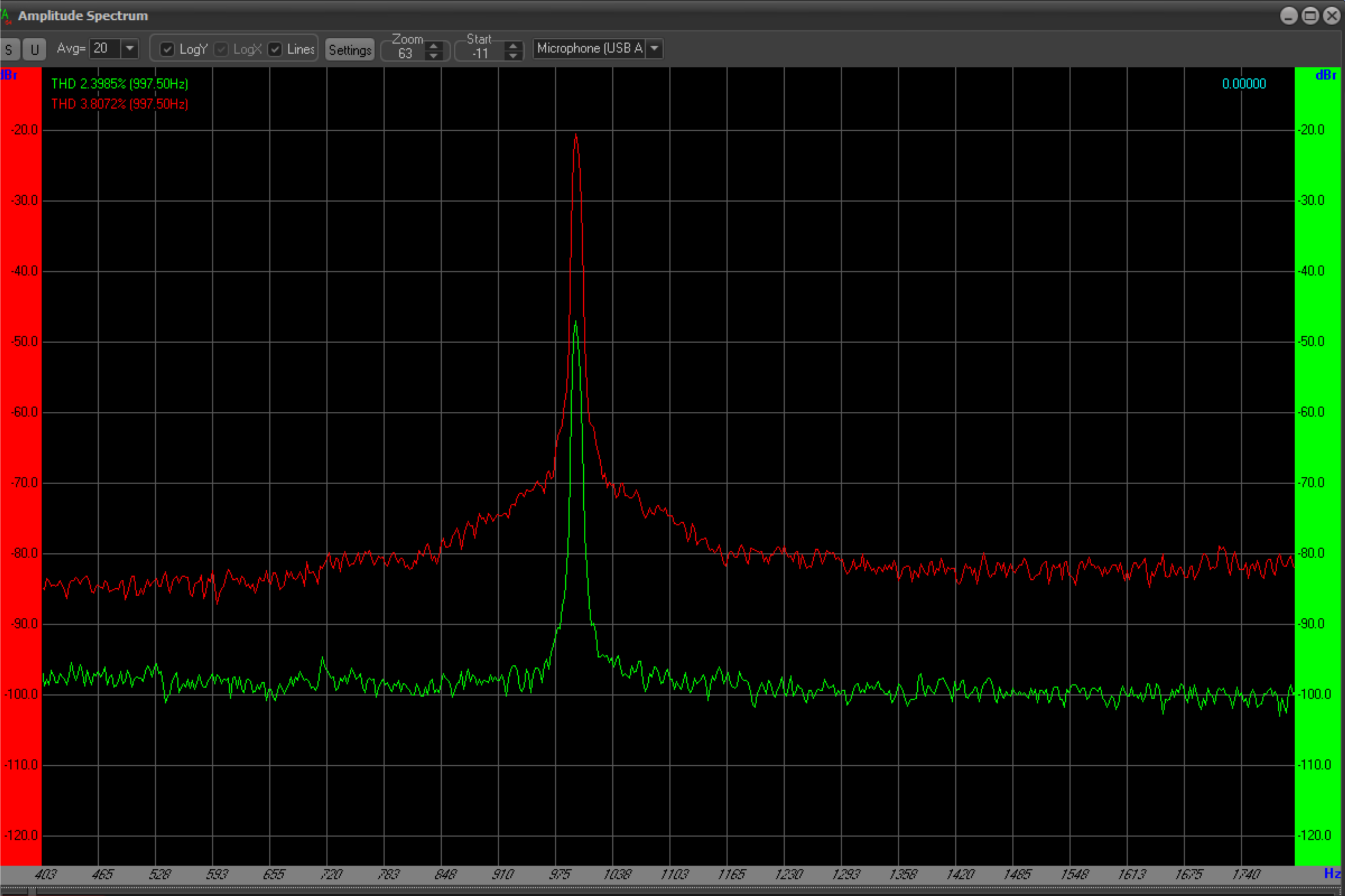

Mike. That reduction in sidebands indicates that you have removed some of the toner resonances.. Well done. The 40Hz issue has to be related to the turntable.. it went away when turning at 45RPM.. do you know the RPM of the driver motor? Forgive me.. Is this a belt or direct drive system?

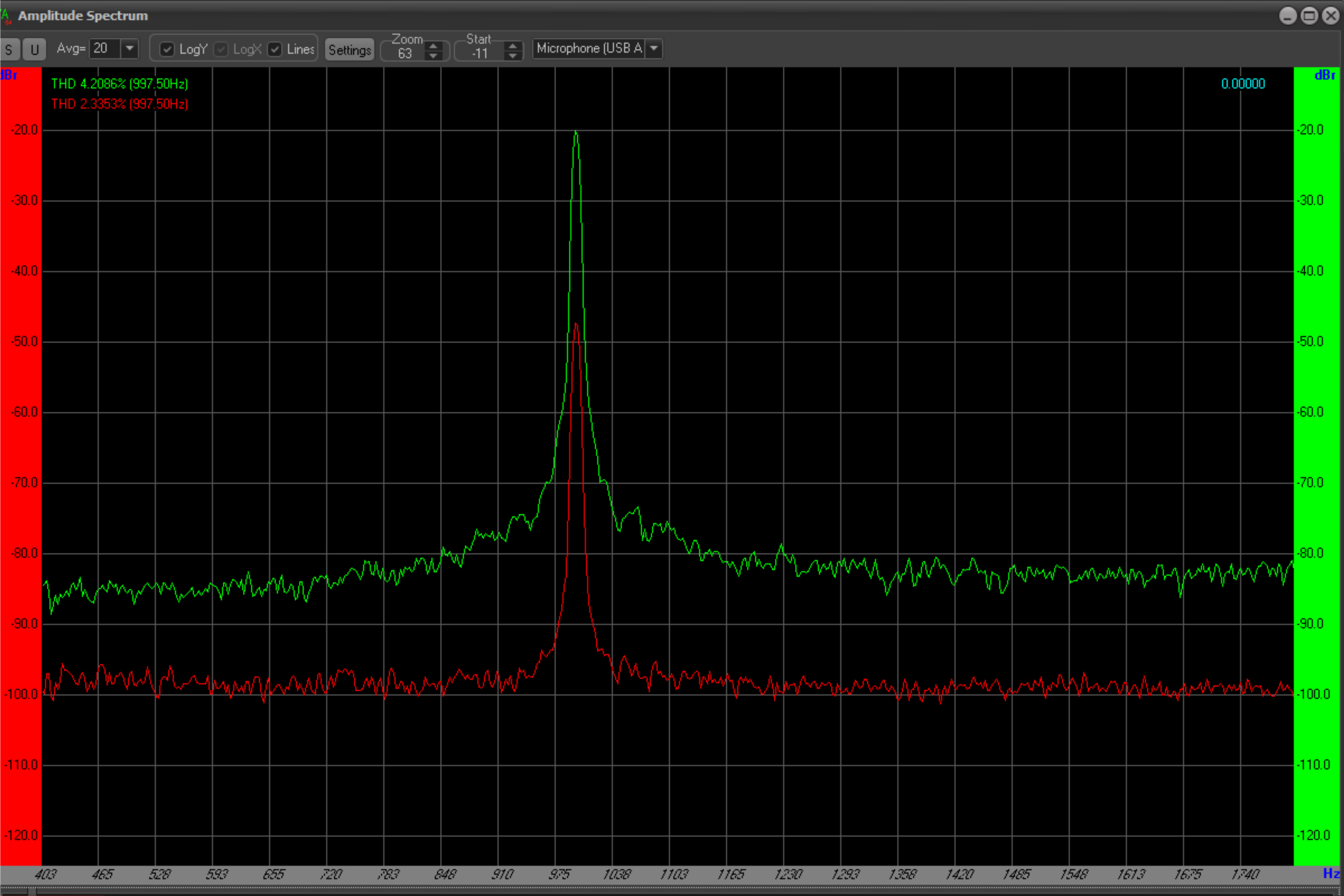

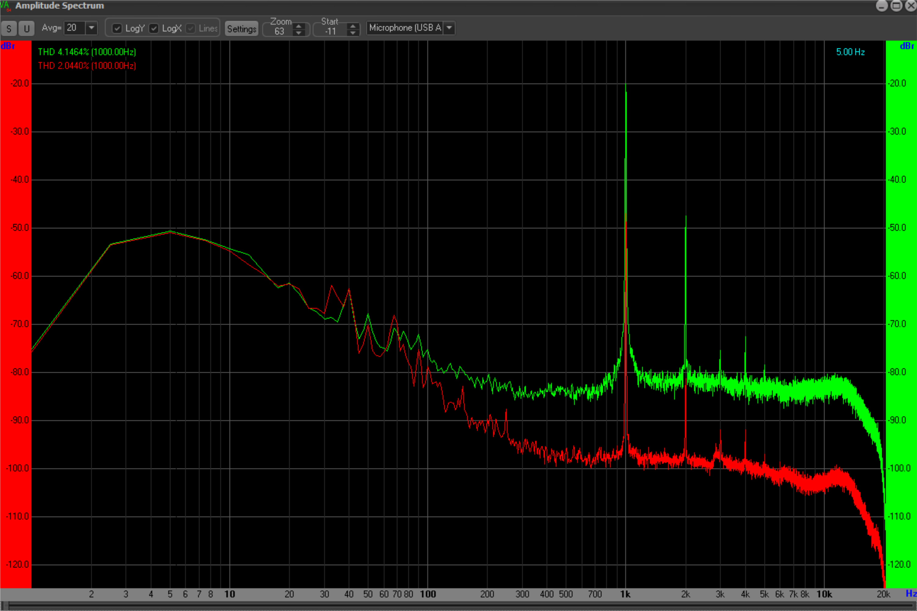

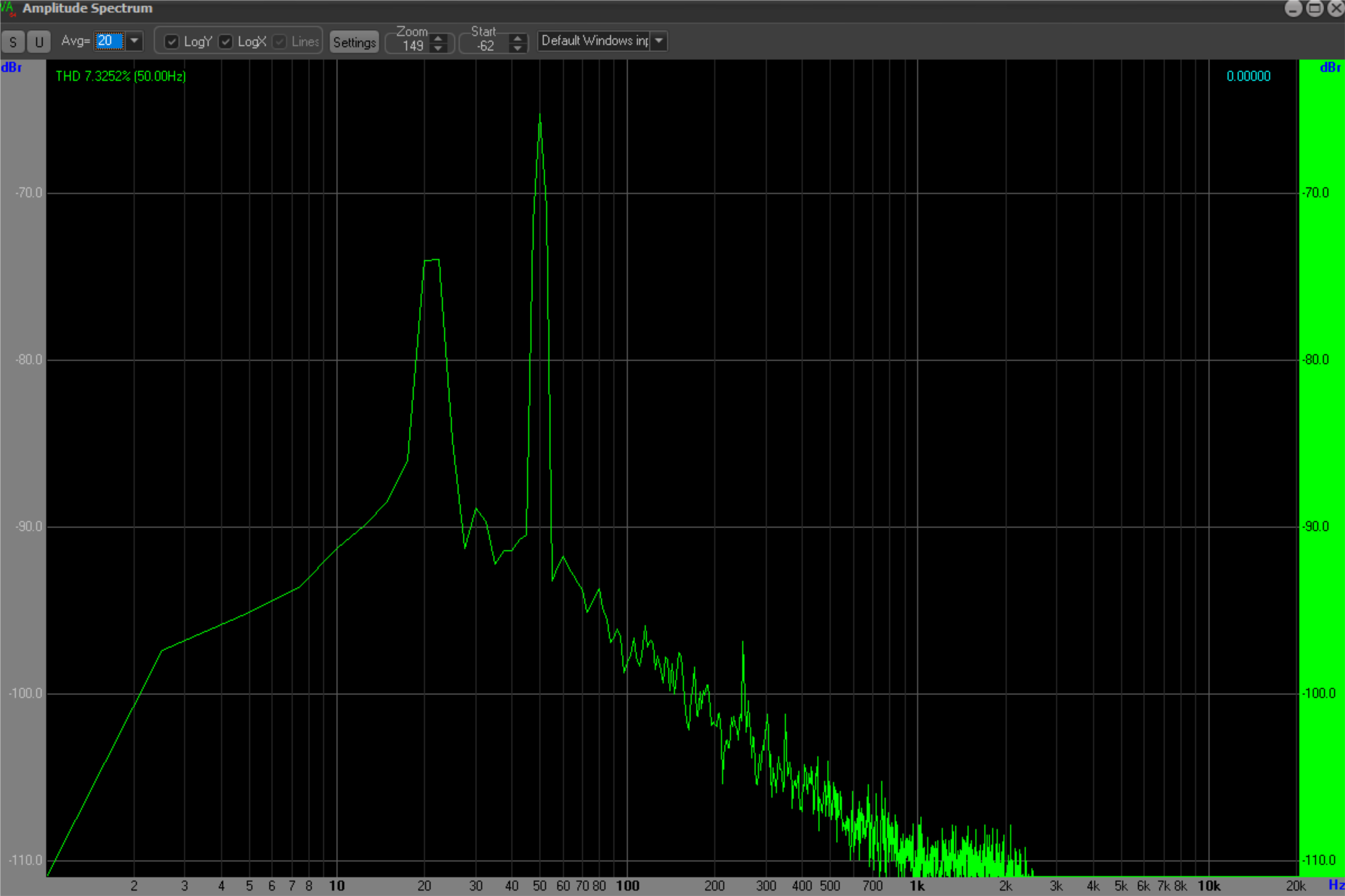

Hi there and thanks, i was puzzled by that result i thought it would go up in frequency with the motor if that was the case?
i dont know the motor revs but i measured its spindle as 8.5mm diameter and the platter at 295 ish, says the motor must be 1156rpm?
the TT is Origin Live Aurora IV, i can detect no noise from it in my measurements by any method I've worked out so far.
Here attached is screen shot 255 with the styus on a stationary record and the belt off, then 266 when i switch on the motor, gives me that 20hz, but not 40 and this on massive zoom, but maybe there is something in it?
We may be upon something... The belt may be providing some sort of mechanical rectification resulting in the frequency doubling from the 20Hz to 40Hz. Have you tried changing the belt tension? It may be that at 45rpm, there is no belt resonance or it is distributed enough to damp out the effect. That could be why it was not seen at 45RPM.
Thanks for those thoughts, i shall have a good study tomorrow and update you

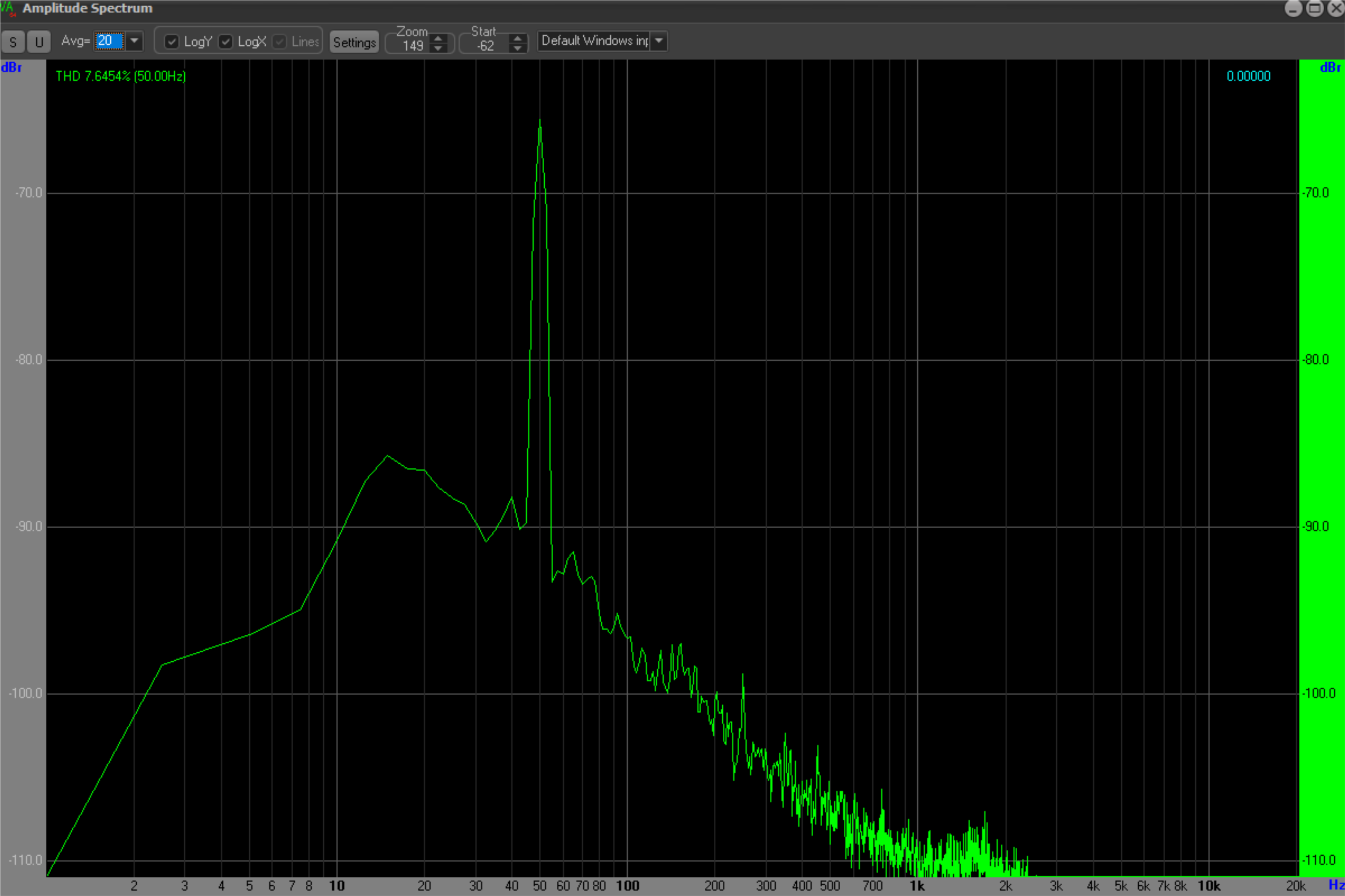

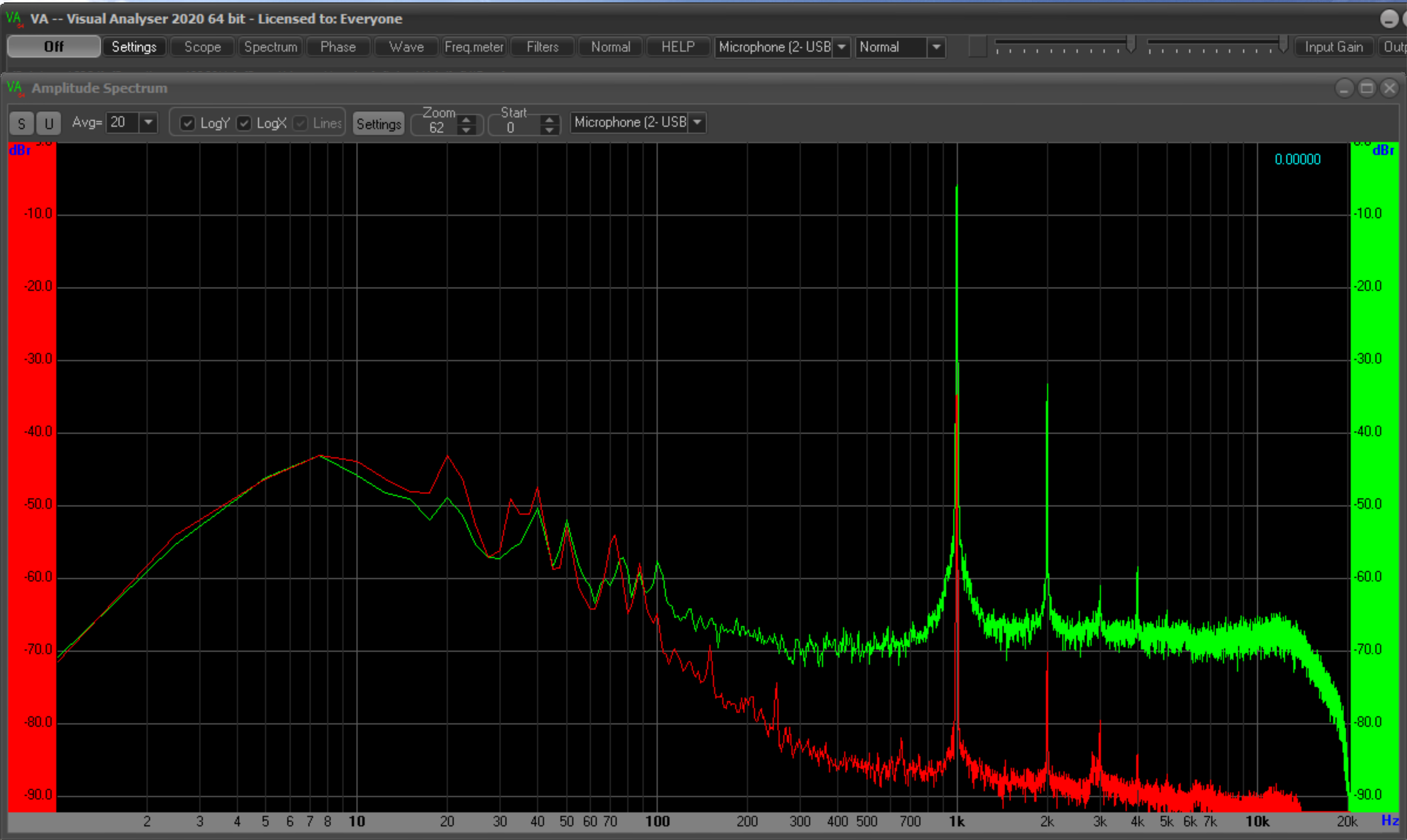

Unfortunately i have found no progress on the 40Hz, yet. the only thing i established is that it is also present when i mount the same cartridge in my conventional pivoted arm, everything else remaining the same, so it is something TT/mounting related. I shall continue to seek it out.
Meanwhile i have worked hard on set up and azimuth adjustment and achieved the attached outputs showing crosstalk from the tone on each channel. It seems very similar, minimum sidebands etc - how does this look in absolute terms?

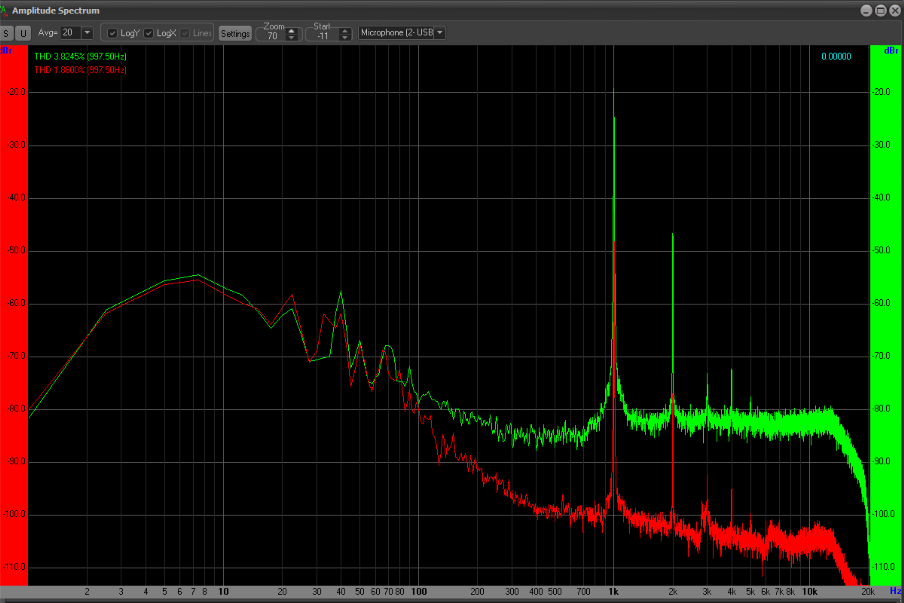

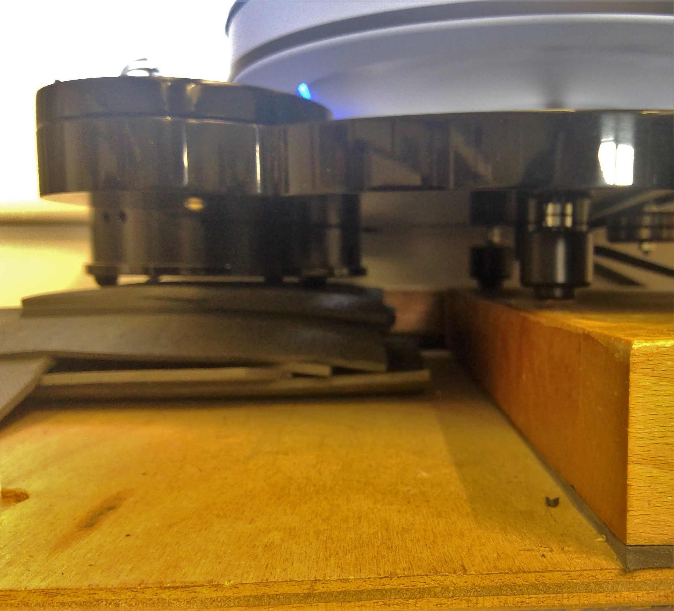

So writing the note above prompted me to do some experiments.
I think a lot is about how i have the motor mounted, i thought it was pretty good on a split beech block plinth on a damped wall shelf.
However, with the belt off, and the stylus on the stationary record simply running the motor showed up some 20 and 40 Hz energy.
The before plots are SS 325 and SS328
After experiments the motor is now sat on a tatty pile of MLV (mass loaded vinyl)
I have the results shown in SS338 and SS 341.
Audibly the low frequency background noise is reduced a touch.

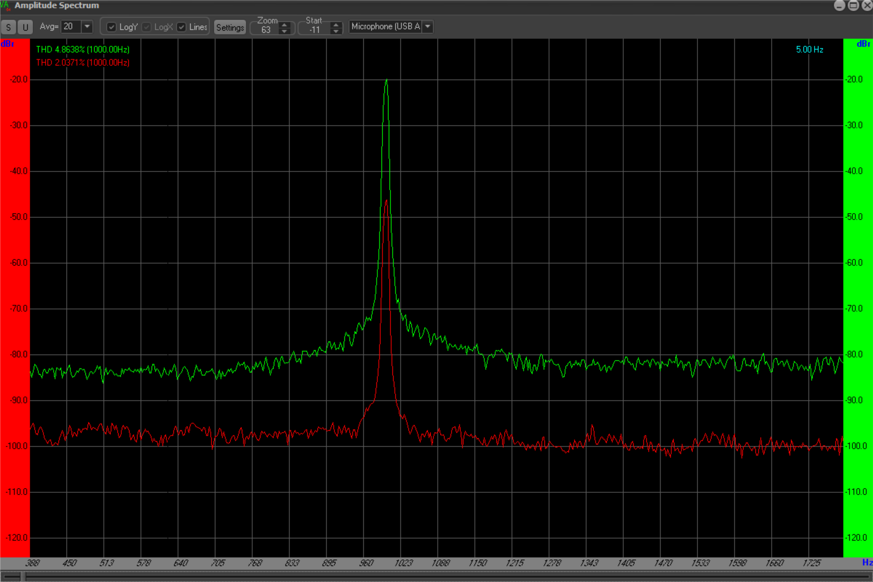

Many thanks for those who persuaded me to understand enough to start measuring things with a ADC and VA, its been very revealing and interesting.
M
M
Folks, i have kept experimenting with this area and achieved only a little progress that you can see in the attached plot.
I would value feedback on whether this looks good, bad or average and any hints about the possible improvements i might seek. Noise floor reductions improve the sound for me a lot so any ideas there also most welcome.
Mike
Hi Mike,
If I were you, I wouldn't worry about 40 Hz. The critical issue here is to find your arm/cartridge resonant frequency. If the arm/cartridge resonant frequency is above 20 Hz, it is problematic. Otherwise, you are fine.
