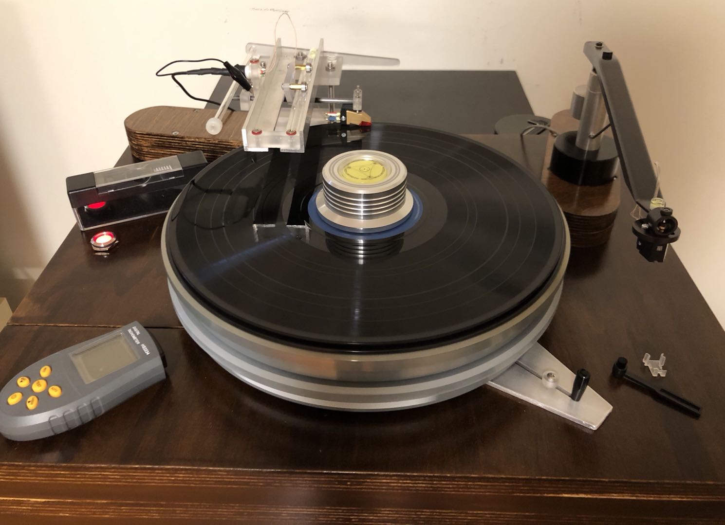

That's a diy ptp on 4mm alu plate.
The motor is serviced, and on a separate island cut out from the main plinth.
RS-A1 is more organic and fluent even though can hardly get balanced.
I am using the SPH long bearing.

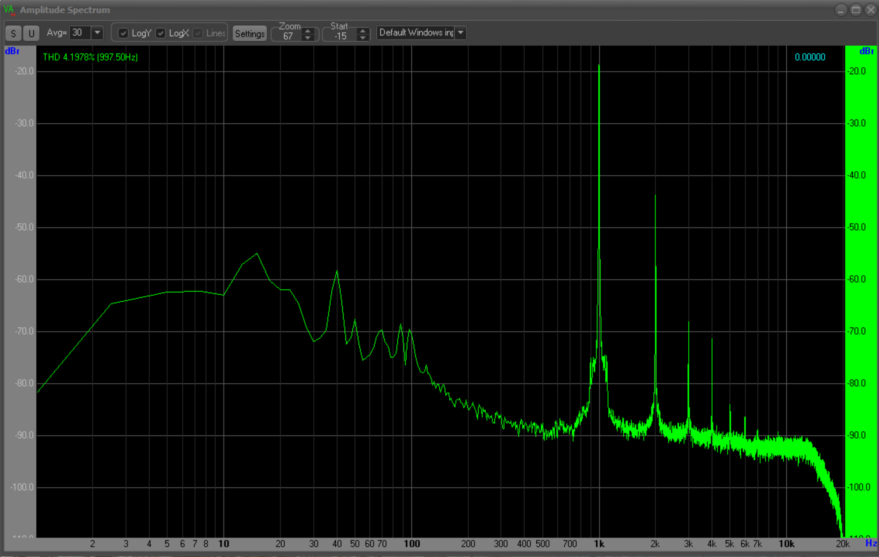

On a quest to improve the performance of my LTA I have been very fortunate to have extremely helpful and very patient advice from a number of knowledgeable folks who follow and write on this thread, enormous thanks to all of you for that.
As a result, i took what was for me a plunge into the unknown and started measuring digitally the output of my TT/TA set up and, with much help, by studying the results critically I have made iterative changes and consequently I have substantially improved its performance both in the measured results and audibly.
I hope some will find it interesting and useful and perhaps give me some feedback.
After listening to those with greater experience and knowledge I consider my TA has a sound technical geometry for a start point. It is a rigid radial rail with a vertical movement mechanism running on it that allows the cartridge to always stay in constant orientation with respect to the groove with fairly constant VTF in warps and little adverse load on the stylus from friction, levers and loads of any type. This should give it a good chance to allow the cartridge to do its job freely and to sound good. I have posted pictures of it on this thread from time to time.
I am listening to the results as I type this up, its sounding good and from the start point it now has notable increases in detail and precision across the frequency range and in separation of individual parts (voice or instruments). Bass is tuneful and background noise is low as others have found with their LTAs.
I did not have a soundcard so i got a Behringer 222 ADC and fed this into the computer to view the spectrum in VA (visual analyser, a free multi-instrument download) so for extraordinarily little expenditure i got some basic tools to help with the developments.
Make no mistake i do not know much about this area but i have learnt a little from the kind advice i have been given.
Please forgive the many areas of poor practice that i am sure more knowledgeable people will spot.

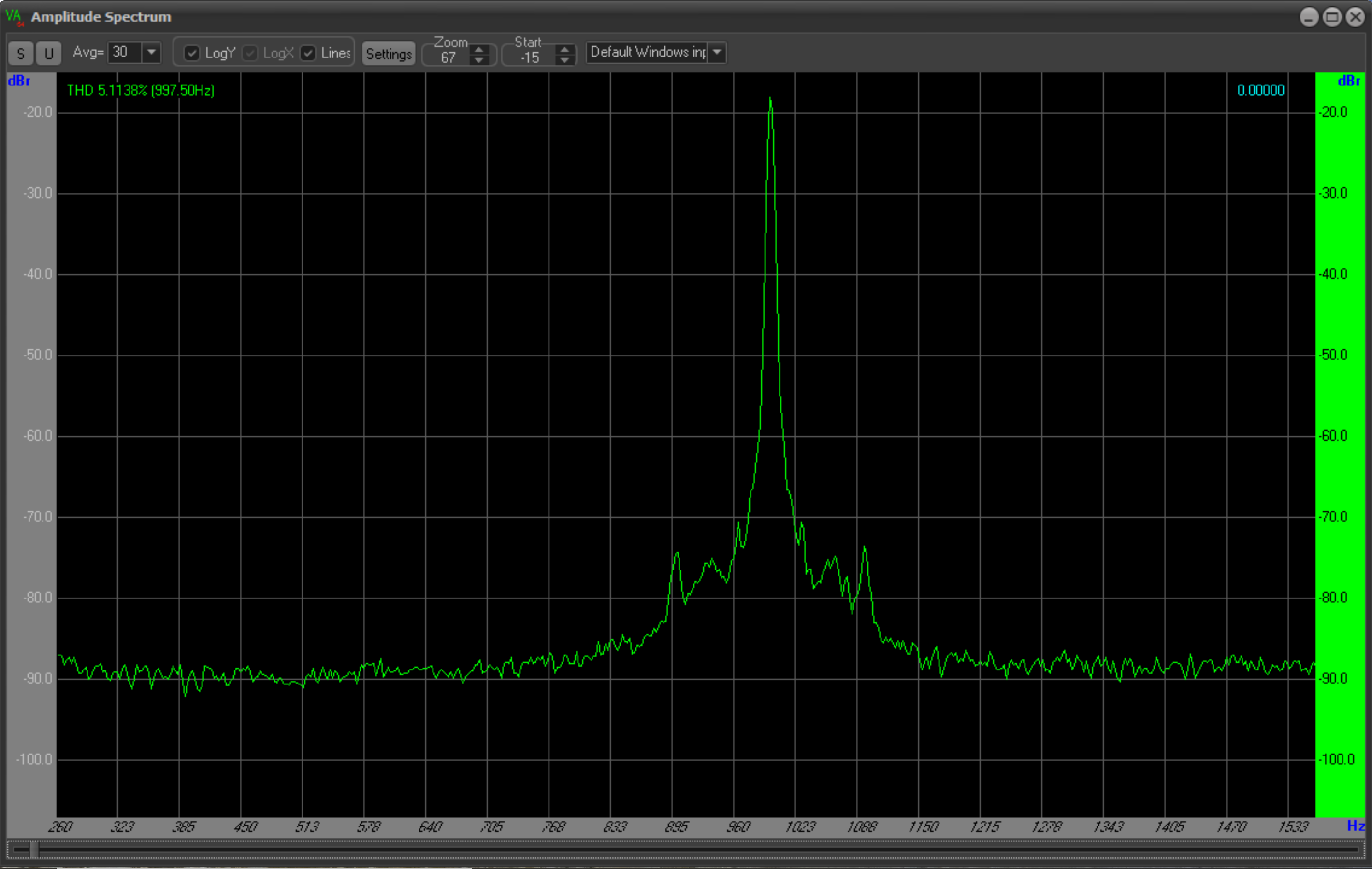

Following this sound advice i explored the tools first to get a grasp of what i was looking at and then focussed on the spectrum analyser view of the output from the 1000Hz test tone from my record.

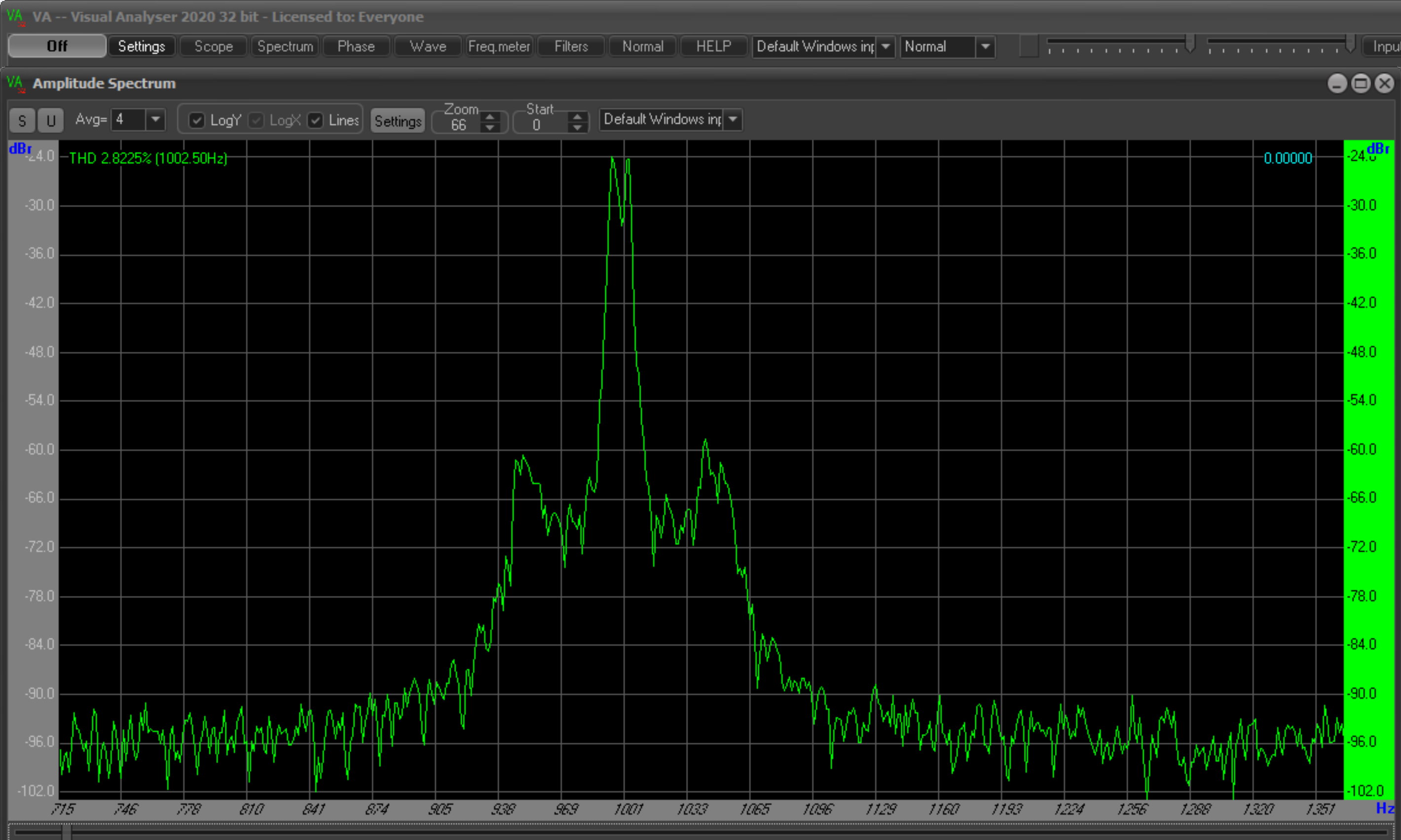

It started out with some large sidebands as you can see in the first image SS 86.
With experimentation and help i found that stiffening up all the cartridge carrier area made a massive difference and other areas followed.
I always changed one thing at a time and measured again so that i could go back to square one more readily and could identify what made the difference.
Sometimes i went backwards and as time went on not surprisingly there were some diminishing returns.

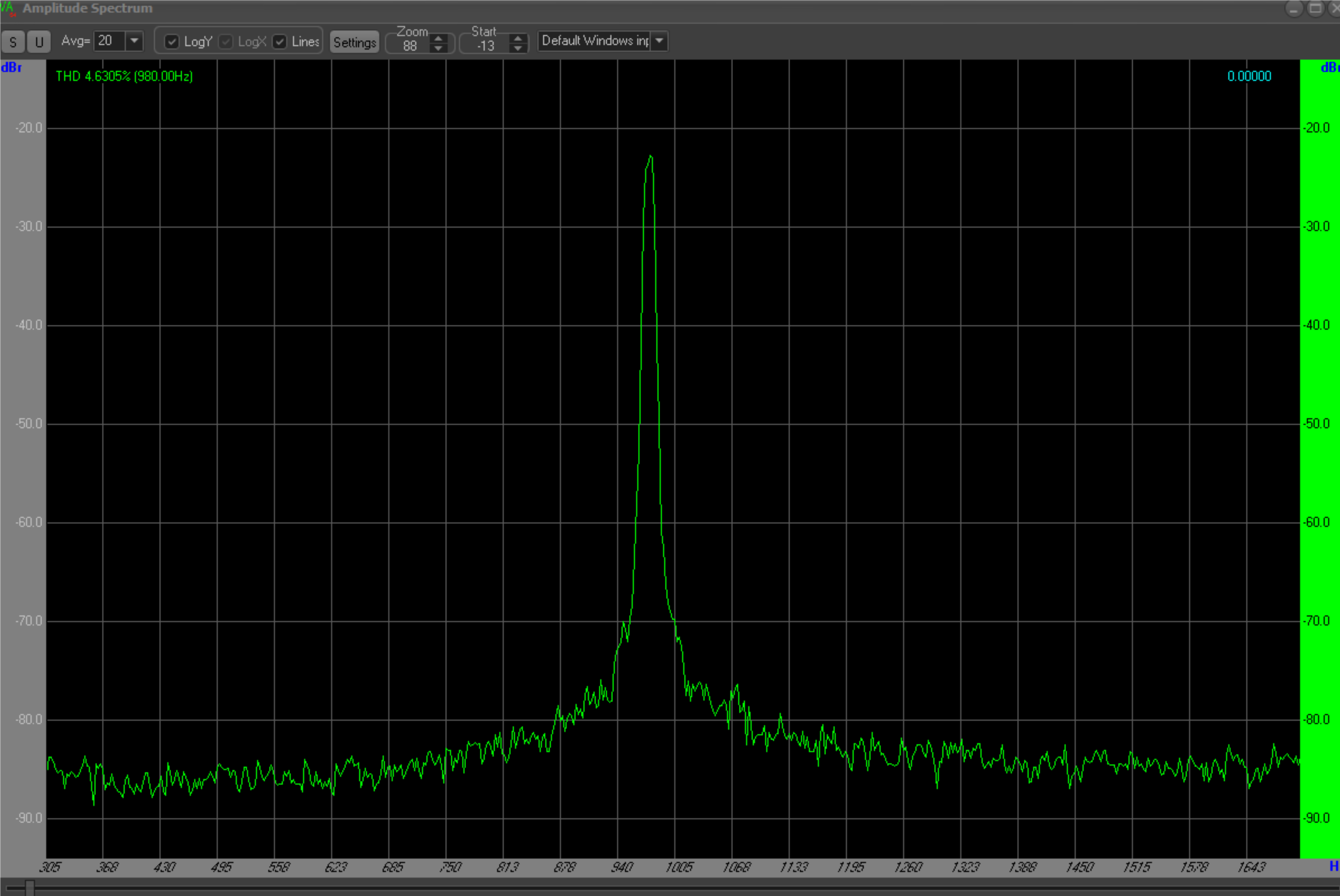

Eventually i reached the point where it measured as in SS 171.
The sidebands were just about 36db below the peak when i started. After the various modifications they are at about 58db down and less pronounced.
After 30 or 40 experiments and changes i feel i have done something about everything that might have micro-rattled or vibrated in any way.
I am still left with something one can see in the wide spectrum of SS 170, it’s a peak at 40Hz and whilst reduced by work on the cue lever and cartridge wiring support its not solved yet.

Have you tried changing platter speed? If that 40Hz moves when you change from 33.33 to 45rpm, it'll indicated platter, bearing, motor.. not necessarily your arm.
Interesting thought Soundblaster, here attached a paper showing thge sequence at 45rpm. if its an effect from the disc through the cartridge surely also that frequency will change?
many thanks for your input, some of those changed in different ways, i am not yet sure how to interpret?
M
I have kept on working on experiments with the arm and find this measuring technique very useful indeed, it saves trying to make purely subjective judgements, here below is the latest measurement, the sidebands are very much reduced, but i am still chasing down that 40hz, although reduced its not gone away.......
However i feel this sounds pretty good now, the difficulty is knowing perhaps how much more is possible, anyone got any thoughts on that please?
