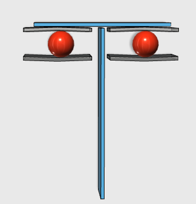

Tx Coolerooney: may work, but how to impede the balls to go everywhere, or outside?

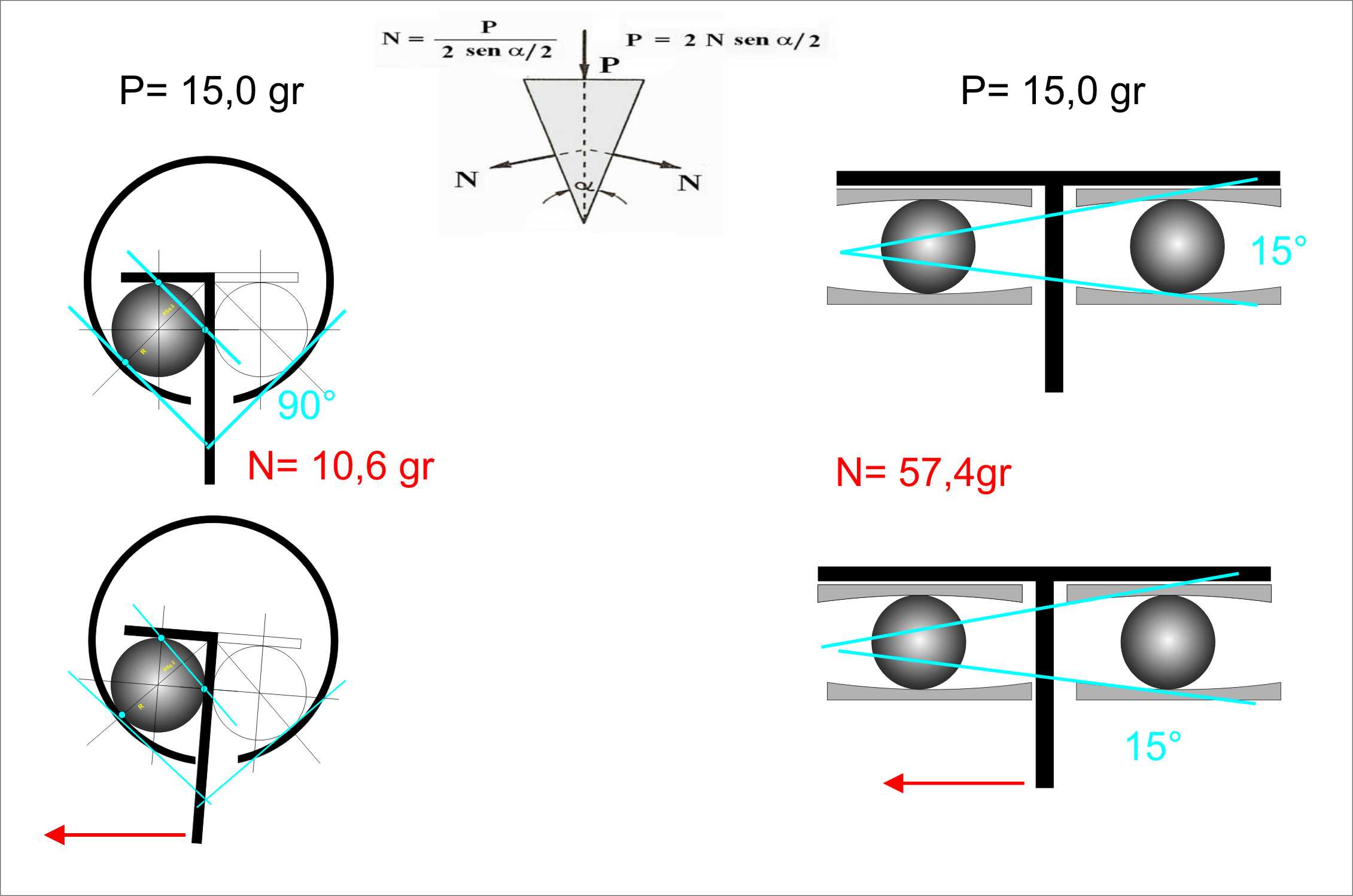

Sorry Coolerooney, I have trouble understanding the CAD, not noticing the small concavity (studied using the slide rule, il tecnigrafo (drafting table?) and Cartesian projections).
Your solution is perfect if the load is only longitudinal, but unfortunately the situation is more complicated, we are also trying to counter act the lateral load of the stylus drag. (Attachment)
In my solution the load N (10.6 gr) is constant, and to rotate laterally the spheres should rub against three points. In yours under side load N may vary from 7,5 to 57.4 gr, and no friction prevents it from sliding sideways.
Then there a bigger problem to overcome, owning just a cheap minilathe: to make such guides are needed an excellent mill and a linear surface grinder, and more to be able to use them well.
