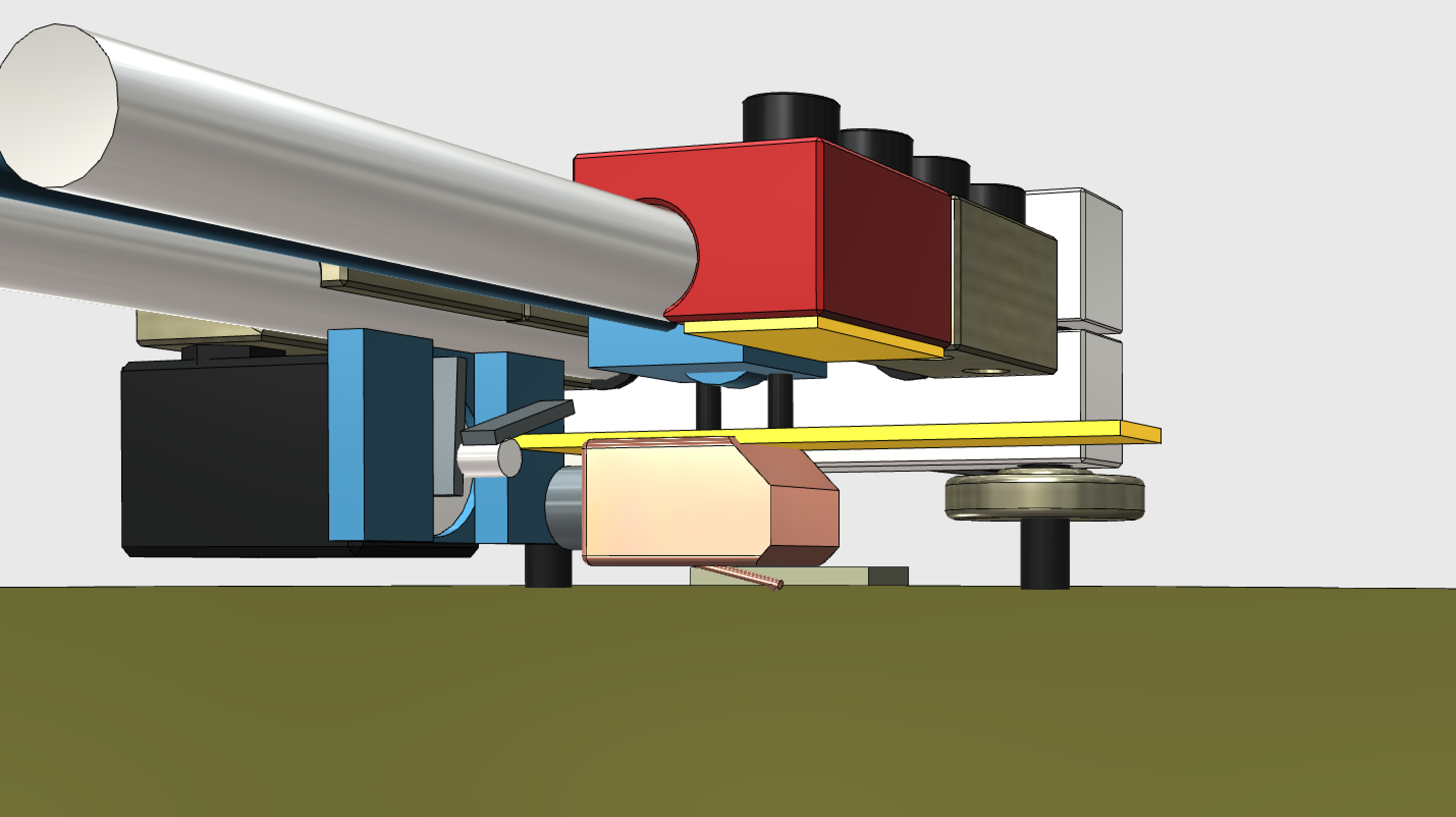

Hi all,
looking for advice- see attached pic
the red block can rotate and needs to be fixed to the cartridge- the yellow plates - there is about 10 mm between them- the stylus center is in line with the shaft center
the lower yellow plate is the "shell" for lack of a better word
considering glueing the upper yellow plate to the red block
the red block weighs 17 grams+the bolts, but can be made of plastic-don't like M6 holes staring at me, prefer the symmetry
the big green area is the platter
the black box is the stepper for the lift off
question: what is the best place to make the mechanical linkage and what place, shape
a bit of aluminium box, carbon fiber etc, foam
appreciate the help- don't be kind😛
coolerooney

Sorry Coolerooney but I can't work out how the arm works at all from the picture. I assume that the red block is the lateral bearing. You say it can rotate, does this mean that it is involved in vertical articulation as well? How is vertical articulation actually achieved? How or is the lower yellow shell connected to the upper yellow piece / red block? Why does the yellow shell extend so far in front of the cartridge? What are all the blue bits? Are they to do with the sensor for the servo?
Maybe show some simpler plan and elevation diagrams of the principle rather than the finished item.
Sorry for so many questions but unless I fully understand the design I cannot honestly offer advice.
Niffy
