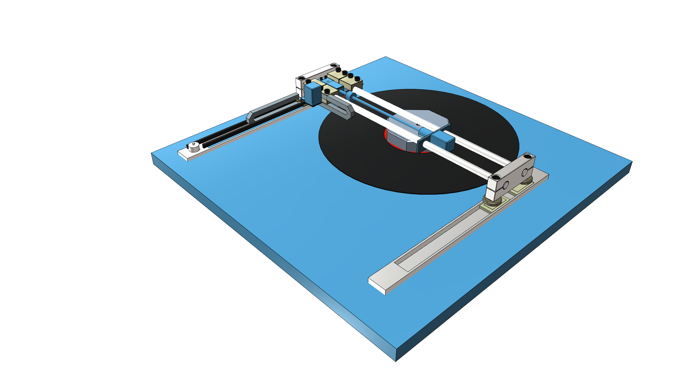

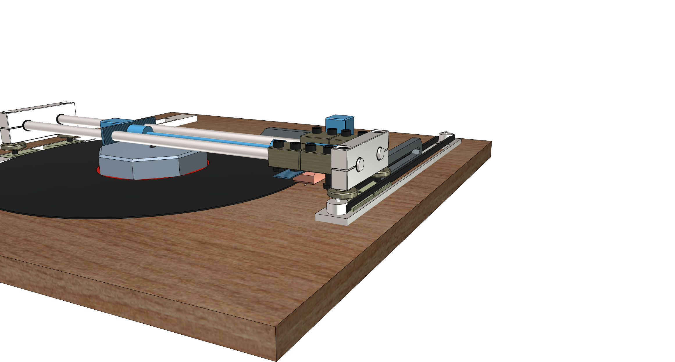

Just a quick pic the entire assembly moves backwards for record change - motorized with a Core XY layout- not shown - like an Etch a Sketch
The four blocks on the right (Pic 2) are the carriage- 2 straddle the nut that is connected to the threaded spindle 1 block carries the cartridge and is the only one that can rotate (a bit) the other one behind it carries the stepper for the needle up/down
The 2 right most bearing blocks are not physically connected to the cartridge bearing block, it gets pushed
The stepper will take about 20,5 million steps for a 10 cm, 200gpi record track (17k steps/sec)
Each step will move the cartridge 0,0000048 mm

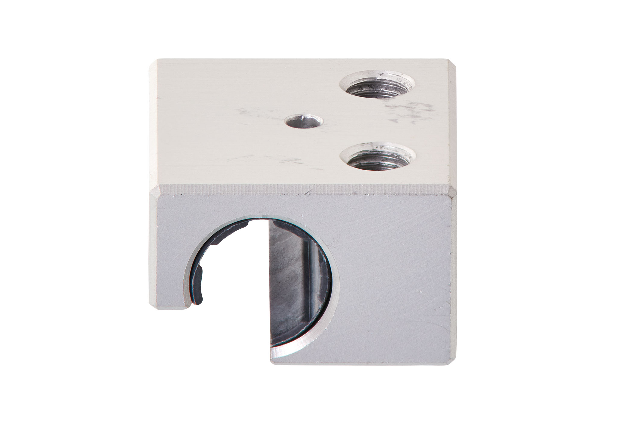

I use standard Igus parts where I can, for speed of construction, but also for size stability- with these tight tolerances it is easy to screw it up
Shafts are 10 mm dia tubes, carry wires
Other cabling is managed by "energy chains" the little plastic ladders
By minimizing record warping, the requirements on the radial bearing and the cartridge compliance are reduced- alleviating this TA design issue
I am taking some cues of the AVDesignhaus Dereneville, a 40k arm, but on a shoestring budget, nevertheless there are some areas of improvement
Coolerooney

Nice model, Coolerooney; just one doubt: how will you manage vertical movements? It's the main problem of a radial rail

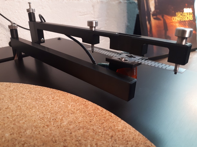

On the pic- found this on a Kickstarter project, interesting way of dealing with height variances independent of the arm

Hi Coolerooney, LP issues can be limited with proper storage (much easier and cheaper than all the devilries such as vacuum pumps, self-centering spindles, bearing-breaking weights) but can not be eliminated, because they will always be much wider than a groove pitch. So we have to accept and manage them with skill and simplicity (surely you know Herr Altmann ...), that's the game.
Back to us: if your " block that carries the cartridge" can tilt, it is not travelling on a radial rail; maybe something close to the Revox arm, deceased long ago: not leaving many regrets.
But excuse me: if you use a servo to overcome the friction of the carriage what's the need of a radial rail, or an ultra-short arm? It's the servo, not the arm that pushes the carriage.
Radial rail overcomes just one problem of linears (the torque on the carriage) introducing others of difficult solution: it is only an experiment, a constructive challenge to bring forward.

Not sure on the definition of “radial rail” my carriage runs over a round shaft, so that the cartridge carrying block can accomodate some height variances- as stated, need to keep these low, otherwise the concept fails
Following your drawings, your bearings runs inside the tube-right?

Love to see some pics in it
I've called “radial rail” a rail simply superimposed on a radius. (not so creative definition, Lil Casey was born to make a new (?) radial rail T.A. , not for the round section rail it uses). Linear trackers instead use chords, tangents or even lines outside the circumference for an easier disk changing.
Unfortunately my LPs are all under Riaa standards: eccentricity <1,27 mm. Never seen a similar disaster, never seen a perfectly centered disk

Hi Coolerooney,
Were you planning on using a mechanism for vertical articulation like that shown in #2629? To me this looks like really bad idea. This design has the cartridge mounted in the middle of what is basically a leaf spring. Resonance nightmare. Tracking force would also vary greatly with only a small change in record surface height. Even with a record that is flattened as much as possible with clamps/vacuum you will still have a small amount of "warp" due to slight variation in the thickness of the record. You also have to accommodate the overall thickness variation between different records, say between 150g and 180g pressings. Could you show a more detailed view of the vertical articulation mechanism?
What were you planning on using for the linear bearings? Although bearing friction is not an issue for a servo controlled arm bearing chatter is. Linear ball race bearings are not going to be ideal for this reason.
How are you isolating the stepped motor from the carriage? Motor noise can easily undo any advantages the servo may give.
Niffy
Niffy
Ok guys,
No I am not going to use this, I thought it was nice try

On the vertical articulation required for varying thickness of records- I am playing with the concept of auto bed leveling used in 3d printing, which is a bit of a snag for me, as my platter is to be a “floater”, so move the arm instead, —hmmm-not there yet as it would require a subassembly, motors, drivers etc.
Pumping liquids is also possible, but not elegant
In the carriage the Igus bearing block is used, normally this is a part of a 4 bearing sleigh of the W linear rail system-with polymer dry bearing- see pic- the weight of the zinc alloy block is 17 grams, am using the aluminium-aluminum block
In this design the blocks run on an Igus R type rail and end blocks, the whole arm assembly slides on N type rails
More: https://www.igus.com/drylin/profile-rail-guide
The cartridge will be attached to the block, which can also rotate. Small height differentials would compress the cantilever, bigger ones rotate the cartridge, (compromising VTA) but as mentioned before, intend to deal with this separately. A longer arm would make this less critical -I know
Stepper isolation
1-use SilentStepSticks- as described in previous posts
2- the cartridge carrying block is detached from the pushing blocks (which are connected to the spindle)-but still in contact- optional is a pull back of the pusher after each push, but there are too many pulses
3-magnetic coupling on the drive spindle (away from the cartridge)
4- optional- put the horse behind the carriage i.e. pull the cartridge block instead of pushing and use a silk thread between them as connection- when the carriage is returned to home position it is pushed. Think this one is better and more elegant
My 2 cents for the day, look forward to your remarks on my Noob-ness
