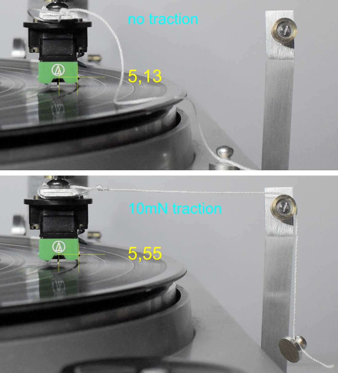

Bending test with 1 gr SF traction
More difficult than expected, Niffy, because these small digicameras decide by themselves where to focus (the base of the arm, damn idiot) and cheating them is not easy.
As predicted, with the right VTF the traction of 1 gram brings skipping, and therefore nothing could be measured: only with 4.5 gr. VTF it was possible, but bending was visibly reduced due the elastomer too crushed upwards. It should also be noted that the traction is a bit less than 1gr, for the pulley friction.
Practically identical results for two original AT95 styli, one new the other quite used
The results are in the picture: bending 0.37 mm ca = 3.5 ° degrees. Calculations with static compliance would give instead 10mN * 20 = 0.2mm = 1.9° degrees - with the dynamic compliance 10mN * 6.5 = 0.065mm = 0.62° degrees.
This seem to confirm the measurements on the video for Lil Casey, different in the same way from calculations: 1,41mN * 20 = 0,028 mm bending calculated, half of 0.065 observed on video

Hi Carlo,
Neat experiment. It must have been a pig to get lined up and in focus. I'm not sure you've taken the measurements correctly, it was a small deflection relative to the size of the photo and didn't look as much as 0.37mm to me. I downloaded the photos and blew them up so that the front face of the stylus body was 100mm across. I set a 100mm wide box aligned with the stylus body. I set a second box aligned with the right hand side of the first box and with its left hand side aligned with the center of the stylus. The second box in the photo with no traction was 50.4mm wide. With the 10mN of traction it was 52.4mm wide. A difference of 2mm. I think these measurements are accurate to +/-0.2mm. If I assume that the front face of the stylus body is 10mm wide this would indicate that the stylus was deflected by only 0.2mm and not the 0.37mm you measured. Could you please measure the actual width of the stylus body for me as I couldn't find it in any specs. I had to estimate the 10mm from measuring a photograph of the underside of an at95e and comparing the distance between the bolt holes to the stylus body's width. A 0.2mm deflection would be consistent with a compliance of 20um/mN which would mean that the dynamic and static compliances are the same. If anyone else would like to check it would be useful to have a third pair of eyes on this. If the deflection really is only 0.2mm then it would suggest that my calculations for tracking errors are reasonably accurate. I took great care when measuring as I want to be as honest with myself, and you, as possible and to avoid any confirmation bias. You don't learn anything going down that path.
