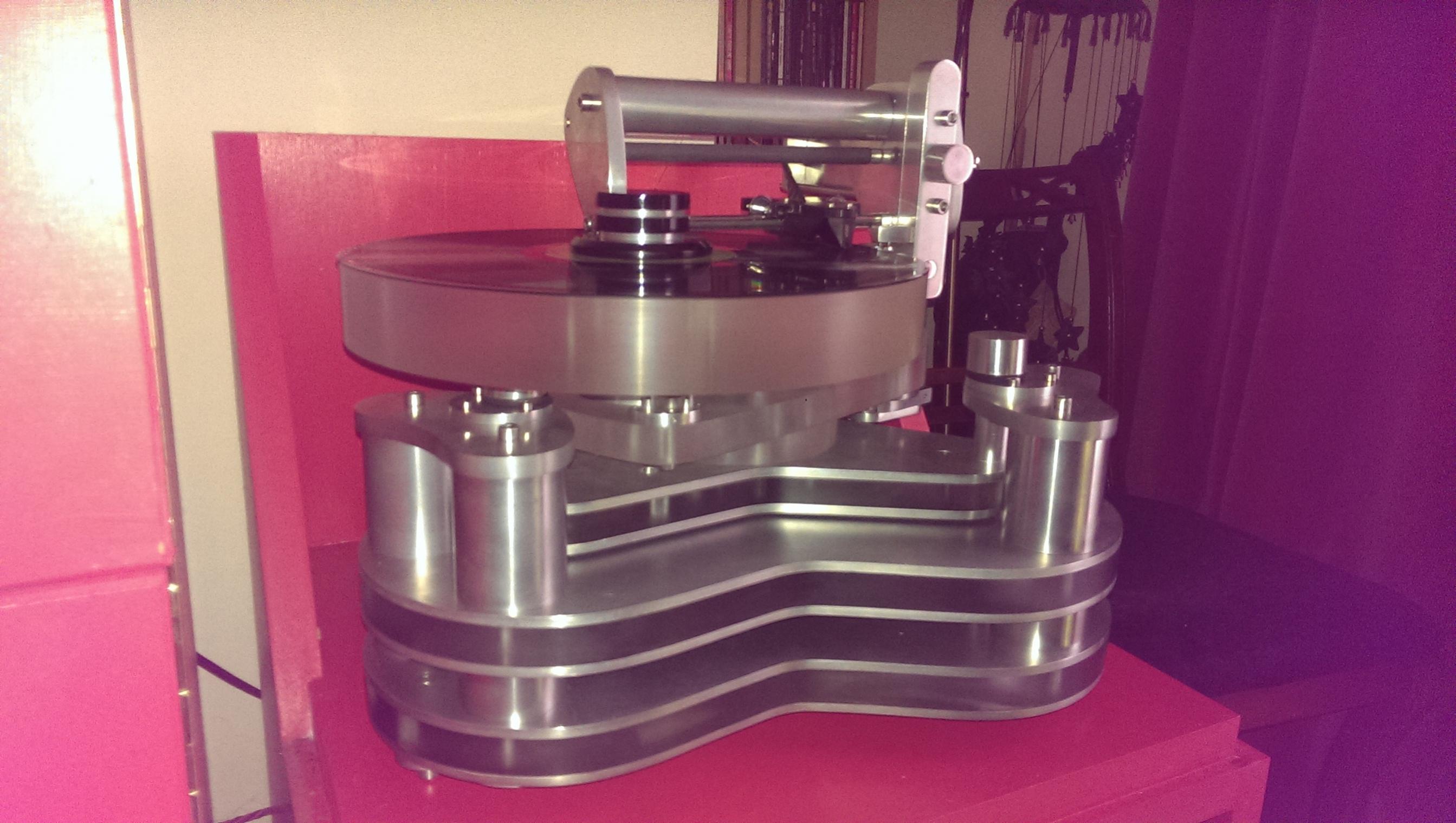

Niffy, thank you for stiction explanation. Is it still present in your arm? What are numbers, compared to friction?
What a monster of turntable (in a good sense) of yours! And it is rather a compact one...

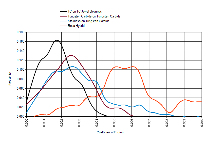

Hi walterwalter,
All mechanical bearings will have some level of static friction (stiction) so it is still present in my arm. I only measured static friction as this is always greater than dynamic (moving) friction. If you are going to have a problem with friction it will be with static friction.
All bearings exhibit some degree of variation in the level of friction as they rotate. For this reason I took many separate measurements of the bearings, rotating the wheels slightly between each. I measured for movement both to the left and right. In total I took about 300 separate measurements for each type of bearing tested.
I then plotted all of these in a graph that showed the coefficient of friction against the probability of that friction occuring. A lower friction would show towards the left of the graph. A more consistent bearing that showed less variation would produce a narrower taller peak. The area under each plot is the same and adds up to a probability of one.
The graph at the bottom of this post shows the friction of 4 of the bearings I tested.
They are for my current bearings that are jewelled bearings with tungsten carbide wheels running on tungsten carbide rails.
Tungsten carbide wheels on tungsten carbide rails with my home made steel pin bearings.
Stainless Steel wheels on tungsten carbide rails with my home made pin bearings.
Finally there is boca hybrid ball race bearings on borosilicate glass rails. The boca hybrids are very high quality ball race bearings, about as good as this type of bearing gets.
The all jewelled and tungsten carbide bearings are clearly the best. The average coefficient of friction for this bearing is 0.00174 which with my carriage equates to a force of 0.931mN (0.095g). The mode, which is the most common and is where the peek on the graph is, has a coefficient of friction of 0.00157. With my carriage this is 0.843mN (0.086g). With my 22um/mN cartridge and a 0.931mN side force would cause a tracking error of about 0.23°, this only occurs momentarily just before the carriage starts moving. (less than the average skating error of a 9"pivoted arm, this happens all the time)
It is interesting to note that the ballrace bearings have a double peek in the graph. These bearings have 6 or 7 balls, can't remember of the top of my head. The lower peek seemed to be where there was a single ball at the bottom of the race and the higher when there where two. These bearings are designed for high speed use where this variation would not be a problem. The problem is only apparent with very slow stop-start motion. This effect was much more pronounced with lower quality bearings, not shown in this graph.

Really precious infos, Niffy. I can not download the chart but I've seen some for the ball race bearings that resemble the behavior of my tests: an initial friction drop and then a non-linear slowdown.
The coefficients found for non recirculating are about 0,002, that with my cart of 14,5 grams give 0,290 mN. I have found half of it, which is incredibly low: so I think that with your jewells that are surely better the carriage weight must have much less influence than calculated with coefficients.
That measure may be of course a reading or calc mistake, but even that the 4 balls are not in contact each other, while normally there are many more and crawl between them, or on the cage.
