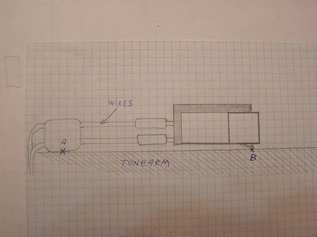

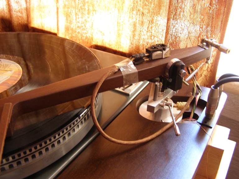

Niffy, I do have a question, as to bearing noises. For motor, platter bearing, as well as idler drive, I can clearly hear the noise, both directly with stethoscope and through the speakers. As to tonearm bearing, I'm unable to hear any kind of chatter, as well, as other noises (other than those, coming from the motor and drive)... What is your opinion of how chatter influence on sound happens, and how to detect it?
Picture shoves, how I tried to detect the arm bearing noise. Cartridge, placed directly on the arm with stylus in contact with the arm body near the horizontal bearings. Cables go into the phonostage.
Sorry, the arm is not linear.
Walter
Walter

I don't think your test set up is likely to reveal much. A phono cartridge works due to the relative motion between the stylus and cartridge body. In your set up both the stylus and cartridge are held stationery relative to the armtube. If it did reveal anything it would be how much the cartridge/arm is moving relative to the groove. If you could place the stylus directly against the bearing you might pick up something.
As long as it's DIY it doesn't matter if it's linear.
Niffy

Niffy, thank you for detailed reply. As to my experiment with the cartridge, as tonearm parasitic sound sensor, it is rather encouraging. My first attempt was with a small microphone, and it happened not having enough sensitivity to detect any arm vibrations at all. Phono cartridge is a much better sensor, if placed properly. In my case, it has only two points of support: A made of four flexible wires, and B the stylus, cartridge acts as kind of effective mass, together with wires it makes tonearm-like arrangement, so the stylus able to detect tonearm body vibrations, further amplified by phonostage. Actually, I tried to hear, how the arm body resonates and sounds to make up my own opinion. In my case, wooden arm body has it's own sound, but it is of so miniscule level, that should be completely disregarded.

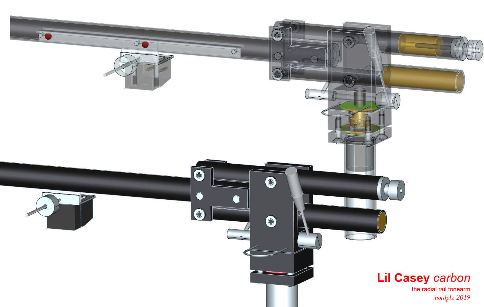

radial rail tonearm - carbon
I am slowly redesigning, simplifying the first Lil Casey, looking for a compact and easier to build solution. I have kept what showed to work well (non recirculating balls carriage - rotatable leveling base - lifter - CW regulation) trying to improve the rest (weight of vertical masses - vertical articulation - bearings). That's why a Ø12 mm carbonfibre tube, that should reduce the vertical mass to 25 gr ca: an acceptable value, similar to the horizontal one (< 20gr).
In addition to weight, the major revision relates to the parallelogram: the slanted version, that gave no real advantage, is substituted by a straight one with the rail between the levers to get the same couple on upper - lower bearings.
Bearings become pen-tips type, hoping to reduce the friction significantly. Unfortunately still couldn't get 4 pairs of jewel bearings without opening first a watch factory.
As usual my design refers to my tools, my skills, and materials I can find. I'm not saying it's a tonearm for newbies but needs only patience, accuracy. and simple tools (no lathe)
Sorry, no fancy tech.
carlo
Any advice?
carlo
Any advice?

Thanks for links, Niffy. Finally something useful, even if I'd like to find the springed version V bearings with their pivots. Banggood, Aliexpress and some sites of Swiss and American producers seem all B2B oriented.
Now a friend told me about a repairer of industrial clocks here in the area, so I'll try first to hear him.
Hoping to avoid tilts, I've made some tests of carriages on a square section, but without satisfactory results without greatly increasing the base, and therefore the overall weight. Add to this that square tubes in carbon > 8x8 are almost unavaible, and I'm back to the round solution, already tested.
Hope the carbon tube could be sufficiently straight, hard and smooth for the task. Unlike you I have no experience with carbon (just used for the arm wand)
