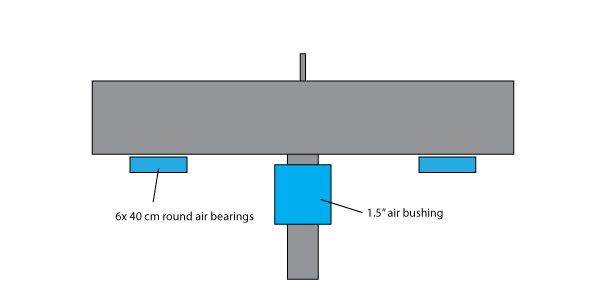

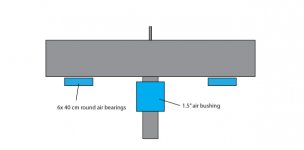

My ideal table is air bearing table. Please see the drawing. I have all the air bearings, but since the project involves too much with mechanic parts and additional air supply, etc. I think it is beyond my capacity.
Welcome in the air bearing TT club.
Good idea.
I wish you perseverance in realizing your musical dream ....
Music on a heavenly cloud ... super.
My experience ... I like (& build) TT air bearing (& TA)
Karel
