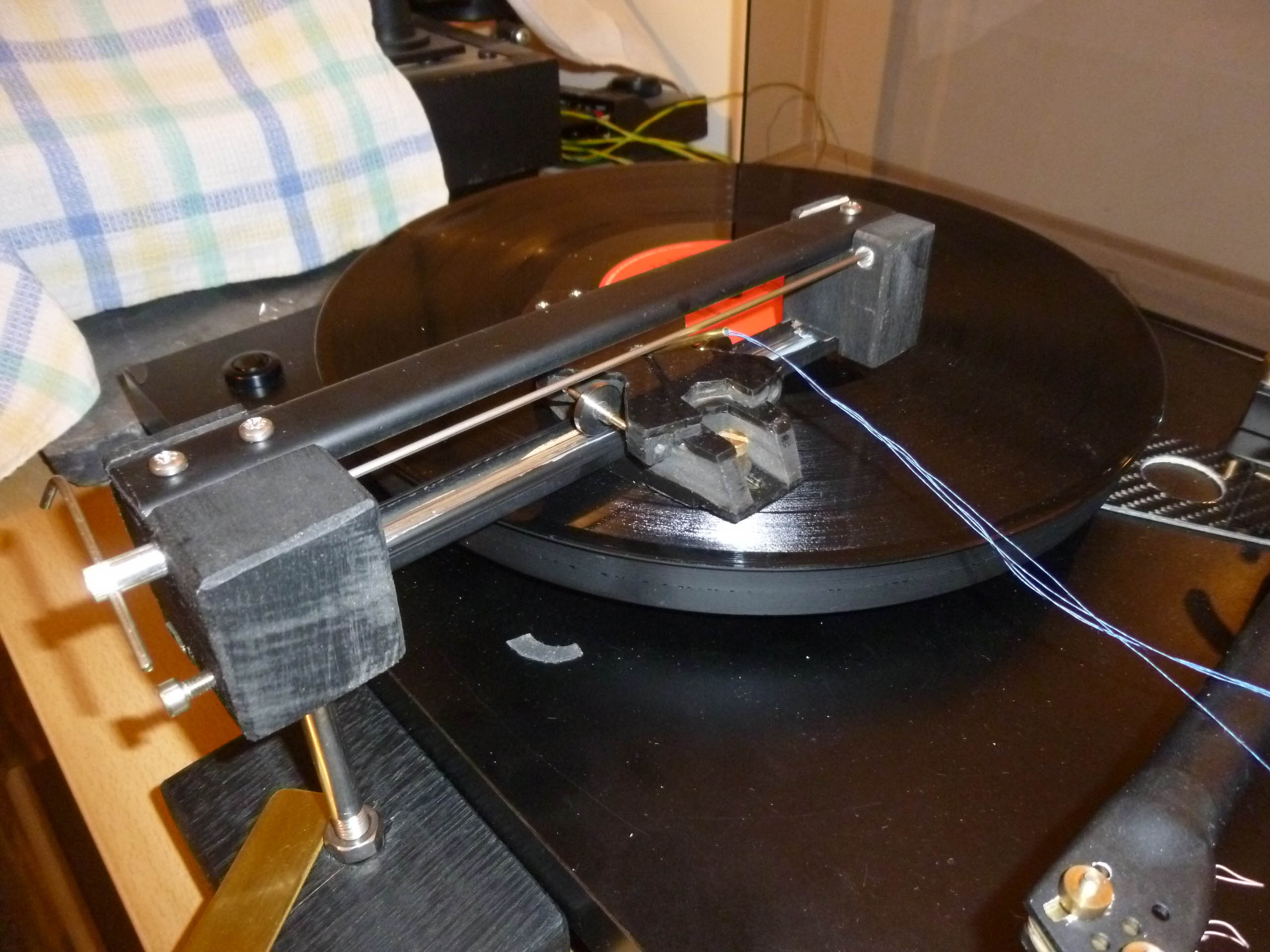

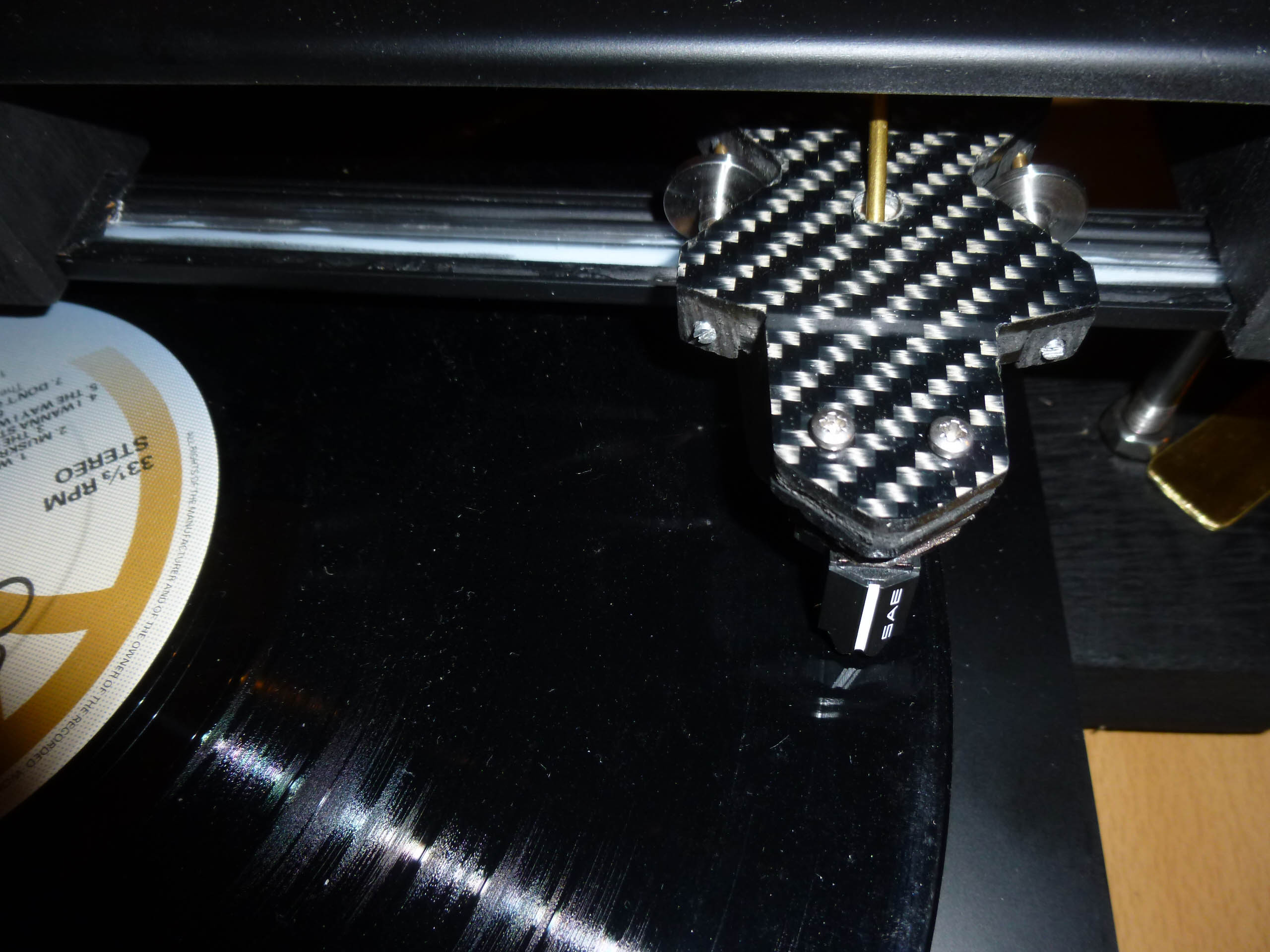

...... Being the owner of ‘my version’ of Tom's Floater (it is truly amazing), I enjoyed reading the comments between Tom & Niffy I couldn't keep up fully with either of them re. resonance however, I still enjoy making other’s designs
I am now at the final tuning stage, temp. fixed on my modified 'Old' Rega Planer 3, alongside my Roksan Tabriz 'Z'
I have not yet made a direct comparison to any other arm but, I do like this one very much.
You can see from the pics. that I have used the Pin Bearing approach, which is working perfectly on 4mm glass.

Hi Geoff,
Nice looking arm, looks kinda familiar.
A couple of questions. Well more than a couple.
What is the total mass including cartridge?
What thickness of carbon fibre sheet did you use? It looks thicker than the 0.75mm I used. I notice that you have aligned the outer weave at 0/90°, I had my carbon fibre specially laid up with the surface at +/-45° and the inner at 0°. It's slightly counterintuitive but the +/-45° layup is actually significantly more rigid longitudinally and torsionally than 0/90°.
Did you use balsa cores and if so did you use it end grain?
How are the cables exited?
What are you using for bearings? Are they jewelled?
How is the rail moved to facilitate record changing?
Most importantly how does it sound?

Hi Niffy,
From the top then ......
Total mass fairly heavy, just short of 60gms.
The c/f was leftover from the garage junk bin @ 1.5mm
Balsa core end grain used, each layer @ 90deg

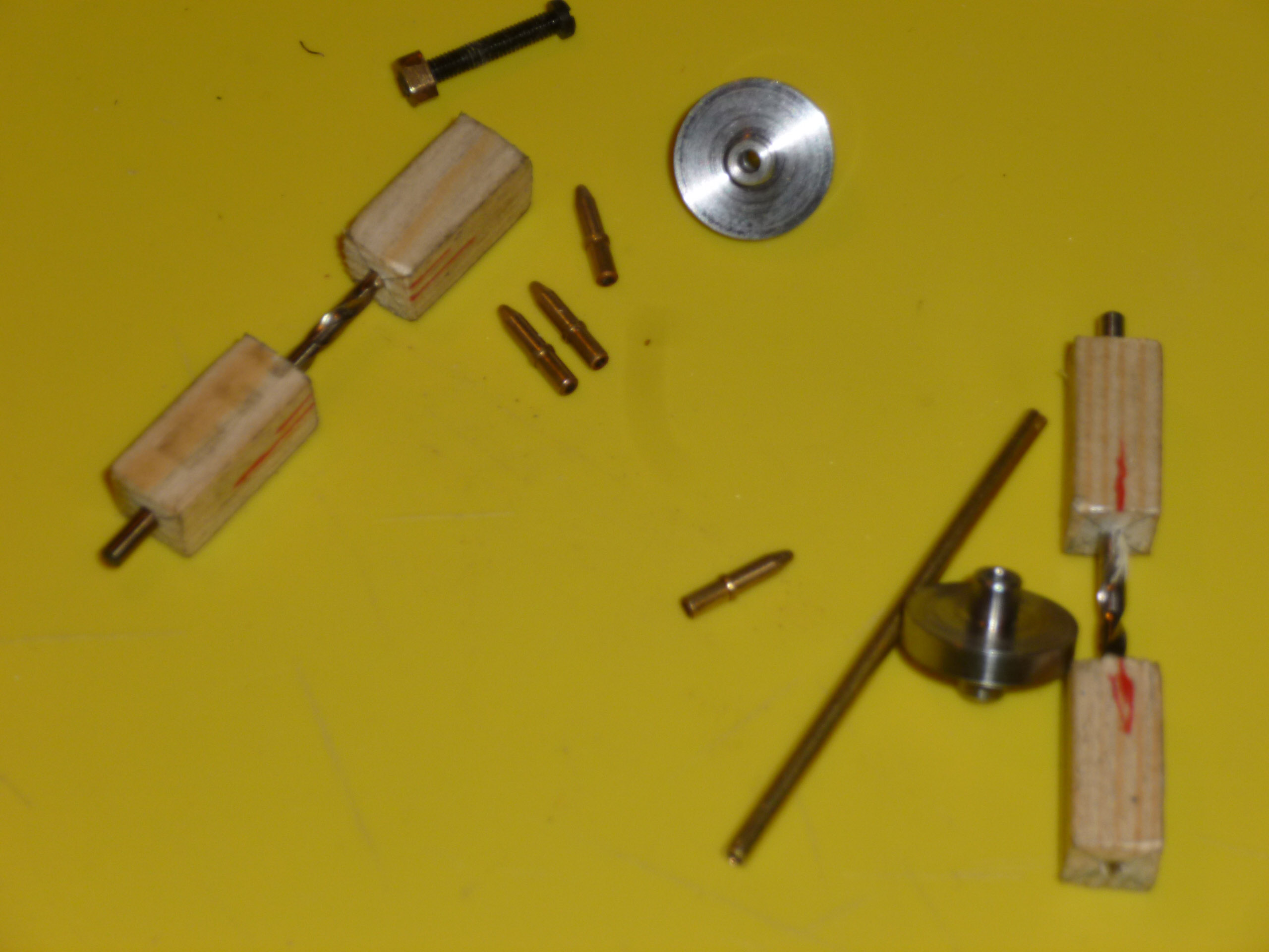

As I have it mounted temporary on my Rega, the wiring comes out of the brass tube & terminates direct into my Phono RCA's. The wires laying over the Tabriz Z arm
Bearings cheap & cheerful - Stainless wheels; Ally with only small countersink [no jewel]; & Ballpoint Pen tips. I accept your advice re marked difference in sound with the jewels etc. but for me it is working very well so far & it was Very cheap
The Stealth as is - mounted in place using a couple of clips I made; so just remove clips & the whole unit moves to the side ..... Simples! I havn't decided how to mount it to my main system yet so I don't need to use the 4mm screw which contacts on keyway of shaft
& the big question - How does it sound? Very pleased with the results, it's big test to come when I get the chance to compare it with Tom's 'Floater'

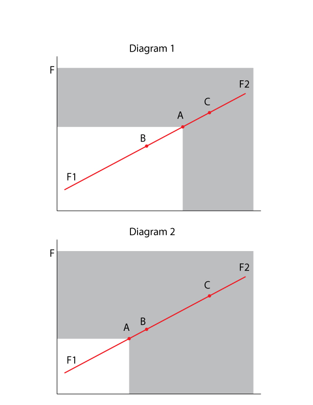

All the opinions I am going to explain are only referring to linear tracking arms.
In order to express my view effectively, I did a diagram. Let's assume the force to pull the cartridge inward is F. I also assume that F is the function of many factors. So I get line F1 F2. The pulling force keeps increasing and finally it pulls the arm carriage towards the center of record. On the diagram, at point A the pulling force is equal to the friction of arm carriage. The friction is a function of many factors including mass, so I don't need to deal with mass here. At A, the carriage won't move. Above A in the gray shadow area, the pulling force is stronger than friction. So, the arm carriage moves. Under point A, the pulling force is smaller than friction, so the arm carriage doesn’t move.
Now, let’s examine the swing head shell. Let’s assume that the springs start to engage at C. The springs have too low compliance. In other word, it is too strong and useless because the arm carriage is already moving.
If the springs start to engage at point B, the head shell will NOT be tangent to the groove. The springs are engaged by the pulling force F before the arm carriage starts to move. Tracking errors will occur. The cantilever will be stressed.
However, the worst is not over yet. As we all know that cartridge is a mechanic device. The constant vibration of two springs will transmit to the head shell. I believe such vibration will generate a signal at certain frequencies. These frequencies will add on the vibration of cantilever. It is another kind of stress on cantilever. It will add and distort the information in the grooves. I don’t have experiment to prove my view, but it is very possible.
I said as long as you can reduce the friction. You don’t need swing head shell. Let’s see the diagram 2. Point A is now under the point B. It means friction is low and small pulling force will move the carriage. It also means that the pulling force which is equal to friction is under the point at which the springs start to engage. So, the springs are useless. It will only generate unwanted frequencies.
My conclusion is swing head shell is a bad idea beside it comprises the integrity of arm structure.
As I said earlier, I did NOT know there were springs on both sides of the headshell. I found out only AFTER I posted the videos. I agree that using springs is probably not a good idea and the video demonstrates the awkward stuttering movement of the carriage. But my question was referring to why having extra pivot would stress the cantilever when some members here think, as Niffy pointed out, that "allowing the armtube a bit of rotation can help to keep the cantilever more tangential" at the expense of structural integrity.
