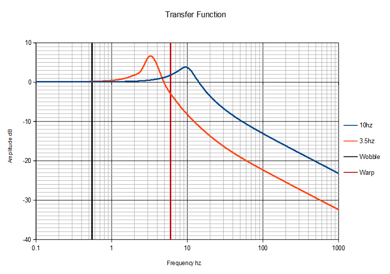

A while back I made a rather lengthy set of posts talking about effective mass and how it helps to control the cartridge. It the second post I included a graph that showed how much the cartridge body moves relative to groove modulation at different frequencies. I have reposted this graph below.
The vertical axis is in decibels. This means that at -10dB the cartridge body moves 1/10 the amount of groove modulation and at -20dB the cartridge moves 1/100 the groove modulation.
Eg if you have a 500hz groove modulation with an amplitude of 50um at - 20dB the cartridge body will vibrate also at 500hz with an amplitude of 0.5um. (but out of phase with the groove)
A pretty typical cartridge was used as a model for the creation of the graph. It has a compliance of 15um/mN and the suspension has a coefficient of 0.5. No additional damping of the arm is included.
The blue plot shows this cartridge attached to an arm with a total effective mass is 16.9grams. This results in a compliance resonance of 10hz which is normally recommended as an ideal.
The Orange plot shows the same cartridge attached to an arm with a total effective mass of 138grams. This results in a compliance resonance of 3.5hz.
The most obvious feature is that the Orange plot is over 9dB below the blue plot within the audio band, above 20hz. This indicates that, with the Orange plot, the cartridge body is moving only 1/8.3 times as much as with the blue plot. Having the cartridge held much more solidly like this is why the higher lateral mass linear arms can have such superior bass reproduction.
The vertical black line on the graph is at 0.55hz which corresponds with the lateral frequency due to eccentricity at 33 1/3rpm. The plots for both the 16.9g(blue) and 138g(Orange) arms are both very close to zero at this frequency. The blue is lower at +0.011dB than the Orange at +0.090dB. Neither are anywhere near to being resonant or capable of exciting oscillations.
The red vertical line at 6hz represents the upper frequency limit at which significant record warps occur with a 33 1/3rpm record. Warps occur at frequencies between the black and red lines. Higher amplitude warps tend to occur at lower frequencies and lower amplitude warps at higher frequencies. Due to the way records warp there also tend to be higher amplitude warps at 1.1hz and 2.2hz (multiples of the rotational speed)
At 2.2hz the blue 16.9g plot is at about +0.2dB rising to about +1.65dB at 6hz. This suggests that you are more likely to excite resonance in the vertical plane of either a pivoted or linear tracking arm than in the lateral plane of a linear tracking arm. If you were to make the arm very heavy, in the kilogram range, then lateral resonance would become a real problem with eccentric records. I don't know of anyone ever making a passive linear tracking tonearm in this mass range so the problem probably hasn't ever really occurred.
The tale of the tail wagging the dog is a MYTH. One of several that surround linear tracking arms.

Niffy,
It is an excellent test! It seems to me my guess has its legitimate base.
Here is my own thought. For arm designs, the consensus is optimum arm resonance should be around 10 hz. What puzzles me is on the air bearing arms, it may not be necessarily correct. The masses of my arms started from 150 g, 175 g to 200 g now. The sound is getting improved but the arm resonance was getting low. It is about 3 hz as I estimated. Perhaps, the common rule doesn’t apply to air bearing arms. I don’t know.
Hi Jim,
The reason why 10hz is recommended as the ideal compliance resonance is due to warps. Significant warps occur up to about 6hz. 10hz is safely above this and safely below 20hz. Personally I think that 10hz is a bit high. If you have a good warp flattening clamping system, as you do, the compliance resonance can be safely reduced. I aim for 8.5hz. Of course warps are only vertical and have no effect on lateral effective mass. The only significant lateral input is due to record eccentricity and that occurs at 0.55hz so much higher lateral effective mass is possible. 3hz should not give any problems for tracking, as your arm proves. The only possible problem with having vastly different vertical and horizontal effective masses is the possibility of crosstalk between channels. I have never had any problems with this. In fact one of the greatest strengths of linear tracking tonearms is the supreme stereo imaging so no worries for me there.
