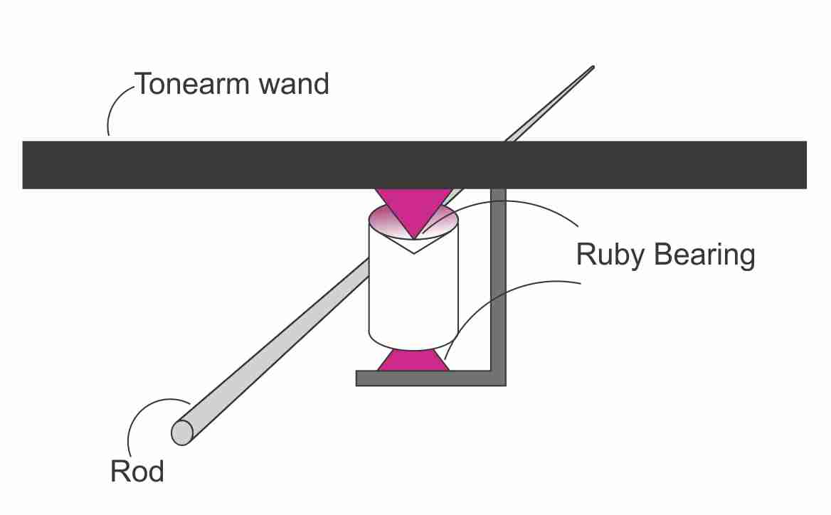

Thanks Tom,
didn't knew that rotation of sphere (dish) aligns the stylus and friction holds the pivot along the rod. This is brilliant idea.
Would a bearing where the rod touches the pivot help in reducing friction ? Kindly see attached pic. (Pardon for rather crude diagram) the bearing can be firmly held if we use plate spring at bottom to hold it in place. For example like this.

@Hiten,
You are right, a bearing is much better. So I have made a bearing from a low voltage connector and a stainless spoke. See this picture. The short peace of the spoke is glued into the outer tonearm tube.

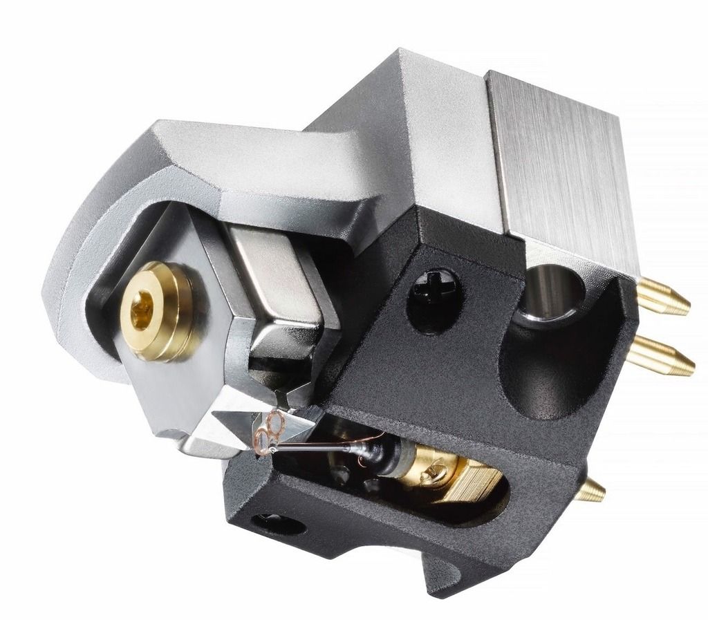

I think that Decca made several cartridges like this. As your cartridge is mechanical (it uses a physical stylus) it will still have to have a suspension of a certain compliance. Coupled with the damping you mention and the mass of the cartridge body/arm effective mass this will create a spring-mass-damper system the same as any other cartridge.
In recent production, the newly introduced Audio Technical ART-1000 is similar. As you can see the coils are right above the stylus but it has a rather long cantilever from stylus to the suspension. I'm curious what material is the cantilever. Reportedly it's very hard to make and only one person knows how to make the coils and install them properly.
