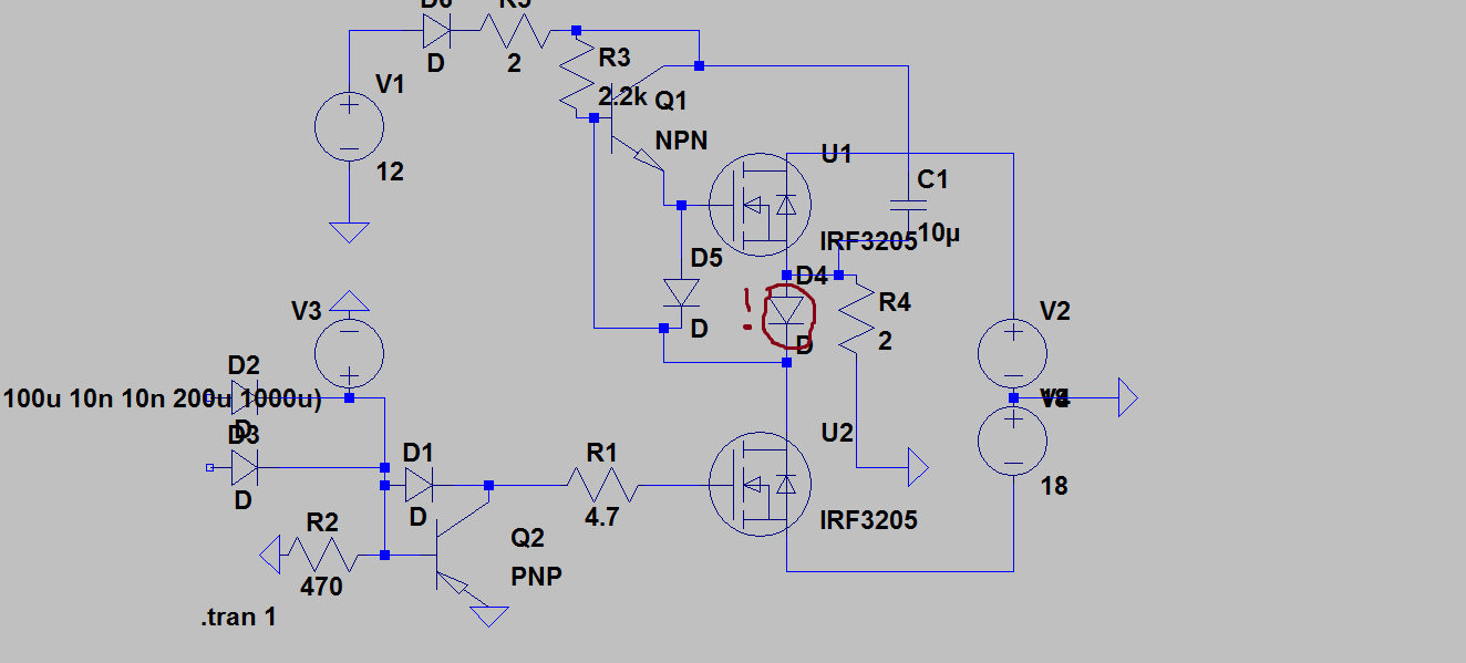

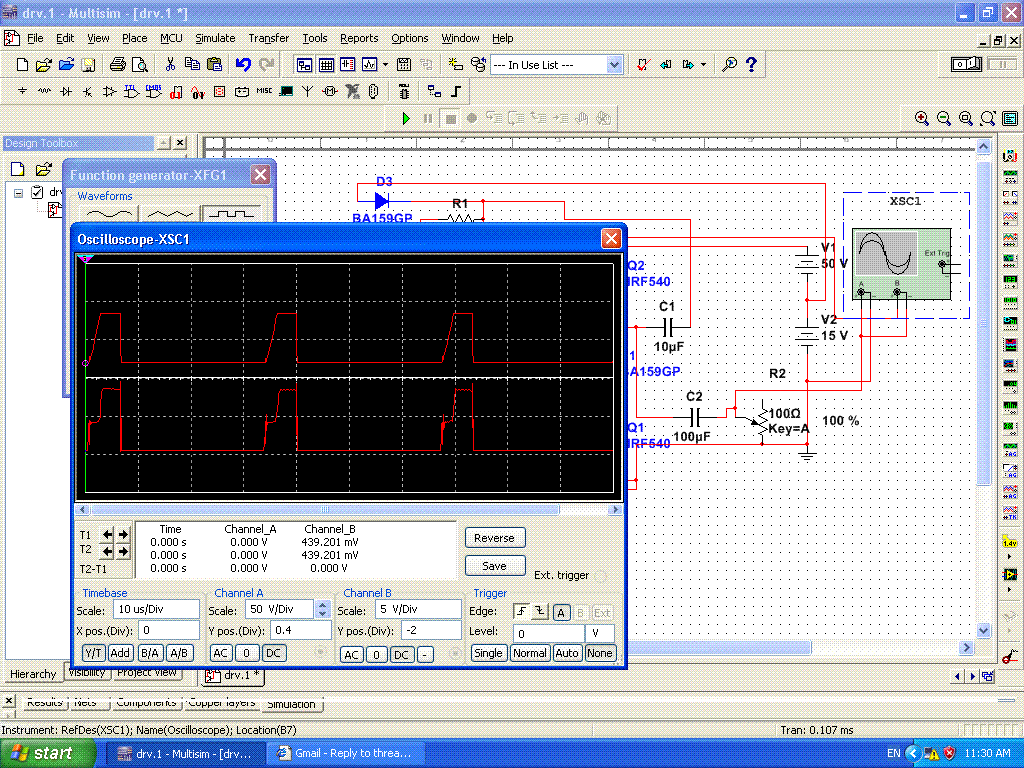

Gate drive seems to work fine in simulation, i wil try it with the amp i designed and probably build it
Hi,check my simple driver,not best but good enough 😱
Place 2R2 in series with diode on 12V,to limit current peaks.
same schematic as yours,without amp circuit,2k2 resistor., D1 encounters 12a peak at start for 7 us
It works well with split supply in simulation,with very hard to drive mosfets,but i dont like the 8 A on d4 in my schematic,i would dissipate more power than anything

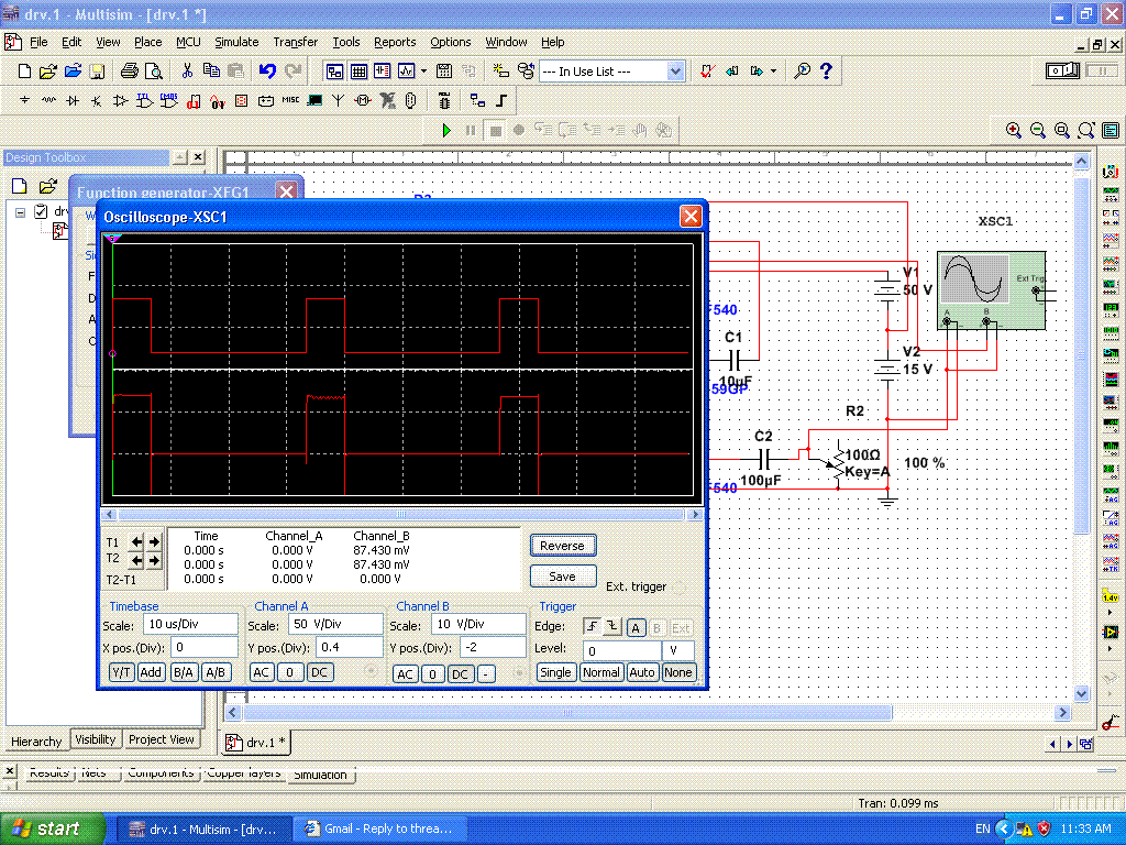

Can you see that slow start up edge on upper gate?
I use Multisim,result is same as in practice.I try to make better driver,but without results 😀
With resistor drive is much better,but dissipation is cca 6W (with max duty it's 12W!)

What about reversed PNP?It works well with split supply in simulation,with very hard to drive mosfets,but i dont like the 8 A on d4 in my schematic,i would dissipate more power than anything
Yes,it will dissipate more than fets 🙂
I'll try another idea...
Yes,but 100n series cap. may have resonance at audio freq.

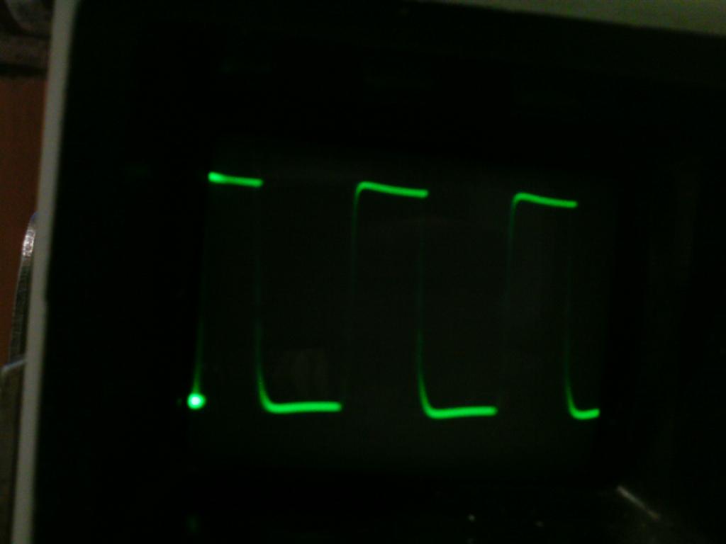

Check my new progress 🙂

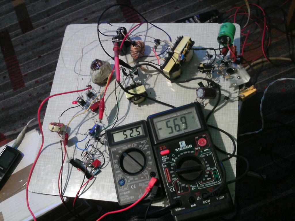

Class D on +/-56V 500W SMPS working now,with feedback,offset 1,8mV 😉
Do any interested 😀
First pic. voltage measuring. (Left meter lies,chinese s*it) Both voltages is same.

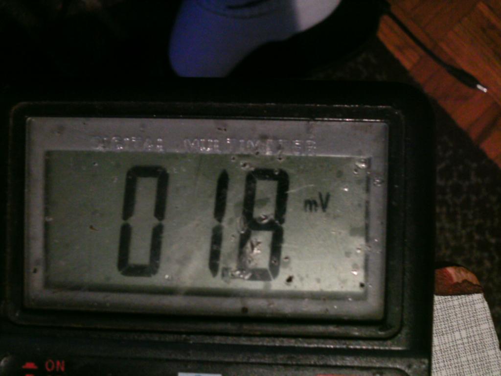

Last pic. offset

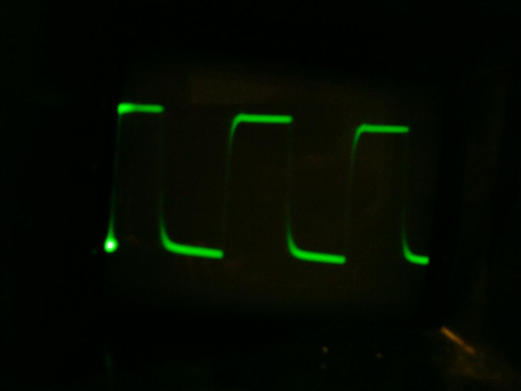

Second pic. wave after totem pole

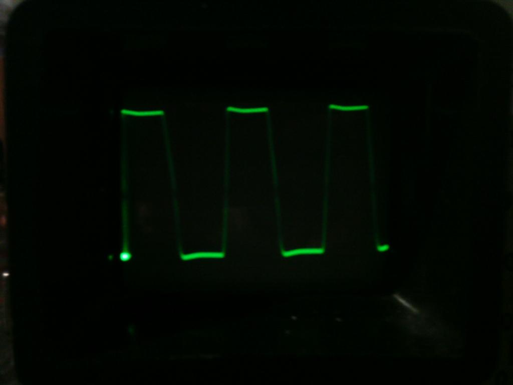

Third pic. is voltage at drains of fets.
Fourth pic. is voltage at SMPS transformer.
