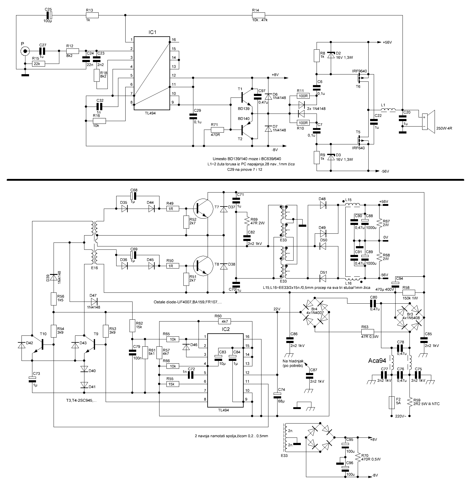

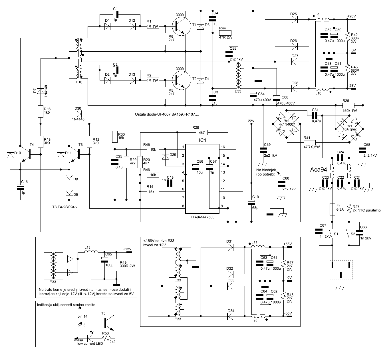

Here's text about inductors,etc.
SMPS za pojacalo snage 500W - Smps - DiyAudioProject

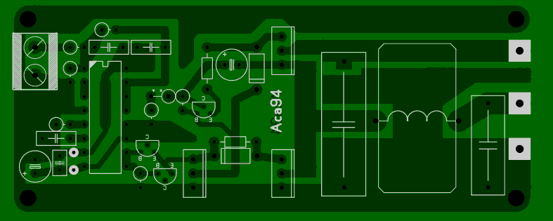

And here is PCB,I plan to mount oscillator over/under rectifier pcb.

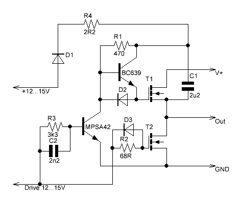

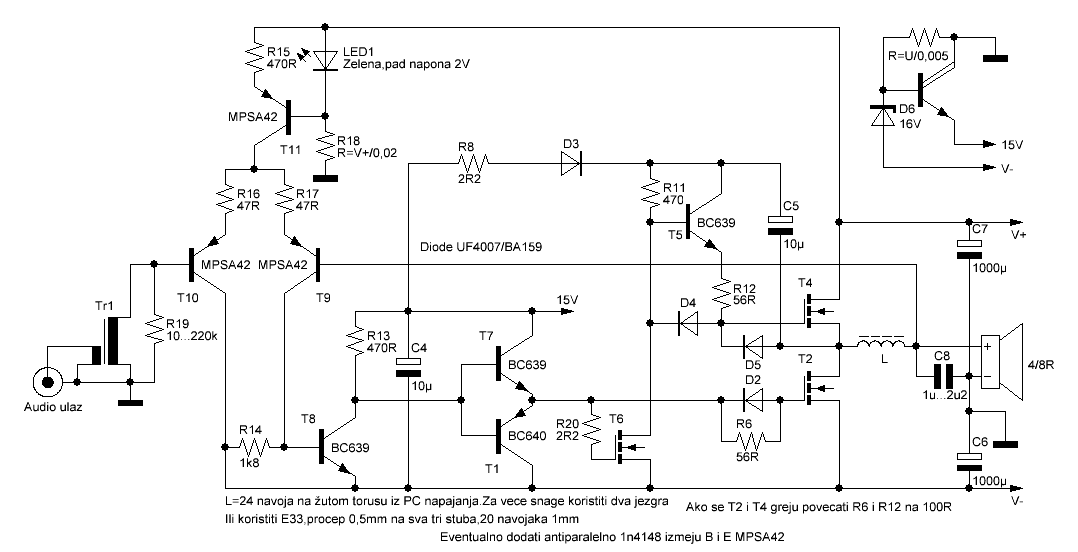

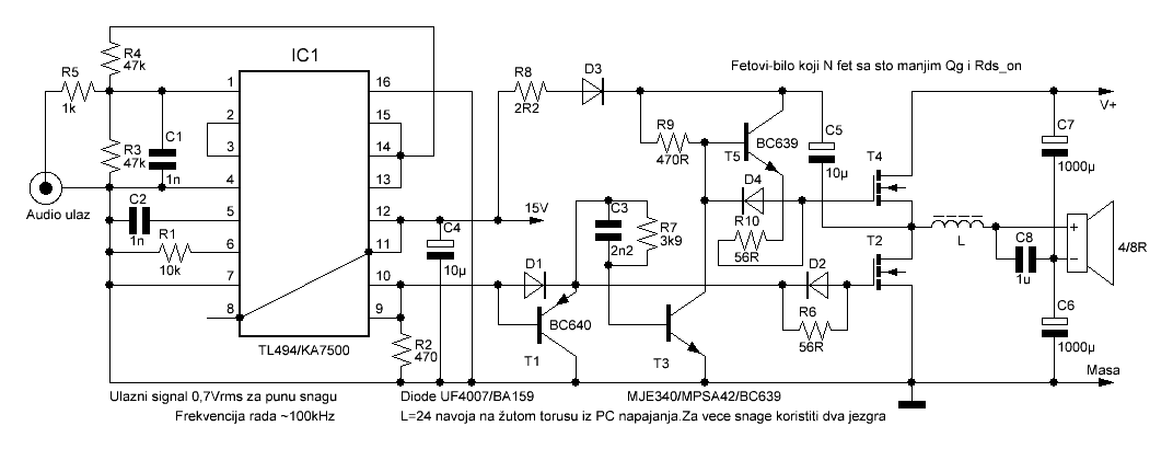

I tried both versions,one same as sch. in attachment,and now listening to it.Another with classic feedback from Ucd amp works great.Better than SG when optimised
Sch. same as this,but without transformer and added small RC for feedback and resistor divider for gain.
You can experiment,bases of MPSA is + and - inputs of discrete op-amp
