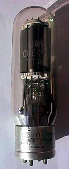

I heard a push-pull 845 11 years ago that was to die for.
Course back then using such high voltage was discouraged, at least for those of us who were not great DIYers.
I think these days, building a similiar creature would put me back some serious coin in iron. But I still think about it.

naah ....... that's just 1KV ; nutin' compared with usual 1.5KW FM x-miter , where 2.5KV are must ........
just put one hand behind back , when doing anything inside
seriously - toob amps have one good thing - output xformer ;
Papa's amps have another good "thing" - Papa himself
