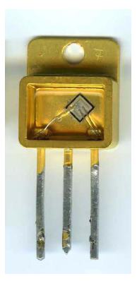

This is not another Lovoltech. I think that SemiSouth is potentially
destined for big success. They've got lots of patents, apparently their
own fab equipment, and Silicon Carbide process that makes for better
switching in converters for solar cell arrays and electric cars.
It is a coincidence that it makes for such a good audio part.
The SJEP120R063 samples for around $60.

Another direction that I have tried in the last 2 days was to look at smaller devices. It appears that these devices might have a better chance to have a "flat" transconductance vs Drain current characteristics. For example, I found that for IRF9610, the gm curve is rather flat between -1.2A to -1.8A (Max rating), giving us a +/-0.3A swing possibility.
Assuming I need 5W into 8 Ohm for my F2, the current swing will be +/-1.2A. If I can parallel 4 IRF9610, I will be able to get this swing. Of course, there are many other things to be thought through - like reliability of IRF9610 biased to such a high current (1.5A), total dissipation, input capacitance etc.... Still a lot to think about...
But these device are much cheaper and more readily available. Hope after some more digging, something pops up.

Can this be an interesting alternative?
I found BUZ905 rather interesting.
A P-channel MOSFET, with fairly stable transconductance. If biased at 2.5A and expecting a +/- 1A swing, the transconductance seems to vary from ~0.97 to ~1.2. Power and current handling are OK as a direct drop-in to F2. Linearity looks much better than IRF.
Certainly some changes needed as this is a P-device. The N-channel complementary BUZ900 is good but not as good as the P-one.
