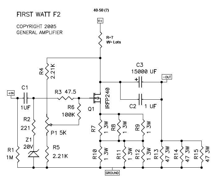

Just to make a quick update here: I finally finish my F2.
This is another "used-what-is-available" amplifier. I got a SOZ sitting idle for a while (I switched to use the J-PLH). So what I do is to dismantle this SOZ and try to make every effort to reuse the parts in building the F2.
The following adaptations are made:
1. All MOSFETs are N-channel from SOZ, so the current source in this F2 is a N-channel version. The circuit was published in a former post in this thread by some contributors.
2. The power supply of SOZ is +/-15V, or 30V by re-arranging. This is high for F2 as the design requires 24V. Running at 30V brings too much heat. In the SOZ, there are several 50W 8R big resistors. I put 2*8R in series with the primary of the transformer to bring down the voltage. These resistors run very hot and require heatsink. Also, they are running at LIVE voltage so the heatsink must be grounded properly to ensure safety.
3. There are also several 50W 1R resistors in SOZ, so I use them to build a RCRCRC filter as the main power supply.
4. Essentially the voltage is close but slightly higher than 24V by doing all these. The devices do run hot.
Applying this F2 in my system, which comprises of a B1 buffer and a Fostex FE168 sigma speaker, I do not put the 3*47R in the output. I want to test different settings.
Trying 22R to start with as the damping R (R0 per Nelson's article on current source amp), I find the bass to be rather constrained. Changing it to 36R, the low end opens up drastically. However, there is a feeling that it might be too much (insufficient damping). So I switch to 30R and things are in good shape. The treble seems to be a bit harsh just with this R0. The FE168 sigma, driven by a voltage source, has a very flat high freq response. Under a current drive, it seems that the high end needs some taming. I apply a R1-C1 path (again Nelson's notation in his article) to provide an attenuation shelf. Using what I have in my box, R1 is 36R, and C1 is 4.4uF (2*2.2F in parallel). Characteristics of this network is as attached.
With this network, it sounds smooth and without any fatigue feeling now. More listening to come but I like this F2 a lot.

You really do have to screw around with the loading to get the performance.
I was really disappointed with Art Dudley's review because he apparently was
unwilling to experiment with that.
That was disappointing, because of all the writers in Stereophile's stable of reviewers, he seemed like the guy most likely to be open to that sort of thing.
It is very obvious that if you yourself add a compensation network, you are "polluting" the sound - a view hold by many. So they are rather to be absolutely wrong instead of having a chance to make it right.
Of course the compensation is for the speaker, not the amplifier.
It's not the amplifier's fault if the impedance of the speaker wanders
all around.
all around.
Nelson Pass said:You really do have to screw around with the loading to get the performance.
Having built F2 lite, and then ZV9 without feedback, I had a taste of these. They excite different response from the speaker. It sounds more "alive", like live music, especially voices get stunningly real. But, not loaded and compensated correcty, they can sound nasty.
Tweaking the compensation network can be a real pain and it may take quite some time (and a side comment from the significant other), but in the end it is worth it, because it is possible to get rid of the "shrill" and retain "openness" and "air".
