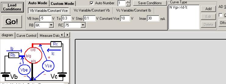

measure FET ,you can insert G to B / S to E / D to C
and press 'Load Condition' button to load ‘N-JFET Vgs-Id(Fix Vce)’ measurement conditions,
attachment.php
The measurement conditions mean
1. It set Vb from -5V to 0V step 0.1V mean Vgs from -5V to 0V step 0.1V
2. Set constant Vce=10V mean Vds is fixed at 10V.
3. RB=6K mean Gate protect resistor choice 6K ohm
4. RC=75 mean drain current sample resistor is 75 ohm.
5. Imax=30mA mean measurement end at current reaches 30mA.

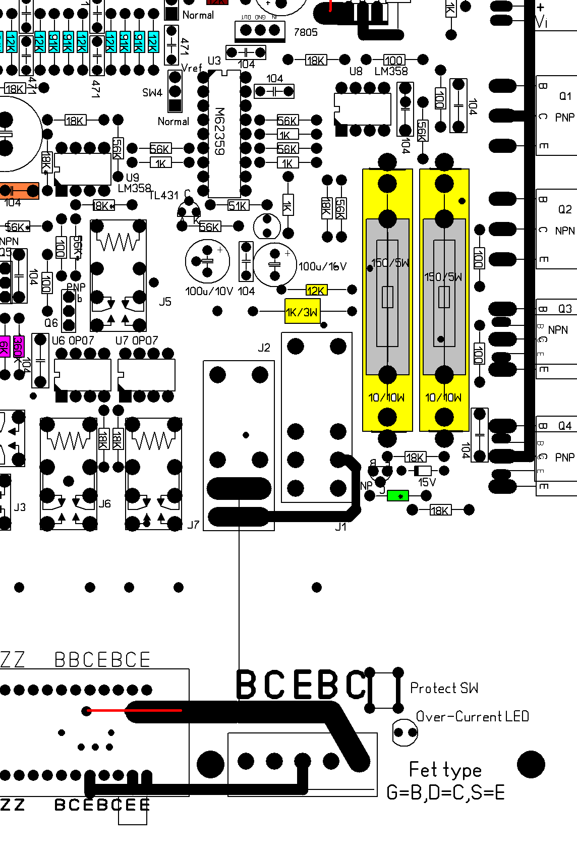

There are two reasons when the traces are interrupted.
1. Over-current protection is not to enter the protected, and ‘Imax’ set equal to 2500mA, the measuring current reach or more than 2500mA,it will normal suspension of. and traces show normal.
2. When close to the measurement socket next to the LED light, it mearn the circuit into the over-current protection status. it were suspended. The last point of the curve measured values ​​will produce abnormal. and last point on the traces show abnormal.
The curve tracer can measure more than 4A current safely.
Increase the over-current point ,you can replace the green resistor on picture
attachment.php
but the resistor value you need to try.
Or install a tact switch on ProtectSW near the measurement socket. when you press the switch ,the over-current circuit not work,so it can measure no limit current, and board have no protect.(I don't suggest)
