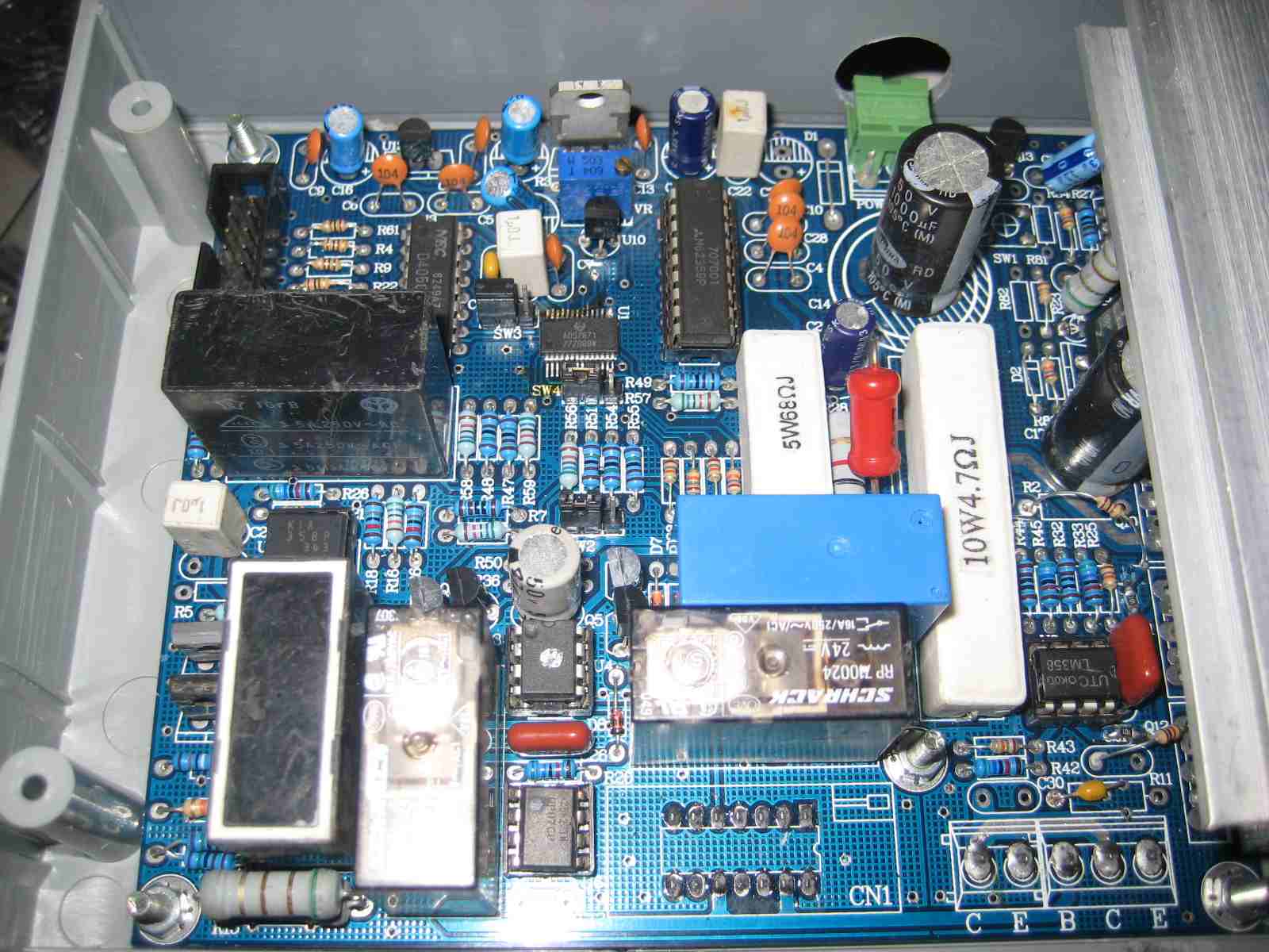

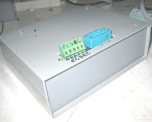

1.The power connect name is 'HT3.96-2P'.
2.The 'protect sw' is 6*6.5mm switch button. But I not recommend to install the switch. Because if you not measuring but the 'ove current led' light, once you press this button, it will lead to a larger component damage.
3. All mounting holes can connect to GND, and 7812 / Q1(PNP) / Q4(pnp) / heatsink can connect to GND.

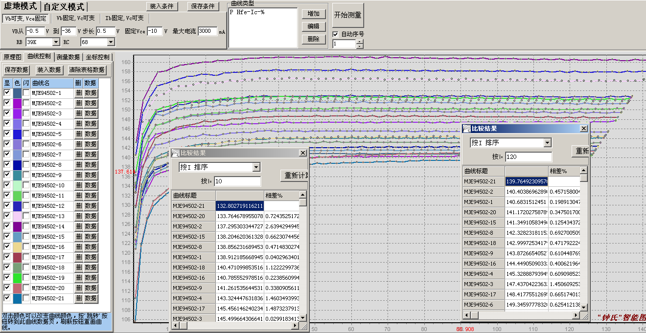

2SJ313 & 2SK2013
Anyone measured 2SJ313 & 2SK2013 from UTSource? The two I measured seem outside the datasheet norm.
