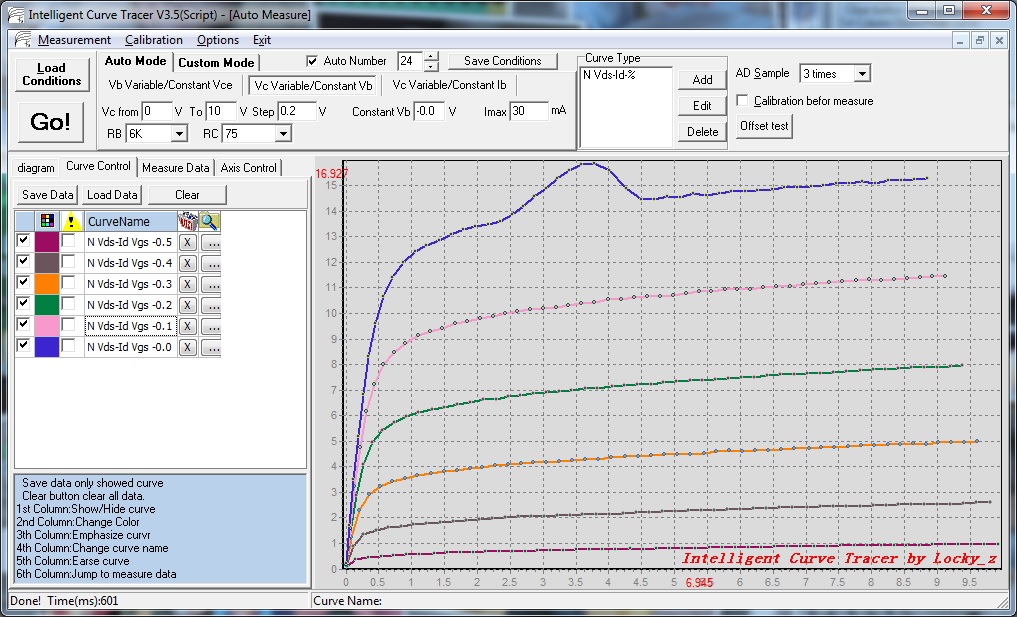

Got the Curve Tracer board since a month, but only got time to try it today. When I curve traced a BF862, got the attached graph. The top curve (when Vgs=0) have a strange shape when Vds is between 2.5-4.5V, what could be causing that?
  • BF862 Vds-Id.cuv.txt
Yes, it's very repeatable.
But I just found that the problem only exist when the DUT is connected to the left side of the green socket (marked BCEBCEE). If I connect it to the right side of the socket (marked BBCEBCE), the problem disappear.
Question is why.
