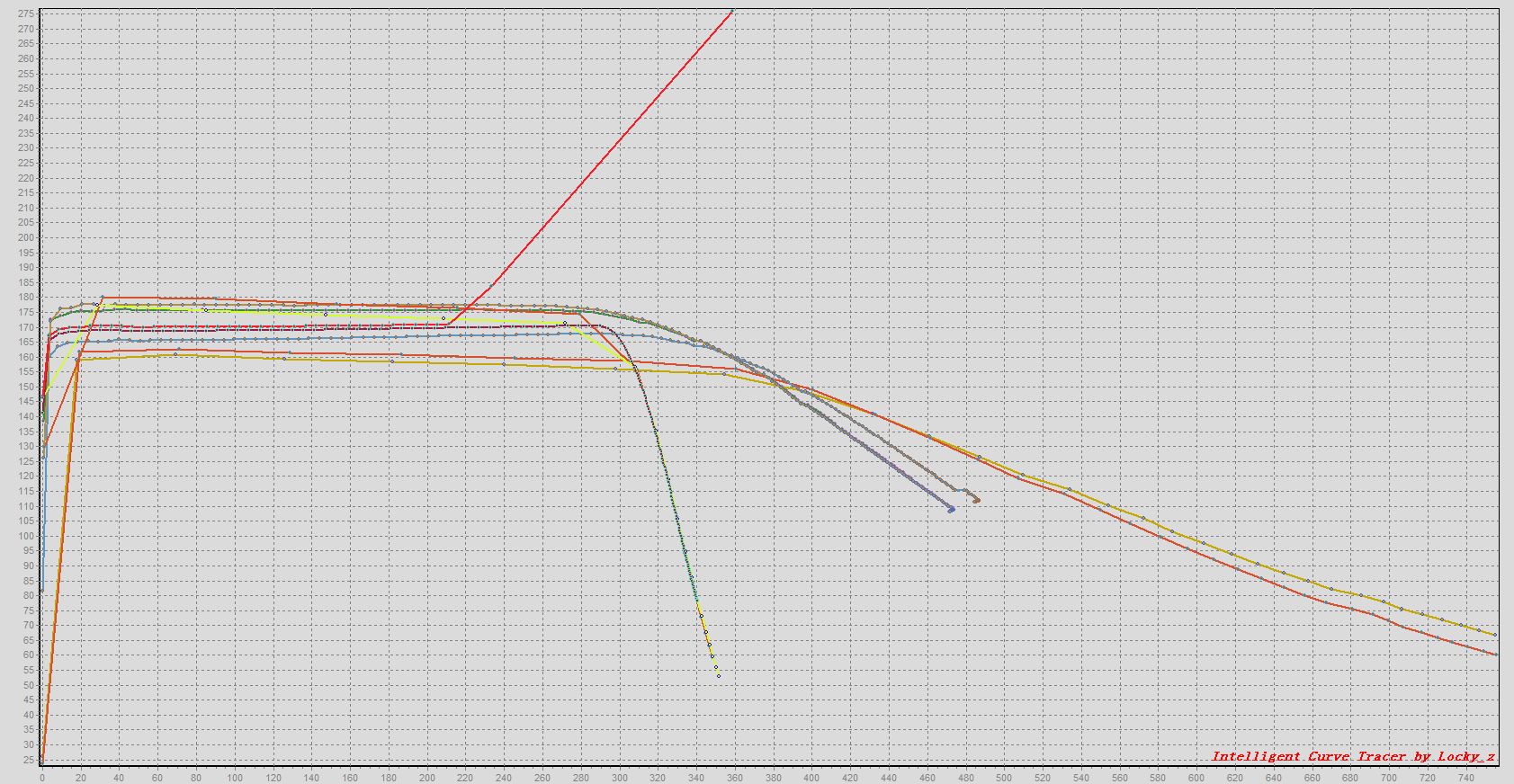

HEre is me measuring 5 different mosfets at 500 Rb and 4.55 Rc. Vce is fixed at 20V, Id max is 1A, and Vgs goes from 0-10V. As you can see there is one clean curve, but every trace after the initial one gets worse.
It has worked flawlessly up to this point. Just dont know what has happened. Replaced all mosfets. Have switched to 1013CP opamps.

The figure have selected "cablibration before measure"?
Re-run the program and don't select "cablibration before measure" use different RB/RC combination to measure the curve again.
1.RB=1360K RC=1K
2.RB=91K & RC=1K
3 RB=91K & RC=75
4.RB=6K & RC=75
5.RB=6K RC=4.55
6.RB=500 RC=4.55
Because If the calibration relay have wrong, But if you force to calibration, the memory parameter will change, and the test will failure.
The memory parameter will restore by exit and re-run program again.

Thank you for your support. I've done the same tests again, without calibration. For first 8 tests, the curve tracer works fine, but 9th test the problem occurs again (see attached picture)
I took out J1 and J2, and measured resistance across contacts:
J1:
NC contacts: 41/44 mOhm
NO contacts: 94/101 mOhm
Coil: 1162 Ohm
J2:
NC contacts: 176/240 mOhm
NO contacts: 10/14 mOhm
Coil: 1039 Ohm
Now that they are out, i will buy new relays next weekend.
thanks,
Ozzy

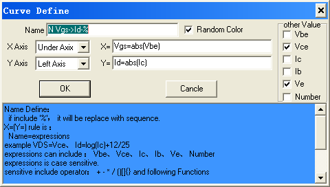

Sorry I thought I had posted this. Its a new .cuv file of testing under the same condition as previous graph.
In curve define windows not select the 'Vce' & 'Ve' ?
Because all measure,the 'Ve' must stable. So selected the 'Ve' checkbox, It will put the Ve voltage in the tabular detail data.
But in your save data, there are not the 'Ve' data.
