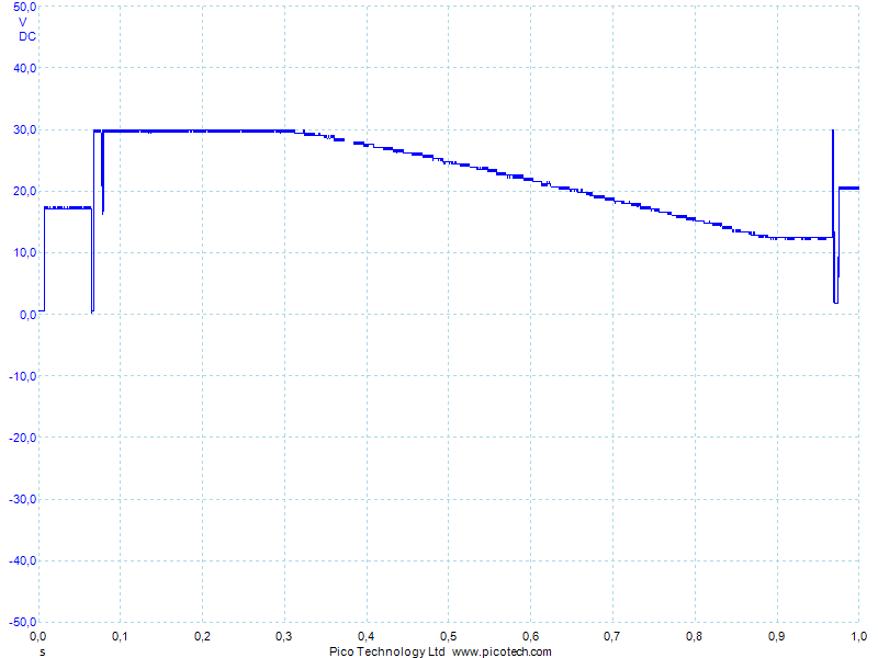

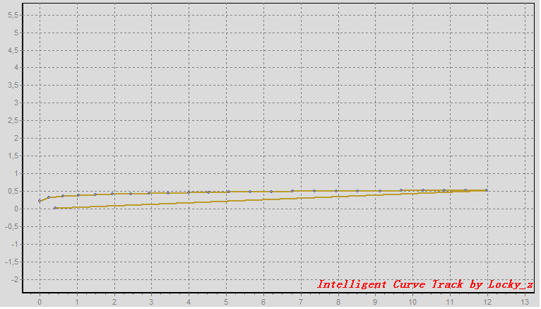

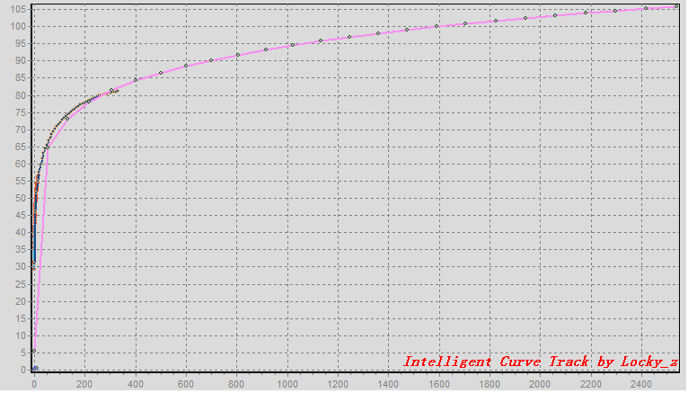

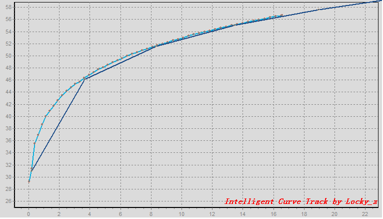

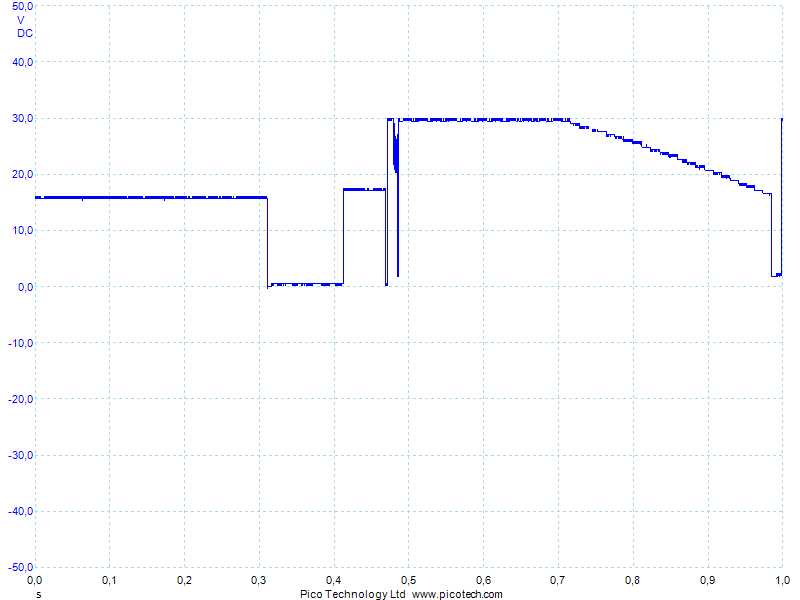

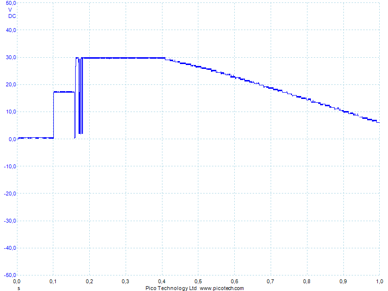

I have used a 33V AC, 200VA transformer saved from a broken labsupply, and regulated it down to 31V DC with a simple zener + power darligton sceme.
There is one issue however:
In the dropdown menu for RC the choises are: 1K, 75, 1K, 12K.
If I choose the top 1K were the 4R7 choise would be I get a very low reading.

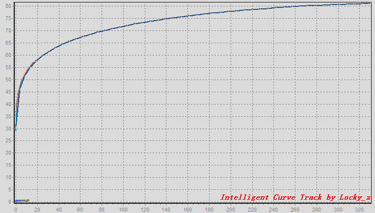

I have taken some Oscope shots from collector to ground with corresponding curves for different settings, on the same powertransistor. (2SC 3281)
VB 0.5 to 30V, 0.5V step. Constant VCE 30V. Imax 2500 mA.
1 and 2, RB 6K RC 75
3 and 4, RB 91K RC 1K
5 and 6, RB 500 RC 4.7 ?
I would be very happy if there is a way to fix this.
Please let me know if there are any other measurements you need to diagnose whats wrong.

Your measure condition is 'VB 0.5 to 30V, 0.5V step. Constant VCE 30V. RB=6K Rc=75'
From the following diagram
Vb from 0.5 to 30V, RB=6K,mean Ib is from 0 to (30-0.65)/6K=4.89mA,
if Hfe is 70,then Ic is from 0 to 342mA,
then the voltage drop at RC=75(Vrc) is 0 to 25.67V
because Vce+Vrc+5V must <= supply voltage, but your supply only 31V,
When Ic increases,Vrc increases, the Vce can not constabt at 30V.
you see this picture
A start can be maintained in the 30V, but as the current increases, the increase of Vrc, Vce won't stay, you will see the Vc drop.
the same RB=91K RC=1K,you can calcuate the Ib and Vrc drop range,
RB=500 RC=4.55
trhis picture I don't know why
Thank you for answering locky_z.
The Oscope grafs was added to show that there is some measuring going on in all 3 settings.
I set the supply voltage so low because the opamp max voltage mentioned by Fred, just to be on the safe side.
The two first Curve tracer grafs looks reasonabl I think, but the third one seems too come out wrong. The same thing happens when I set VB 0.5 to 5V, constant VCE 10V.
A tiny graf at the left bottom corner.
I suspect there is something with software or calibration because the dropdownbox for
RC is from top to bottom:
1K
75
1K
12K
I think it measures what it should, but something in the calculation prosess goes wrong.
When RC is 4.55 and the software calculates from voltage drop as if RC is 1K I think the graf would be something like the third one.
I have Unit 127, if you have the files for different units saved.
The little configfile you open in notepad says RC0=4.55......
Regards Styrk

In the calibration meny under current calibration it says RC0=1K
Maybe something there is wrong here, but I cant chance the values so I dont know what to do here.
Styrk
Styrk
Styrk
You select menu Options->Config,
select page 'Relay and resistor define',
If RC0 's value not '4.55' ohm,you can change it to '4.55' and save.
Note: Because float display problem, 4.55 may display as 4.55000019073486.
Hi locky_z,
I had the same issue as styrkv.
It has to do with the decimal separator. In many countries, it isn't a point but a comma. When first running the soft, the select box for Rc value of 4.55R appeared as 1K and the Constant Ib courrent feature didn't work, no base current was flowing at all.
To overcome this, I just replaced all the decimal points by a comma in the S7871_V3S.ini file.
I also got some inconsistent results from time to time. The schematic and the static measure feature were very helpfull to discover what was going on. Without any device inserted, VB was sometimes higher in value that VBH. I discovered a bad solder joint on the normaly closed contact of J6.
It's now working well and I must thank you Locky for this very powerfull and simple to use tool. For sure like pointed earlier, a best buy.
Francis
