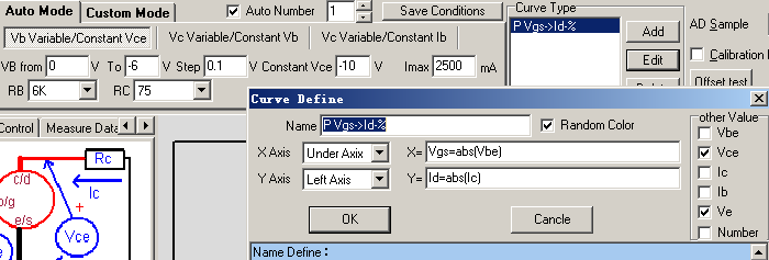

Got it
there is a limited numbers of calculation made using parameters
Load N Vgs->Id-%
Highlit expression and clik edit
Change Name to one of your choice
then change expression on left axis to =Ic
Swap the expression on X=
with one on Y= and repeat top to botom botom to top.
Test your mosfet
Now curve will show Vgs agains Id
Graph flatens out once you hit the current limit (2500 mA )
so no worries there

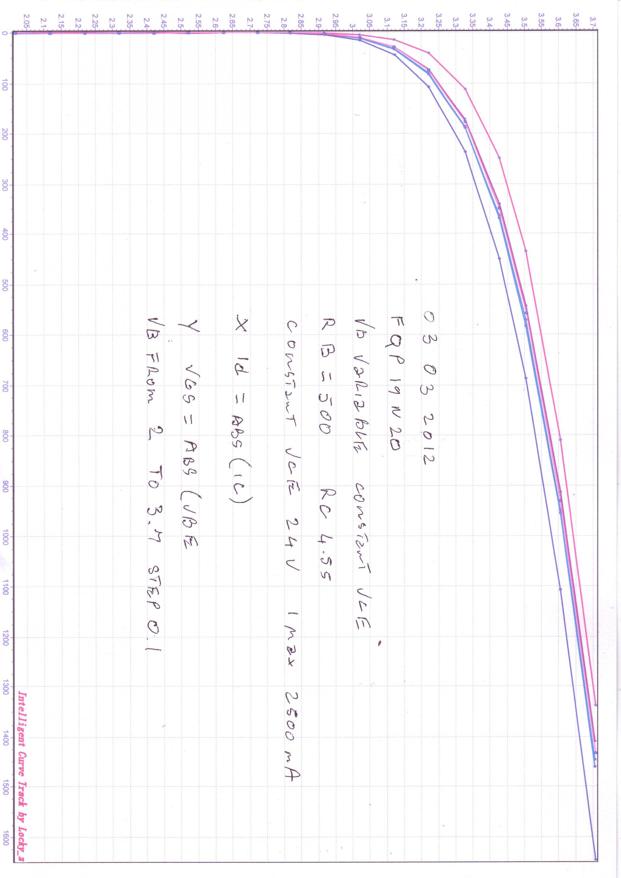

I was matching FQP19N20 for my F5
I use 24 V 2A and constant themperature of 50 C (this takes loads of time and fine calibration to get thigs right and constannt results)
I have made same mesurament using same pre sorted, with above method, mosfet

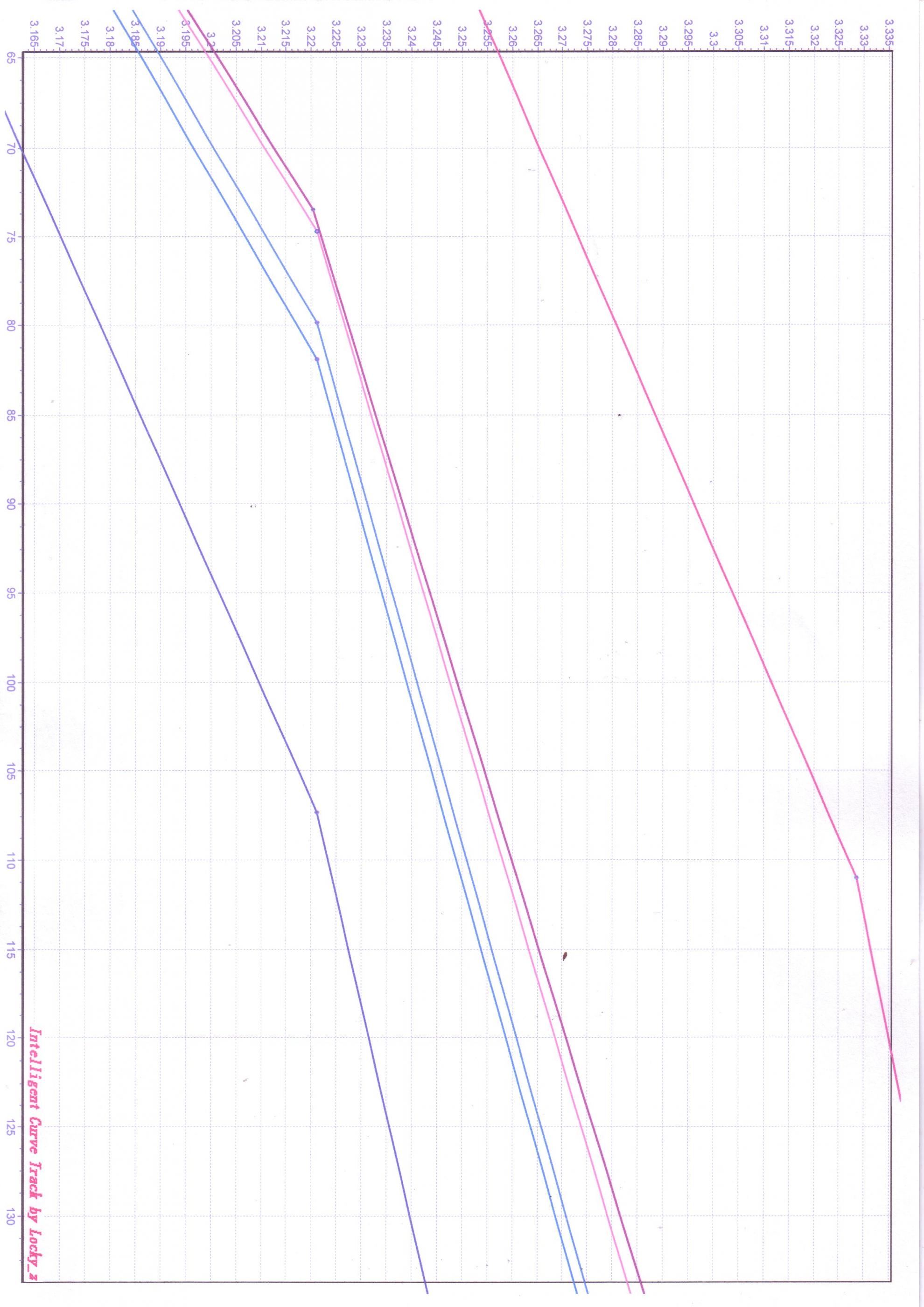

Graph show the 6 curves of 2 controll devices and 2 pairs
The curve tracer confirm the results I was gettin before
Graph one and Zoom in.

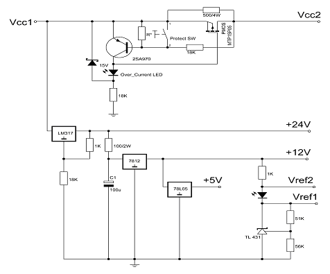

What is the heatsink size if you use higher current? Also what is the current protectlimit when it starts shutting down?
I don't know the HP psu current protect limit, I test some that had modified to 38~41V output,The shutdown current from 2.3 to 4.6A.
The CT3 protect circuit is below
The current protect limit determined by Rds of PMOS / 2SA970 / 18K / R*
I also adjust R* and make current protect limit >=2.5A, but when temperature increase, The Rds increase,so the current protect limit reduce.
When CT3 not being measuring, only LM317 heat, Q1~Q4 not heat.
You only need a thickness is 4mm, the side length of 40mmx40mm, the length is 12cm of angle aluminum as a heat sink is enough.
Because measure process is fast, If a curve have 100 point, It only need less 3 second then OK, and the current is from low to high,Q1~Q4 work in high-power is less 1 second. So Q1~Q4 is a little warm.

Hi locky
Tanks for your explanation about current limit
I have one tought about this
Why would one want to test at such hi currents if then when in use the devices are limited by the amount of heath they dissipate
For example (on my F5 TO247) will never be biased so to dissipate more than 50W.
with 25 V rails that would be 2 A.
Can I ask you If you could explain how to set up the formulas for testing VGS of P channels Mosfets
You can press 'Load condition' and choice 'PMOS Vgs-Id(Fix Vce)' when you want to test PMOS.
Combined with the following schematic
Because PMOS need negative Vgs,so set Vb is from 0 to -6V,step 0.1V
Constant Vce is -10V mean Vds is -10V.
Because PMOS gate current is tiny,so RB you can choice 6K or 500ohm or 91K
If you select RC=75ohm, The max current is about 400mA
If you select RC=4.5ohm, the max current more 2.5A
The Curve type Define window:
X-Axis define is Vgs=abs(Vbe) ,Y-Axis define is Id=abs(Ic)
Function abs() mean absolute value,
Becasue PMOS Vgs and Id is negative,so their Vgs-Id curve will be in the third quadrant, Use abs() function to change them to first quadrant.
