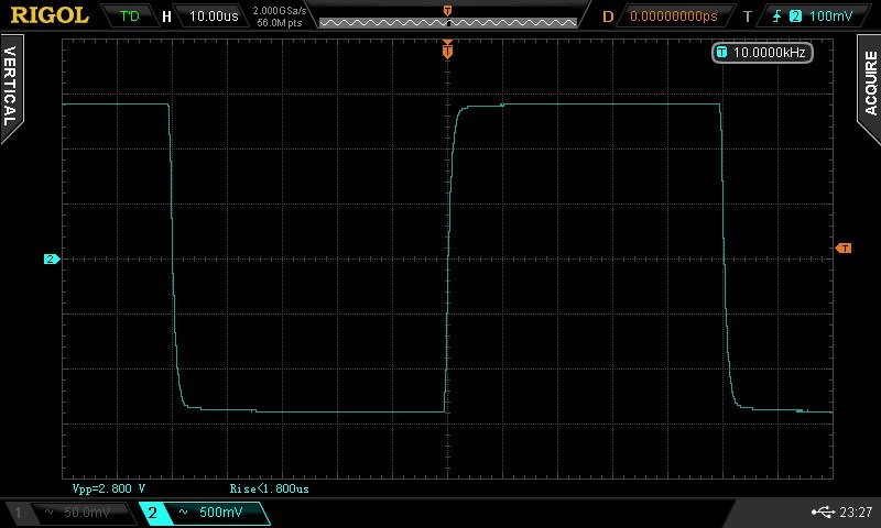

I also think you need to look at the time base used for the actual graphs @fireanimal produced. Kind of like comparing apples to oranges. I seriously doubt the frequency analysis examples used a 1uS/div time base.In the atached picture you can find some details generated by Dr. Borah long time ago.
Now there are some changes in the best spected square response.
You got a good square answer with your low distoction profile and is like the SIM result I got with the limited information from your schematics.
There are some product review that show what is the best answer by now. I could not find the review to show you as a reference.
Thank you for your time.
Just eyeballing, that is looking like about 15V/uS slew rate on the lower large signal plot. Someone correct me if I'm wrong.
The slew rate looks very close to the expected 74V/us = (0.7 volts)/(200 ohms)/(47e-12 farads).

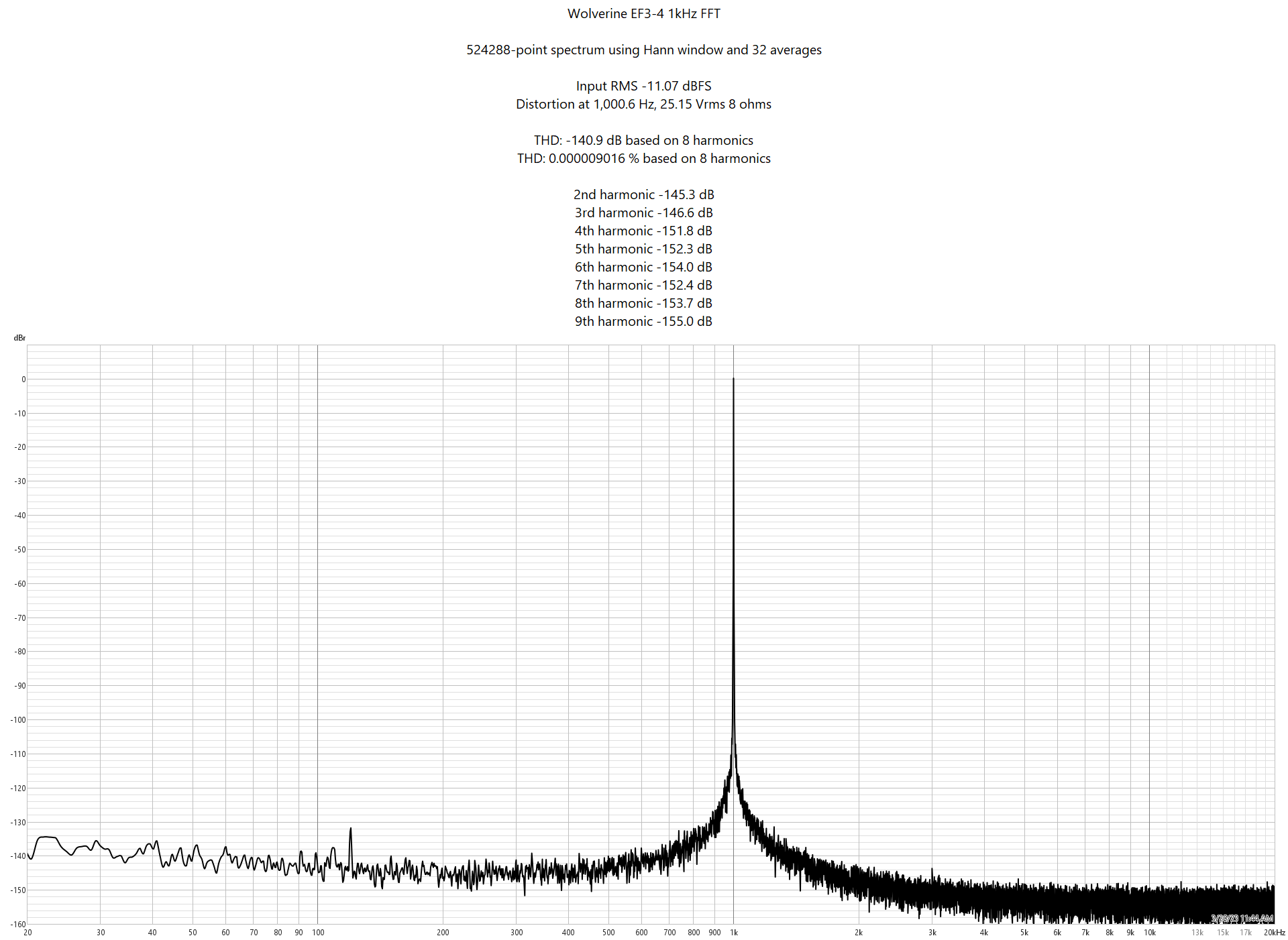

Are you sure about this measurement #1655? 2nd harm. -145.3 dB ??? That's rarely achieved by a very good op amp. I can't imagine that with a power amplifier with an 8 ohm load.
No I love to post false measurements. Yes its verified and repeated multiple times, I was 100% sure it was correct before it was posted on here. I have worked for almost 6 months on my measurement setup just to be able to measure the Wolverine accurately. In fact as you can see, I am sure the THD is actually better, but I do not have the equipment to extract it from the noise floor.

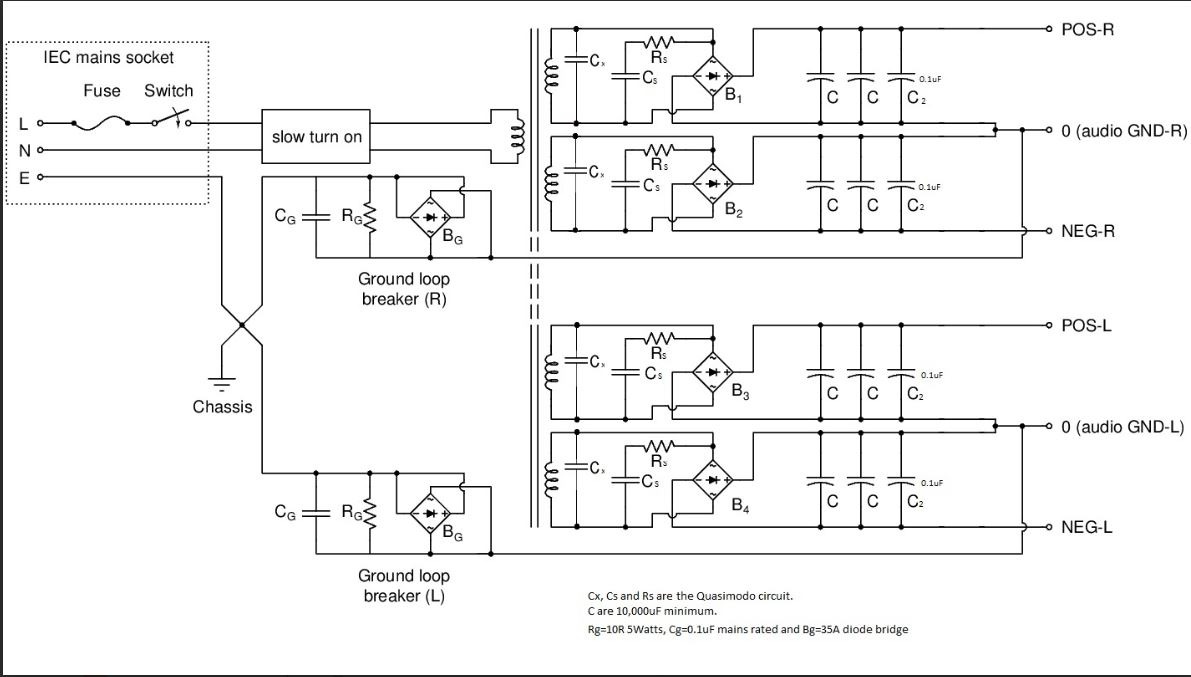

Goodies,.....still a bit early to worry about those 2 mf's but glad they are in at least. I saw the example powersupply scheme in the documentation and these 2 are at the basis of it. I do have the quasimodo jig to determine the R value for the 4 snubbers I have to add.
The Wolverine boards should be ready in 1 to 2 weeks after which I need to start testing and I do have a few questions on the test-setup. I've read all the notes and remarks of Stuart mainly but just want ot make sure of a couple of things.
- Is the normal way of testing using the power-supply I still need to build in conjunction with a dim bulb tester at the AC part and lower value fuses at the PCB part?

I would buy a cheap variac if you can. 300VA is enough for testing. That way you can slowly ramp up the AC voltage to be sure
I did a back-of-the-envelope calculation that gives the same THD as the measurement. This amplifier is easy to analyze. 🙂
Open-loop gain = 92e3
Closed-loop gain = 29
Negative feedback = 70dB
Open-loop output stage THD: -70dB (from my THD simulator)
Closed-loop THD: -140dB
The calculation is below:
The output stage already has low distortion with Re=0.22ohms and four pairs of transistors. Then, 70dB of negative feedback is applied.

Code:
// wolverine
// compute thd of wolverine at 8 ohms and 1KHz
// Copyright © 2023 Ed Grochowski
ic1=0.7/200/2;
gm1=ic1/0.02585;
xc=1/(2*3.14159*1e3*47e-12);
vgopen=gm1*xc/(1+gm1*22);
vgclosed=22e3/(1/(1/1e3+1/3.9e3))+1;
nfb=20*log10 (vgopen/vgclosed);
thdopen=20*log10 (.0003);
thdclosed=20*log10 (.0003/vgopen*vgclosed);

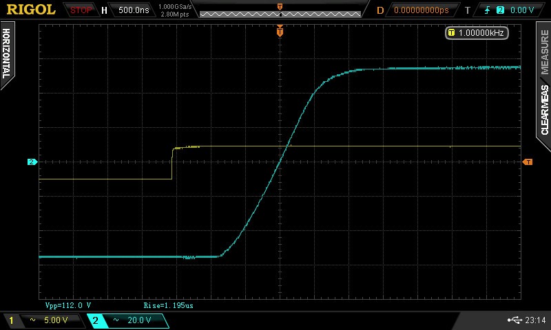

Here is a measurement at 112 Vp-p square wave at 1 kHz into an 8Ω non inductive test load, the signal generator has a measured rise time of 14.4 ns at the input terminals of the amplifier including the input lead.
I used a 200 MHz 500 MSa/s function generator and a 300 MHz 2GSa/s Oscilloscope.
The slew rate is calculated based on the rise time reported by the oscilloscope at 10% to 90% of the amplitude: 112.0 V - 20% is 89.6 / 1.195 µs = 75 V/µs

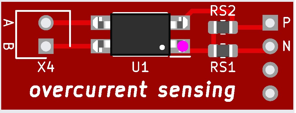

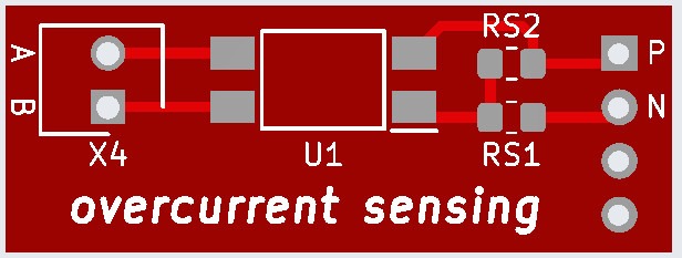

Just in case someone wants to use the ssr based protection boards designed by @LKA and just didn't dare to design his own pcbs to enable the overcurrent protection, I made these tiny overcurrent sensing boards for my Wolverine:
View attachment 1145193View attachment 1145194
For Gerbers (and also the files you'd need for the assembly by Jlcpcb) just send me a PM.
Could someone tell me the values for UI rs1,2
Or how to find them, for 64v rails, 200watts?
Thank you!
Ok I think U1 is the LTV-817s, R1 is 47 ohms and r2 may be 100 ohms - is that right?
Thank you!
marktd - With those resistor values, the current limit is 12A = (((1.2 volts)/(100 ohms)+(0.02 amps))*(47 ohms)+(1.2 volts))/(0.22 ohms)
