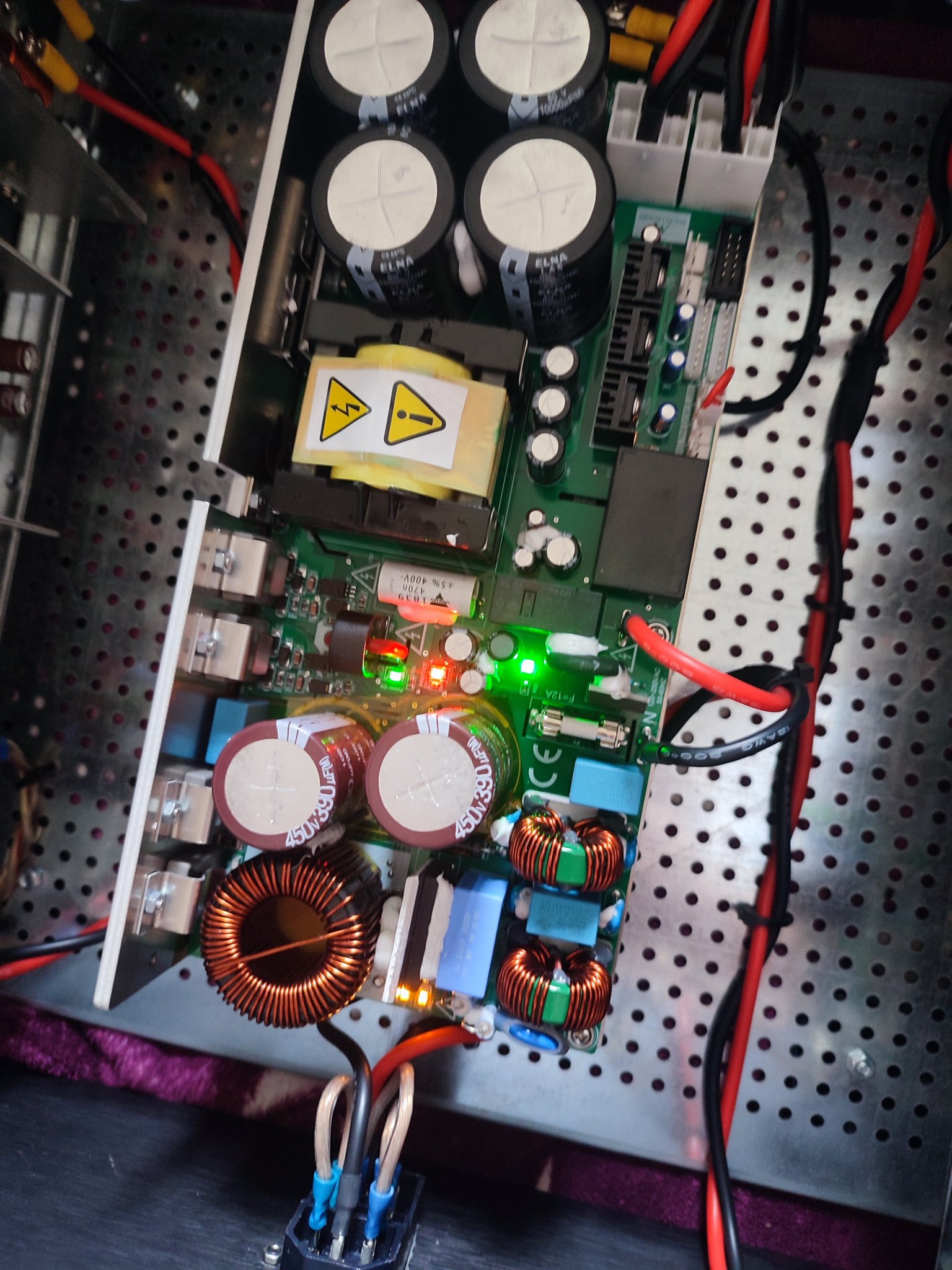

Hello guys
I finished building my AMP yesterday and I was brave enough to start in today. Unfortunately I could not get any sounds out of it
I used the SMPS Cobra-S2 from Microaudio but it seems to go directly into protect mode, at least the LED is red. Does anyone of you have an idea what I'm doing wrong?
Strangely enough, I got the channel that was connected incorrectly to run briefly. Then I unplugged the cables of the connector and plugged again because I thought maybe they are too loose on the other channel. I then checked both again but after that I had no sound on the briefly working channel.

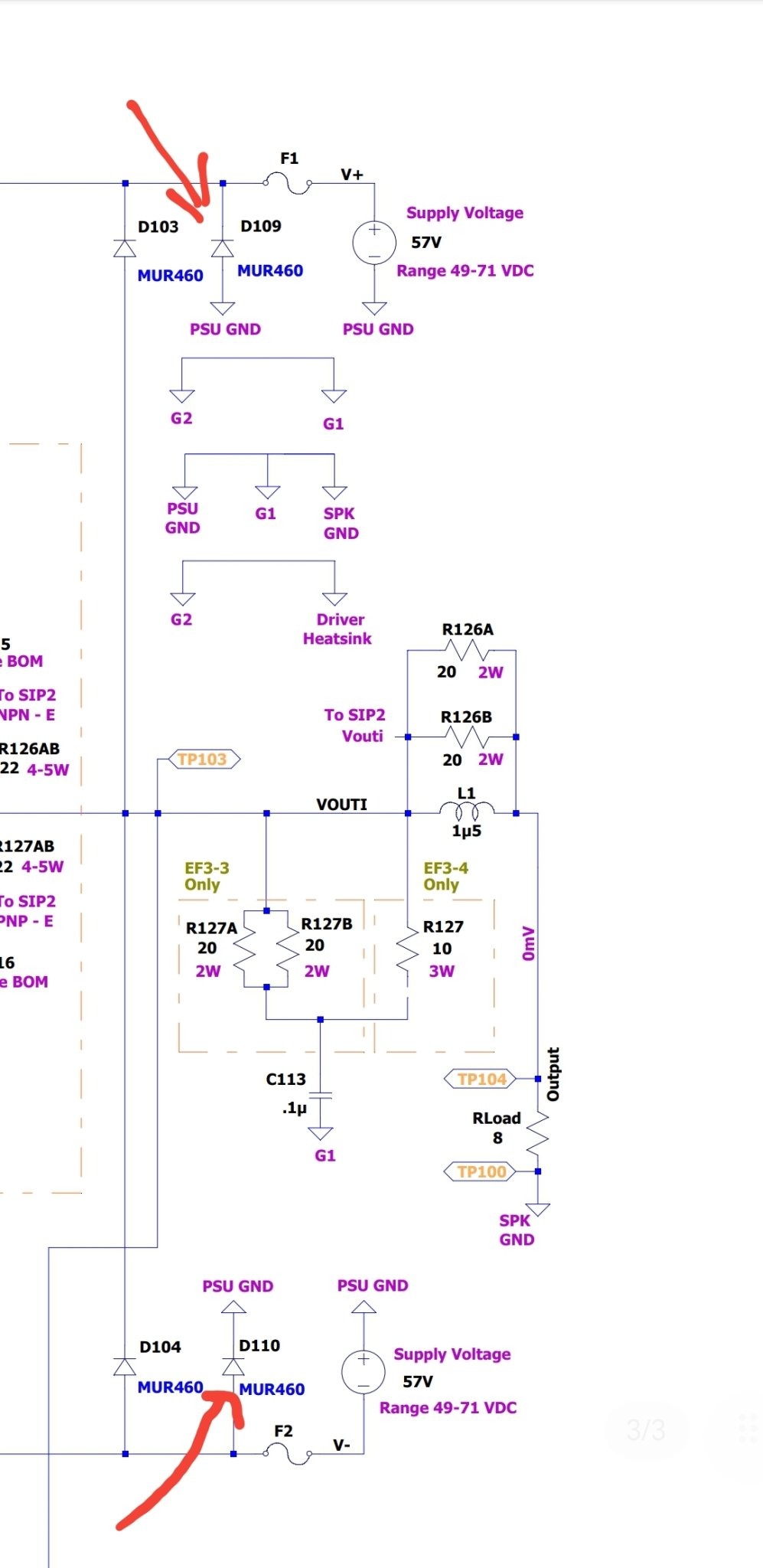

I suggest that you test your amplifiers using a low current power supply before powering them from the SMPS again.I made a pretty stupid mistake.
I unfortunately connected the boards as if they were symmetrical and well, then I stupidly confused + and -.

Check the build guide. Limit the current to what it mentions or 75% of your fuse rating should be ok for start up checking. Also 30v rails is sufficient voltage to do an initial test.what should I limit current to
