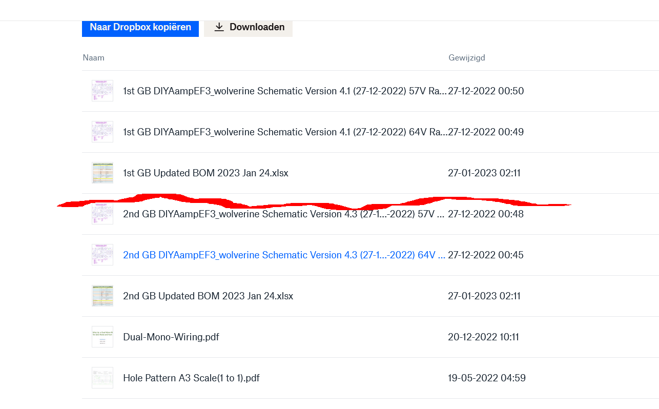

I don't put zip files in the Dropbox.The file: 1st GB Updated BOM 2023 Jan 24.xlsx
Packed in the zipfile "DiyAudio Members - Wolverine Project.zip" was downloaded 24-02-2023 11:23 CET
This must have happened when you downloaded it. Please move on @OmeEd

I just checked the dropbox, and the mentioned file 1st GB Updated BOM 2023 Jan 24.xlsx is still there.
So your assumption that I have an old file is misplaced.
The zipping happens when you press the dropbox [download] button, then everything gets zipped up. Easy as pie.

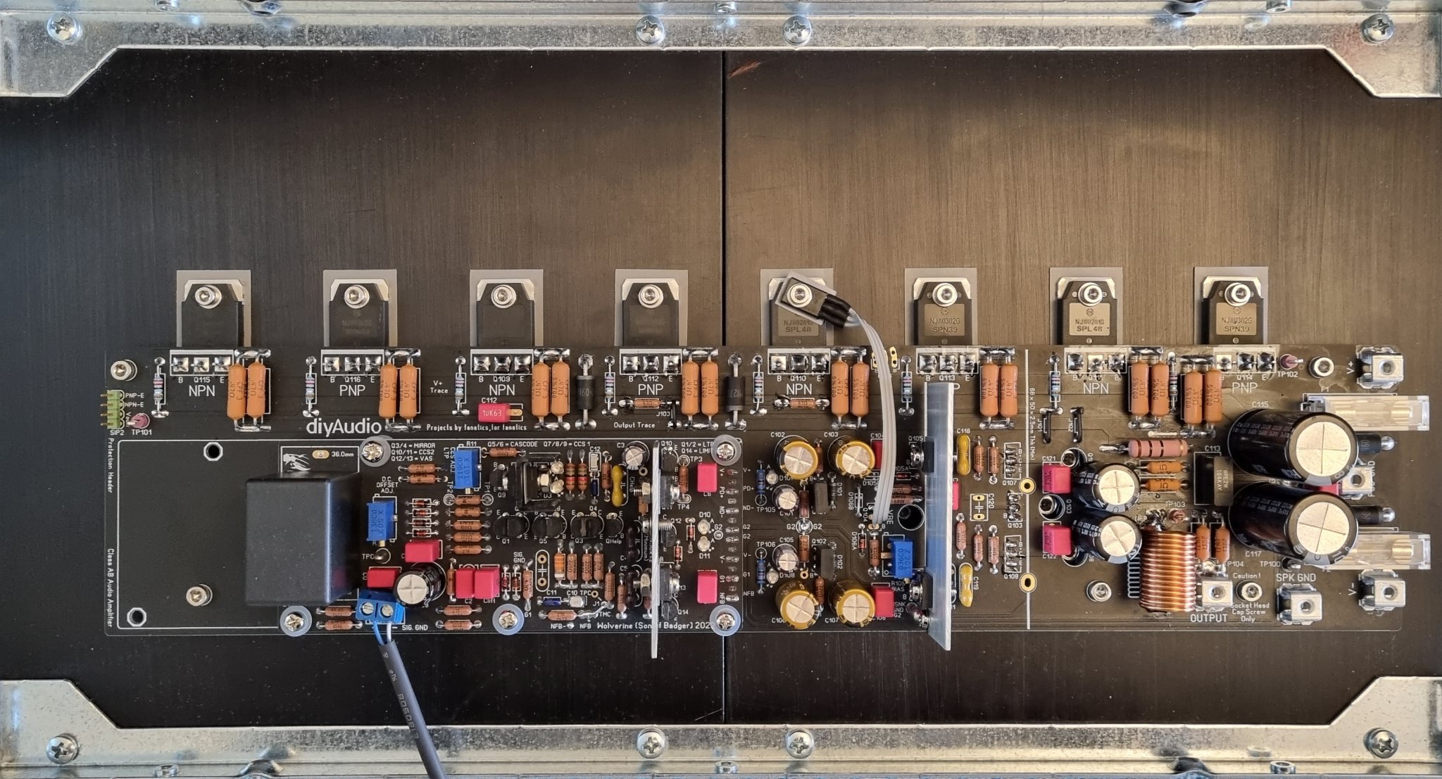

Three quick questions as I near completion on my first Wolverine:
1)The Q104 holes at the edge of the board are not connected to anything. Was the intention to allow for a Q104 mount on the heat sink closer to an output transistor, connected with wires to the "normal" position on the board?
2)What is the "socket head only" warning on the bottom right mounting hole? I know about different types of screws, but is this simply meant to tell me not to use a spacer with the male thread up through the board to ensure clearance to the ring terminals?
3) D9 on the IPS in the VAS emitter follower forces a DC mismatch on the mirror collectors. I'm used to seeing this circuit with just an emitter resistor and also tied to gnd, allowing the mirror helper and VAS to force near equal mirror collectors. I can see the advantage of this lower Q12 Vce allowing use of the low-noise/low-voltage transistor, but I'm unclear about the diode's purpose.
Thanks.
Hi mhuth,
1, Q104 holes on the edge of the board are for mounting similar to honey badger for Q104, I used small leads to connect Q104 and it is attached to the top of Q110 with a tiny bit of thermal paste in between. the leads connect closer to the center of the board near the screw hole and marking "VBE" see photo below
2, Socket head cap screws have a smaller diameter than pan head screws and yes the reason is creepage and clearance distance from the output terminal.
3, I will have to defer to JJS/StuartMP on this one.
Hope this helps
