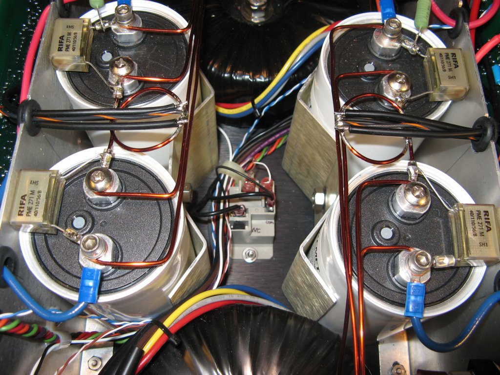

Gents,... with the 2 transformers both having 2x42 vac with 2 fullwave bridges per channel,.. I'll be needing some powersupply pcb's. I saw these on the diy store. Can they be used for various setups?... ie: with centre tap and without?... I reckon so but not a 100% sure.
Reguarding supply assembly and star ground, one way to do it, simple and quite effective is as into my Gamut clone, see picture. A piece of copper wire with a loop is the ground point between both +v and -V caps. This is the star ground point were all the ground are connected... No connectors, no special pcb, just a piece of copper wire...
