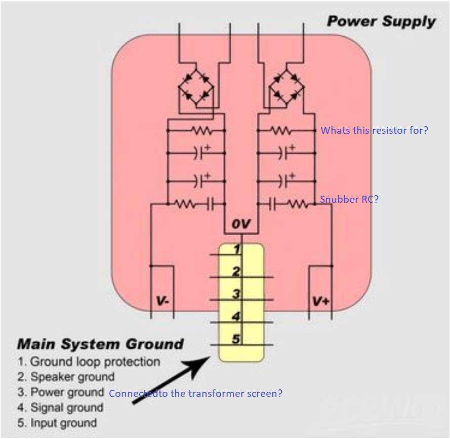

Morning gents,...once more some transformer/psu questions. See pic.
In addition: I assume all the mentioned ground connections are connected to the ground-lifter as stated in the wolverine docs or am I wrong?

1. Those are the bleeder resistors. I remember that they are there to discharge the psu large caps.
2. I never used psu snubbers, I don't know.
3. I remember that transformer shield needs to be connected to AC earth ground.
4. That star ground needs to be connected straight to the ground lift-loop breaker.

The bleeder resistors are useless. They would only be practical if a service technician opens the amplifier and then doesn't get a shock when he touches 70V. But you don't make the circuit for service technicans.

True, your amplifier boards will drain the Main PSU reservoir capacitors due to their idle current. However if there is a fault with your amplifier where one or more of the rail fuses blow there is a potential safety issue.The bleeder resistors are useless. They would only be practical if a service technician opens the amplifier and then doesn't get a shock when he touches 70V. But you don't make the circuit for service technicans.
I definitely recommend using bleeder resistors.

This article may help you with grounding the amp and it also includes safety tips:
