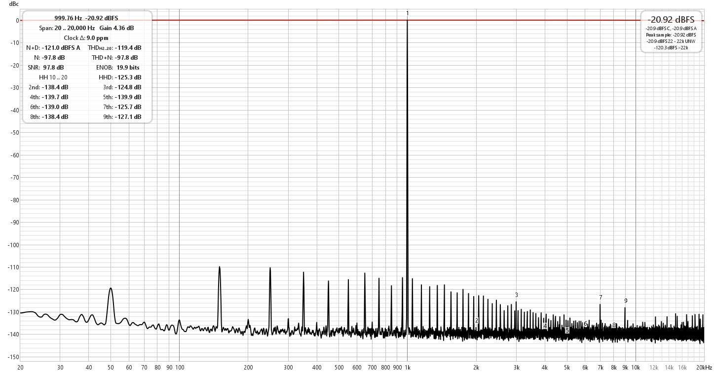

Yup.Ok Guys,
Just for a bit of fun here is a quick THD measurement for you:
Real Nice. State of the art even.
I've said it before and I'll say it again, power supply noise is the real problem. And by problem I mean makes an FFT graph look ugly. Put that same amp channel into your final use chassis, taking out those nice dedicated lithium supplies and measure again.
Exhibit A - 5w into 8 ohms, REW signal gen - E30II - Wolverine - E1DA ADC.
The PS noise is adding a combined ~20db above the noise floor. Not really a problem for me (amps dead silent on all my speakers). But maybe for 99dB+ efficient speakers. The HD in the graph is from the DAC and not the amp which is wild. But how to get a clean power supply? So far I've only read two amps do it, the benchmark ahb2 (SMPS - assume heavily regulated) and the topping LA90 (external PS). I cant even get cleaner with SMPS I have here.
I can see why its frowned on posting measurements like the above, its not a fair picture of what the wolverine is capable of. But its a more realistic picture of how the 99% of amps will be used.
Can someone start work on the wolverine of SMPS? Or linear PS even?

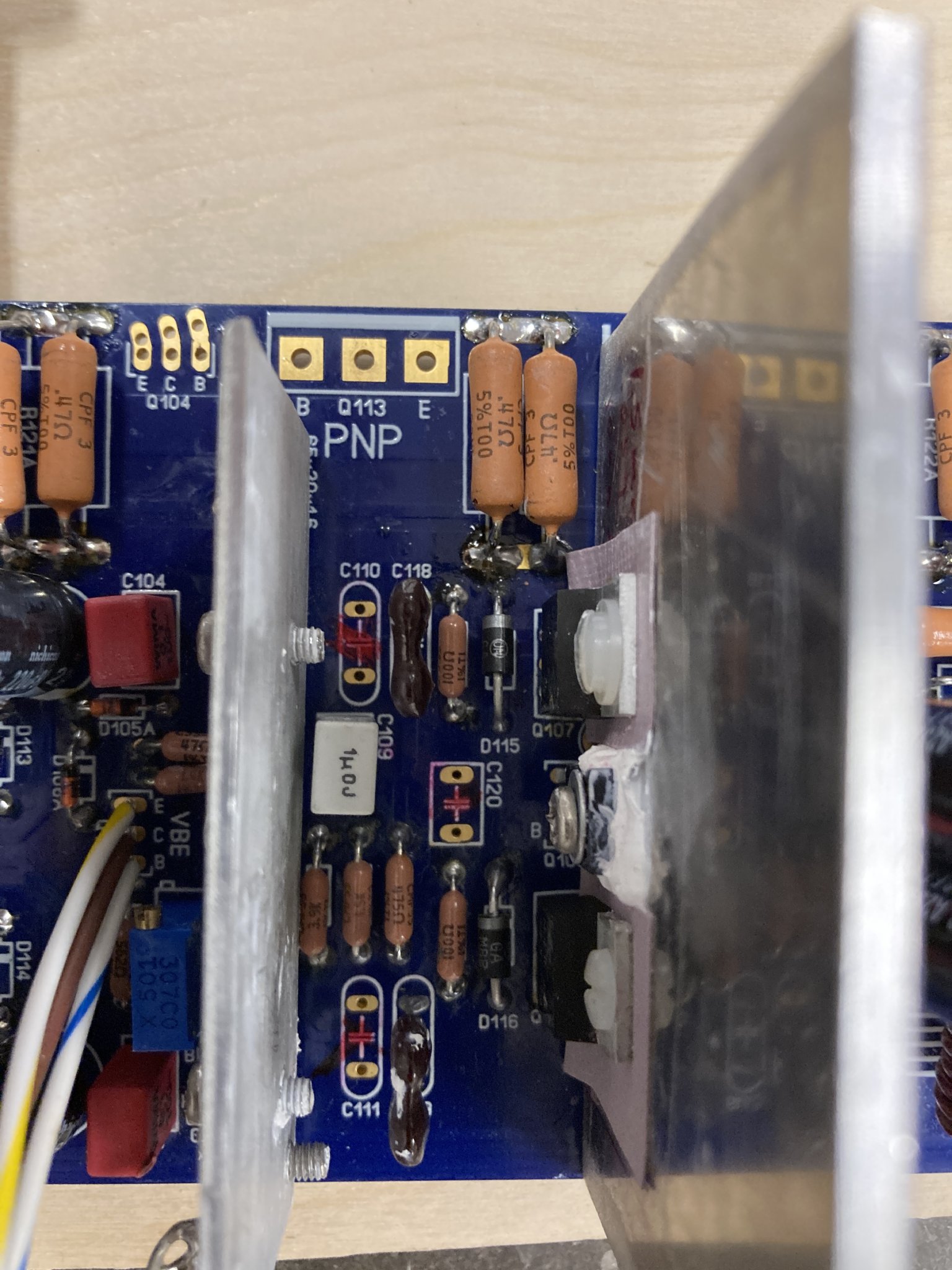

Hello Folks,
I am at the very start of my Wolverine build. I just received the diyaudio 5U chassis from Modushop. I have a question regarding the fabricated heat sinks for the IPS and Power boards. I purchased the EF3-4 boards. My question is can I use 3mm aluminum plate for all three of the fabricated heat sinks? I can source this material inexpensively in one go rather than ordering it, and then trying to source 1.6mm thick sheet from another supplier which is more expensive. I am aware that the thermal properties of the same material in different thicknesses is different. Please let me know what you think.
Many thanks,
John

No, 3mm is to heavy and to wide to fit in the available space and to hang off the transistor legs unsupported.My question is can I use 3mm aluminum plate for all three of the fabricated heat sinks
I see. That will allow you to tap all the heatsinks instead of using nuts too.

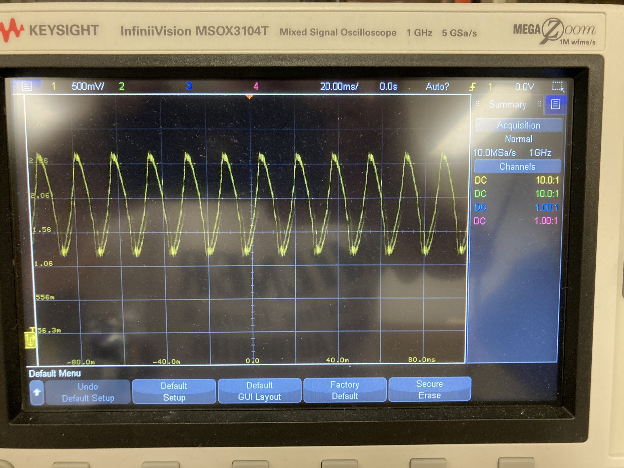

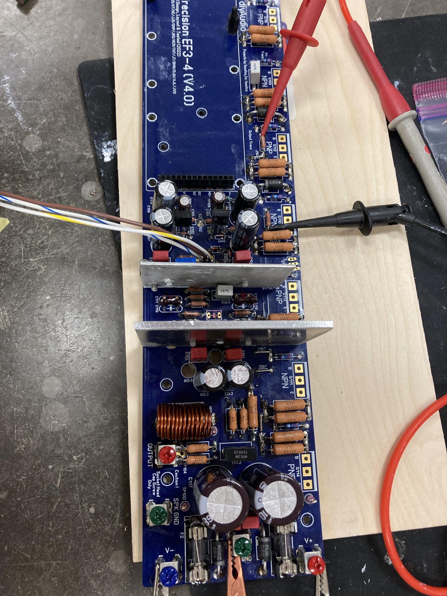

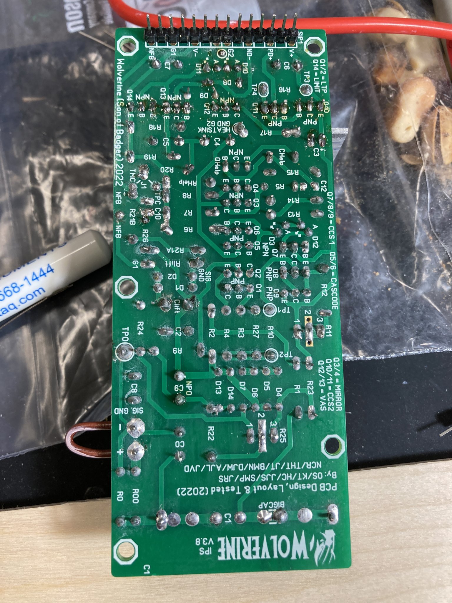

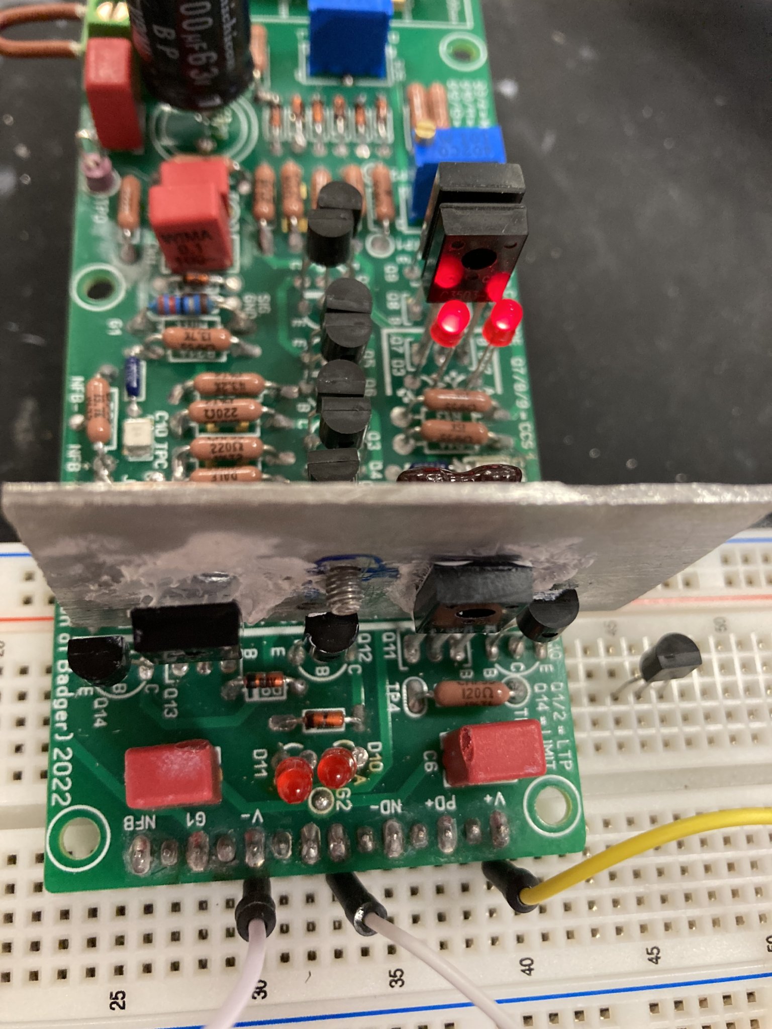

Hello all,
Sorry for these questions, but got a little bit of an issue with building the boards.
I had some issues with power (using bench power supply ) on the IPS board (ver 3.8) , I think after setting the bias the - and + got messed up on the breadboard and since then whenever I have negative voltage the LED's D10 and D11 light up, but as soon as I give the board + power D12 and D3 come on but immediately D10 and D11 shut off. I had to replace Q12 and Q14 since they were shorted emitter to collector , as well as changing C3 since the cap was only reading 6uF instead of 10uF. The board still measures 5V across TP1 to TP2 even when the transistors were bad.
Everything else looks ok as far as I can tell, and the led's looked ok before when I put it onto the bread board previously. Just had a couple cooks in the kitchen and got things messed up a bit. The picture is with both the + and - voltage at 25 V and .005 amps.
Also, on my second set of boards (IPS 3.8 and EF-3-4 V4.0) I have tried to check the output (using signal generator at 1kHz and 100mVpp and when ever I put the ground on the speaker output the sine wave goes flat. I did not see anything wrong, and I did not want to try it with the output mosfets since the sine waves are so weird. Not smooth but kind , almost sawtooth. I did set the resistance on the POT on R109 to 485 ohms since it would not go up to 500ohms
but yet still getting full voltage (voltage that is from the power supply) between R111A and R111B
The oscilloscope image is of the board without the ground of the oscilloscope attached to anything as it just goes flat.
Sorry, for being long winded and not sure if I have explained enough.
But appreciate any insight. Thanks!!!!
