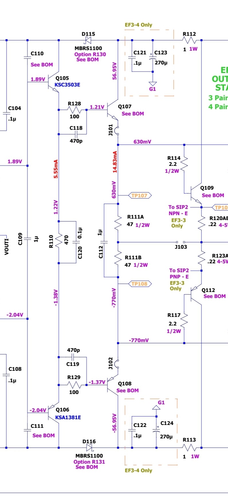

In terms of matching, I was following the advice in this post #3476
I think I just confused myself and added Q7 & Q8So you're amplifier will preform just fine if you don't match anything. But if suggest that you look at my list below and consider matching the transistors shown. How far you go down the list is up to you.
1. Q1, Q2
2. Q3, Q4
3. Q5, Q6
4. Q105, Q106
5. Q107, Q108
6. Output Transistors
You be fine with KSC3503DSTU and KSA1381ESTUOk, so just buying KSC3505DSTU will be fine with the KSA1381ESTU I already have?

How closely do Q106 and Q105 need to be matched, if at all? Apologies, I am just confused by the list I referenced and recent comments.

Q105/106 is not that important. There will always be some Vbe difference between the junction at PNP Vs NPN. You might succeed in finding pairs that match Vbe quite good between polarity if your are really into this matter. As for the HFE, the D vs E-versions shows same figures in the batch I have as posted here in post #3780, approx 85 vs 120...
The differential pair is the most important to match if I understand the schematic correctly.

I don't really agree with that.Q105/106 is not that important
Mismatched HFE values lead to unbalanced gain between the transistors that handle the positive and negative halves of the audio signal. This imbalance will cause increased distortion as the asymmetric amplification can skew the waveform of the output signal.
Imagine that the amplifier had no negative feedback the positive and negative half's of the waveform would be very different.
So your asking the negative feedback to fix the issue.
This is generally not a problem with an amplifier like the wolverine at low frequencies but as the frequency increases, the effectiveness of negative feedback (Loop gain) diminishes due to phase shifts and timing delays within the feedback loop. The loop gain, which is the product of feedback factor and the amplifier gain, decrease with frequency. When the loop gain falls, the amplifier’s ability to correct errors (like those caused by the mismatched HFE) diminishes. This effect is more pronounced at higher frequencies where the amount of loop gain may not be enough to adjust the distortions and imbalances effectively.
Having said all that. I wouldn't get to concerned if you can match them as the amplifier will still preform very well.
This is true for stages that cut-off (the driver and output stages in the Wolverine), and becomes less true for stages that run in class A (the pre-driver and earlier stages).stuartmp said:Mismatched Hfe values lead to unbalanced gain between the transistors that handle the positive and negative halves of the audio signal. This imbalance will cause increased distortion as the asymmetric amplification can skew the waveform of the output signal.
Because the pre-driver stage does not cut-off, the NPN and PNP both load the VAS for the entire cycle. The pre-driver's Hfe attenuates the non-linear current drawn by the driver. The effects of Hfe mismatch in the pre-driver will be small.
Since I like to point out what my amplifier does better - I run both the pre-driver and driver stages in class A. This has the lowest possible sensitivity to Hfe mismatch (while still having a class AB output stage). Minimizing distortion in the EF3 matters more when the global feedback is moderate.
