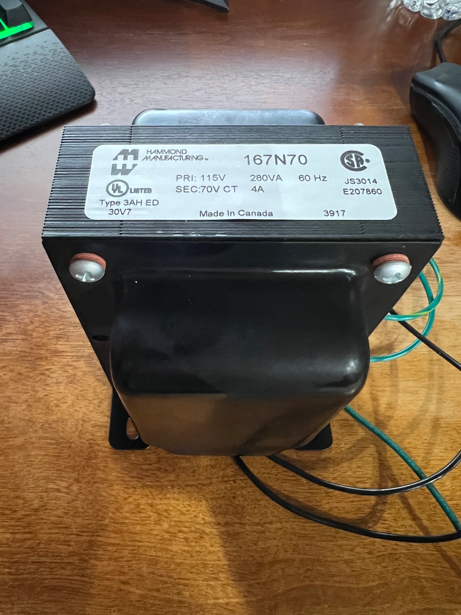

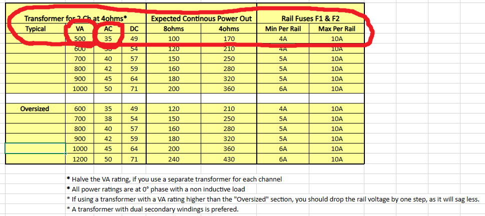

Easy to see why dual secondaries are preferred then. So how would that effect the amplifier and/or output? Just more chance of 60hz hum, or 120hz / 180hz hum?
It should have a positive effect on the S/N ratio, in some cases more then others as different amps have different PSRR and ripple rejection. Next to the already mentioned slight drop in rail voltages there is an other matter to observe, in case the secondaries do differ, the positive and negative rail voltages will be slightly out of balance. The DC servo or conventional offset adjustment is usually capable of correcting the consequences of this. Enough for now, lets not make this side step to complicated.
Nice info. So seems if someone has a good center tapped existing suitable transformer, no need to source a dual secondary one instead.
280VA really isn't much for a stereoset, even at 50VDC rails. For an 8ohm load maby, but into 4ohm I'll guess the amp will clip due to the transformer giving up before the outputs itself.

Ok. I didn't spot this when reading the thread🙂ONE 280va 2x35V transf.for ONE channel.
NOT for stereo.
