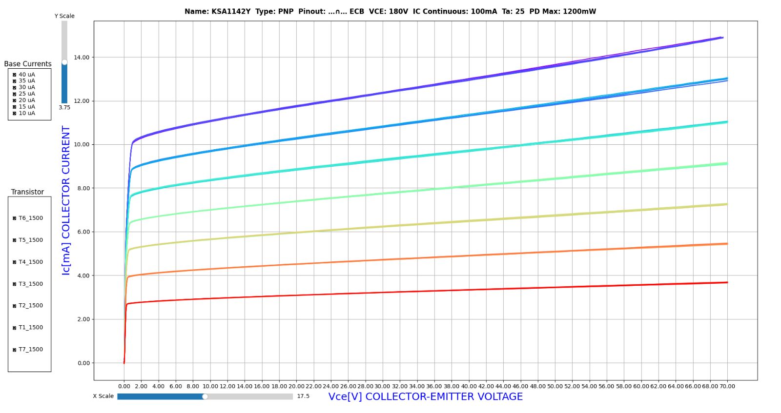

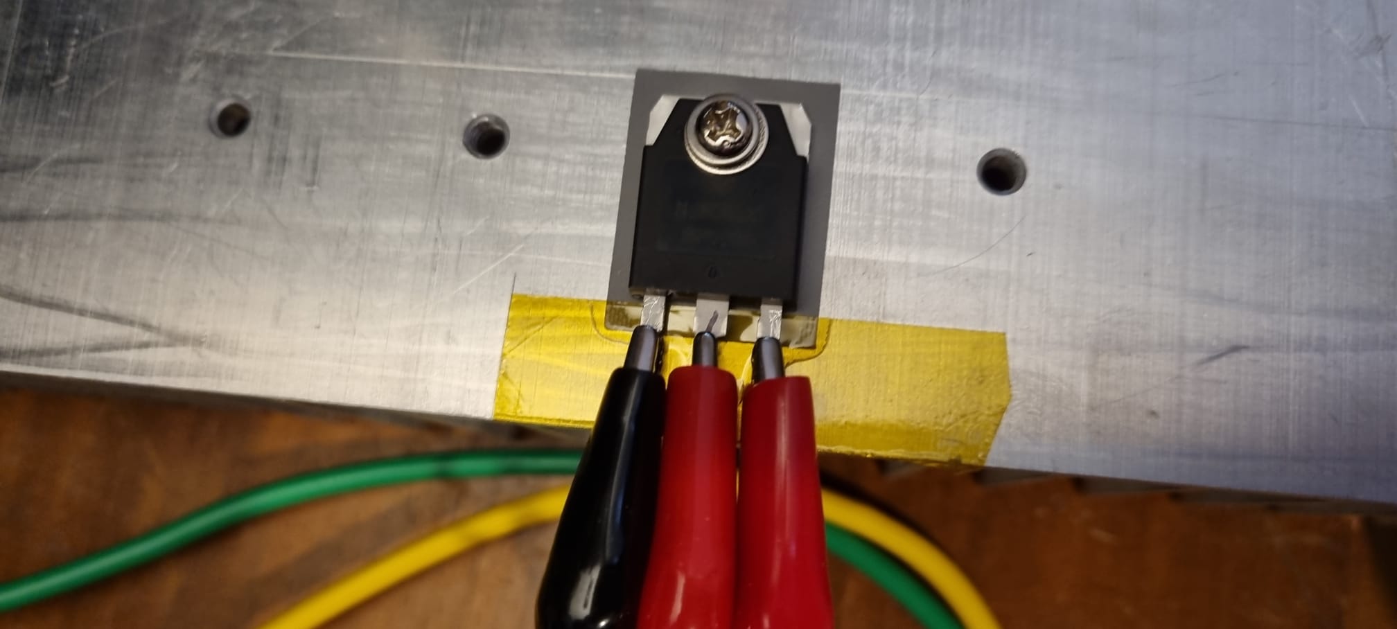

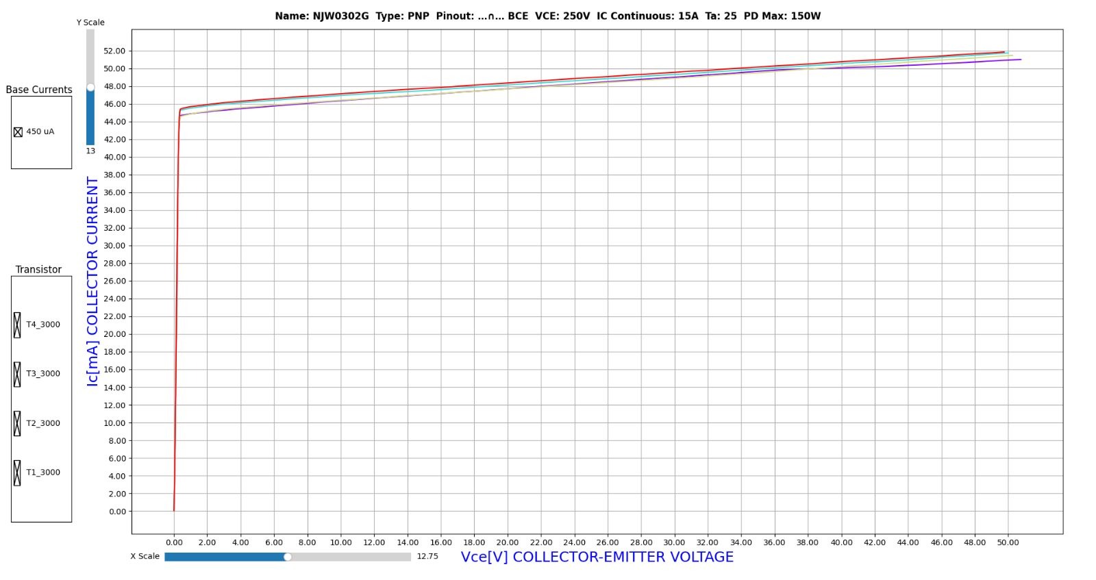

@fireanimal @danieljw and I have designed a built our own fully programable dynamic current tracer. It can curve trace small signal and output transistors.Stuart how are you matching those higher power transistors?
Please give this to us 😉@fireanimal @danieljw and I have designed a built our own fully programable dynamic current tracer. It can curve trace small signal and output transistors.
I'm afraid it's a device you connect to an oscilloscope or computer having compatible oscilloscope application installed. I bought a tracer device long time ago to match mosfets. I should still have it somewhere but have only a vague memory how to use it.
Of course one can build such a device having it's circuit diagram.
I am of course biased, but I can say that it works very well. It's in the public domain, so anyone can use it. More here:What do you think of PyPsuCurvetrace, the Python script developed by @mbrennwa for transistor curve tracing using two programmable PSU?
https://pypsucurvetrace.readthedocs.io/en/latest
Accuracy is determined by the accuracy of the meters in the PSUs. If that's not enough, you can specify your own calibration to pypsucurvetrace.
One cool aspect is that pypsucurvetrace allows controlling the temperature of the DUT, which is crucial for testing of power transistors.

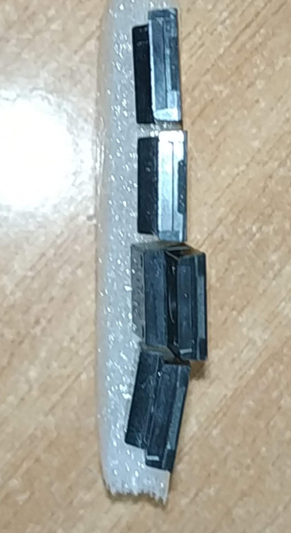

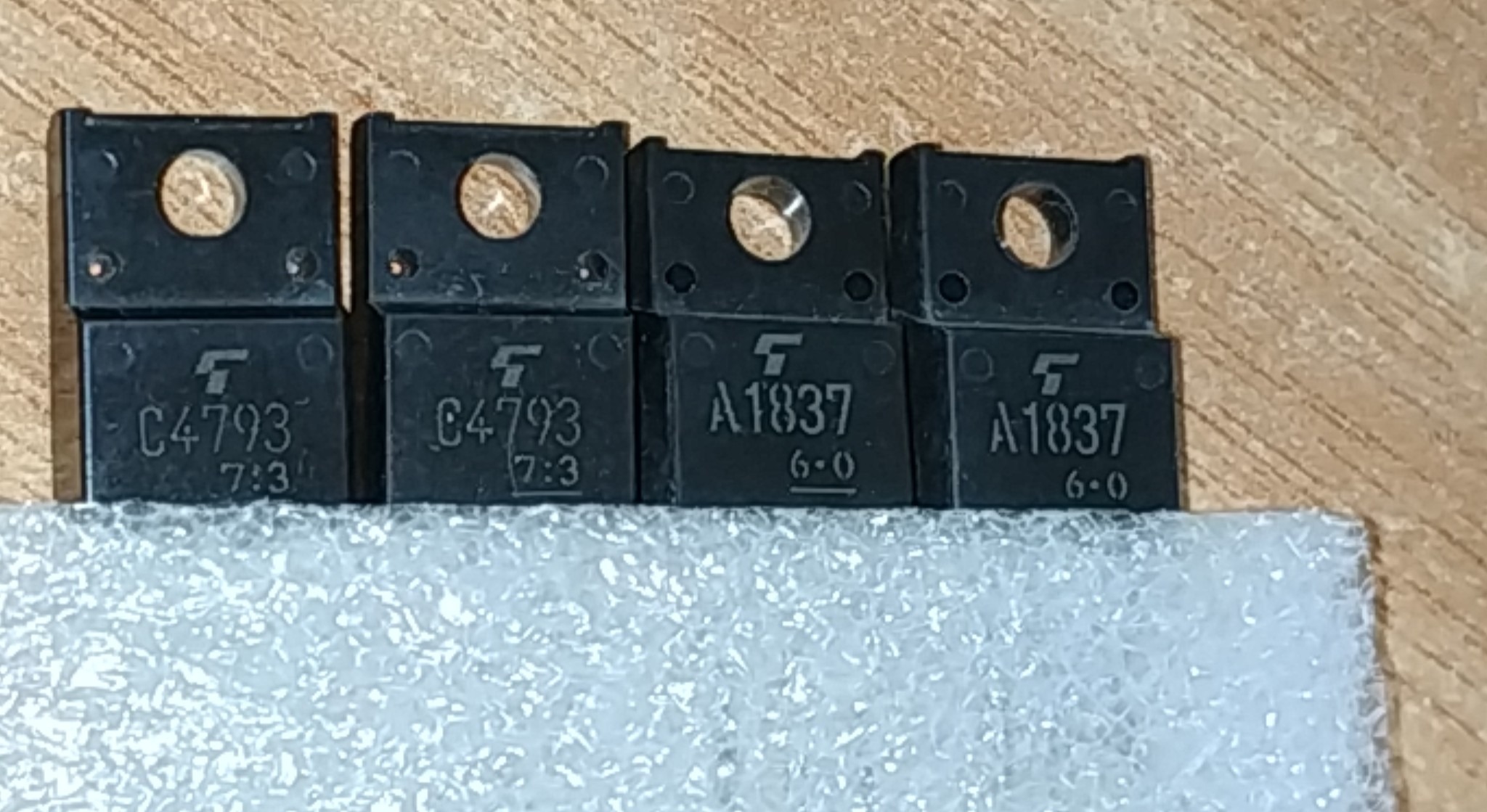

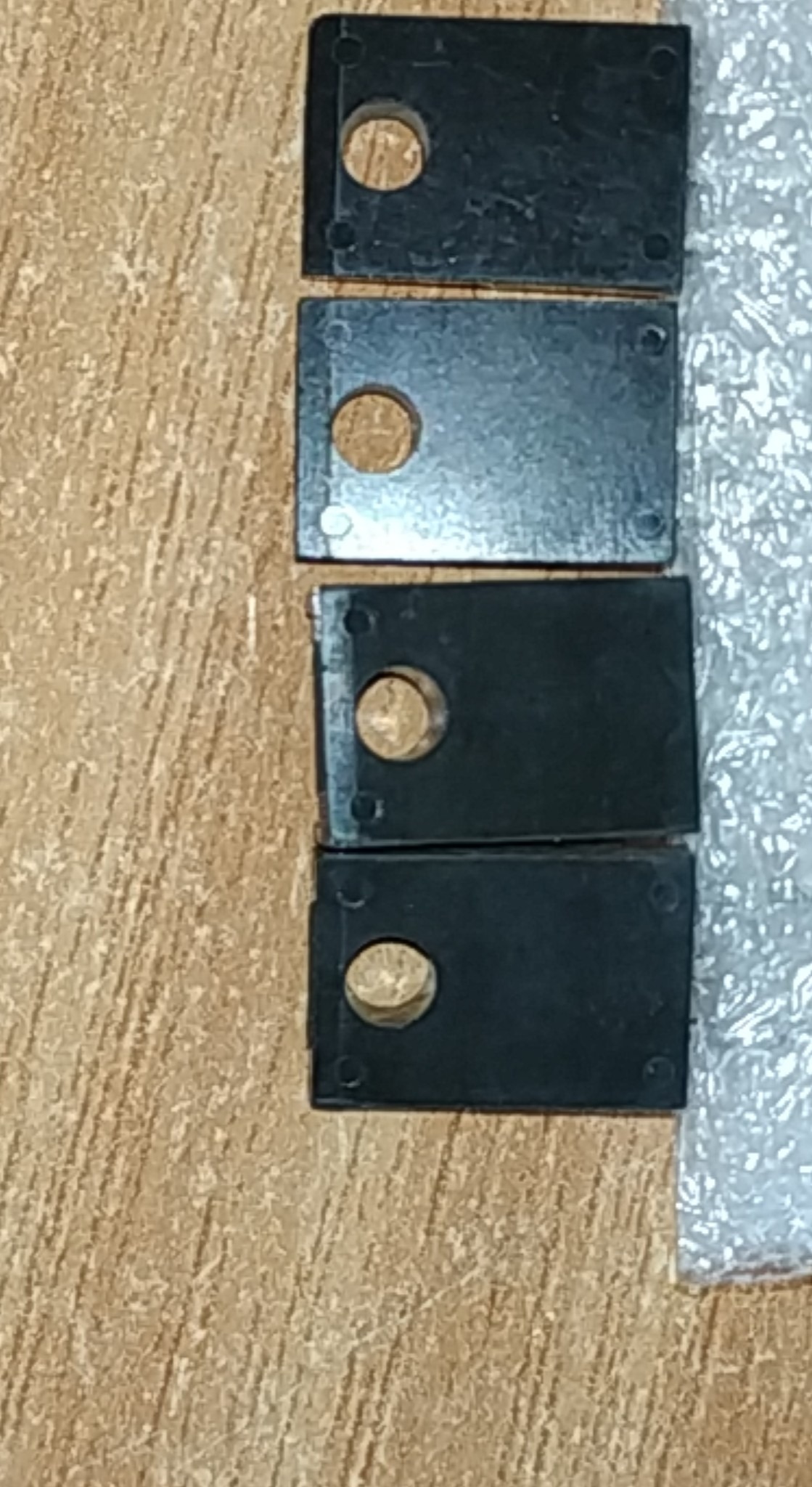

Μy new drivers have arrived
We'll see if we hear anything different about them
to Mje15034_35.
to Mje15034_35.
I went the other way (from 2SC/2SA to MJE32/33) interested what your listening impressions are.
