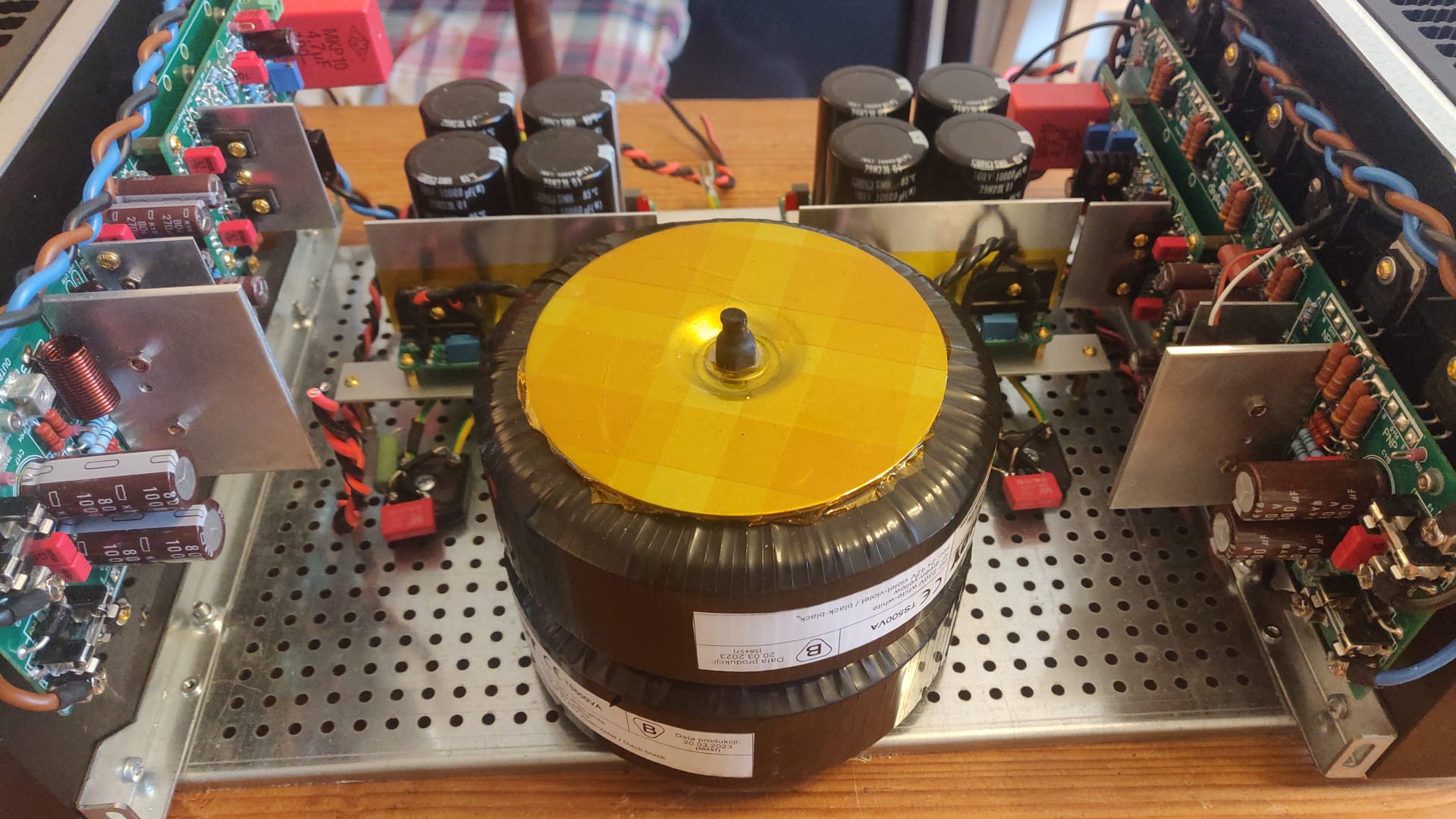

Hi my friend BillNikos,
I like the way you bent over the heat sinks, did you just do it in a vice? I am reusing a case and will be a little cramped. I hope there is no negative reason not to. Bleader resistors are great during build and testing, I like to take them out when putting them into service and eliminate one more heat source inside the case.
Bill

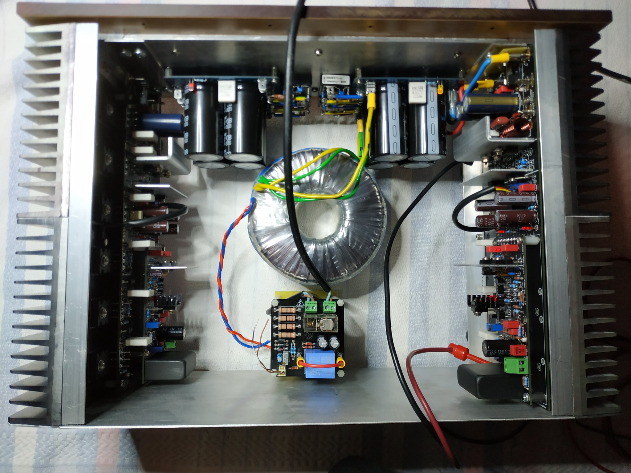

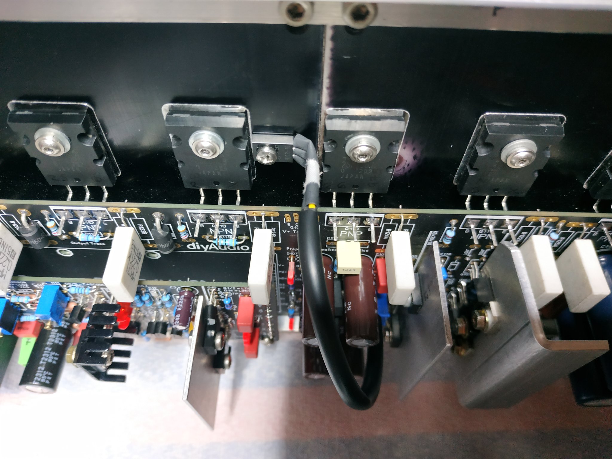

I turned these small aluminum pieces at right angles in a large industrial machine
Thanks for your kind words.
BR Nikos
Today I'm watching the behaviour of bias current.The position of the Q104 its critical for me i have small heatsinks and big testing voltages +/-70V.i think to put the transistor Q104 over the output transistors its not good Idea....i prefer the heatsink between Pnp and Npn transistors.

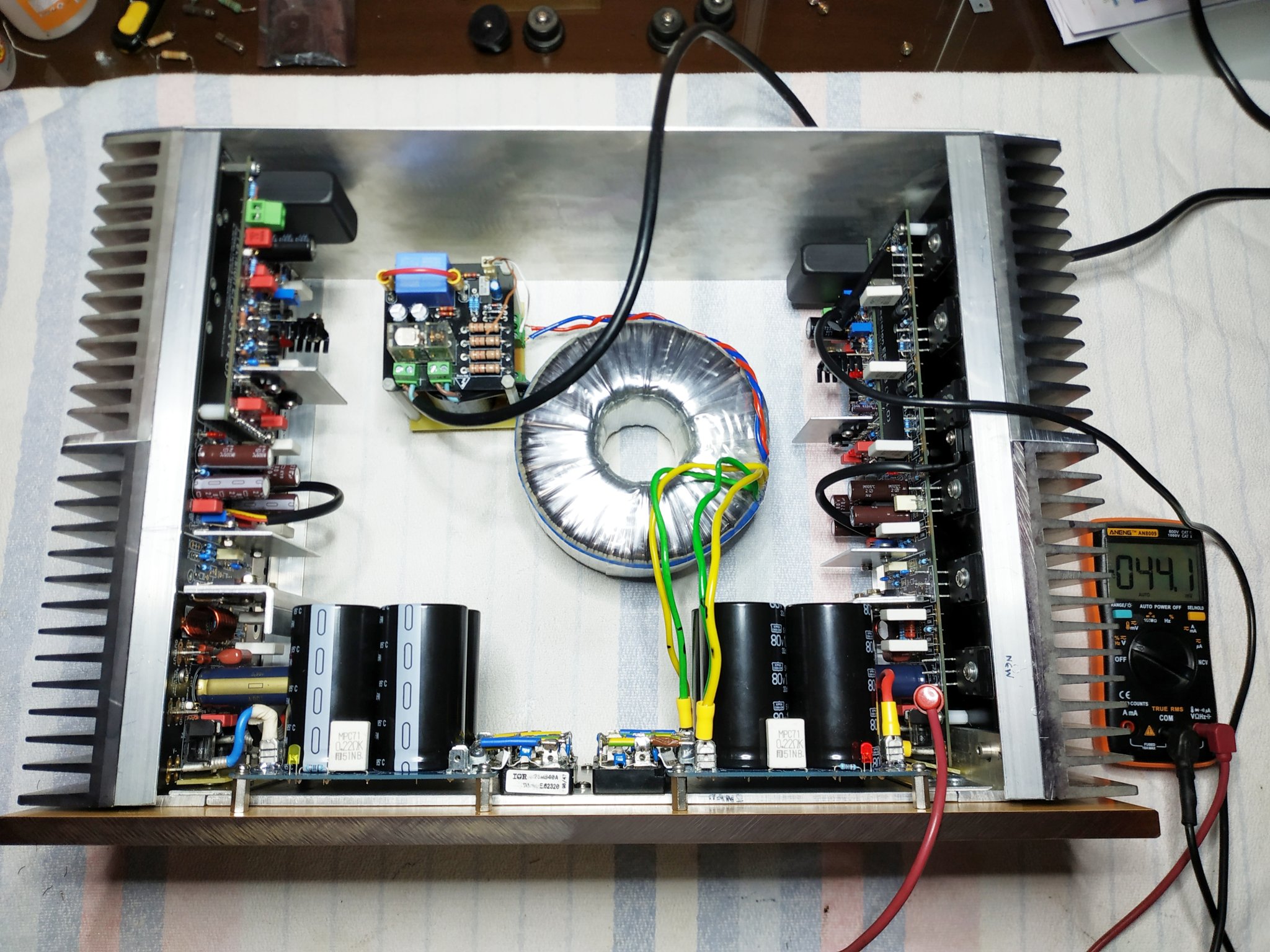

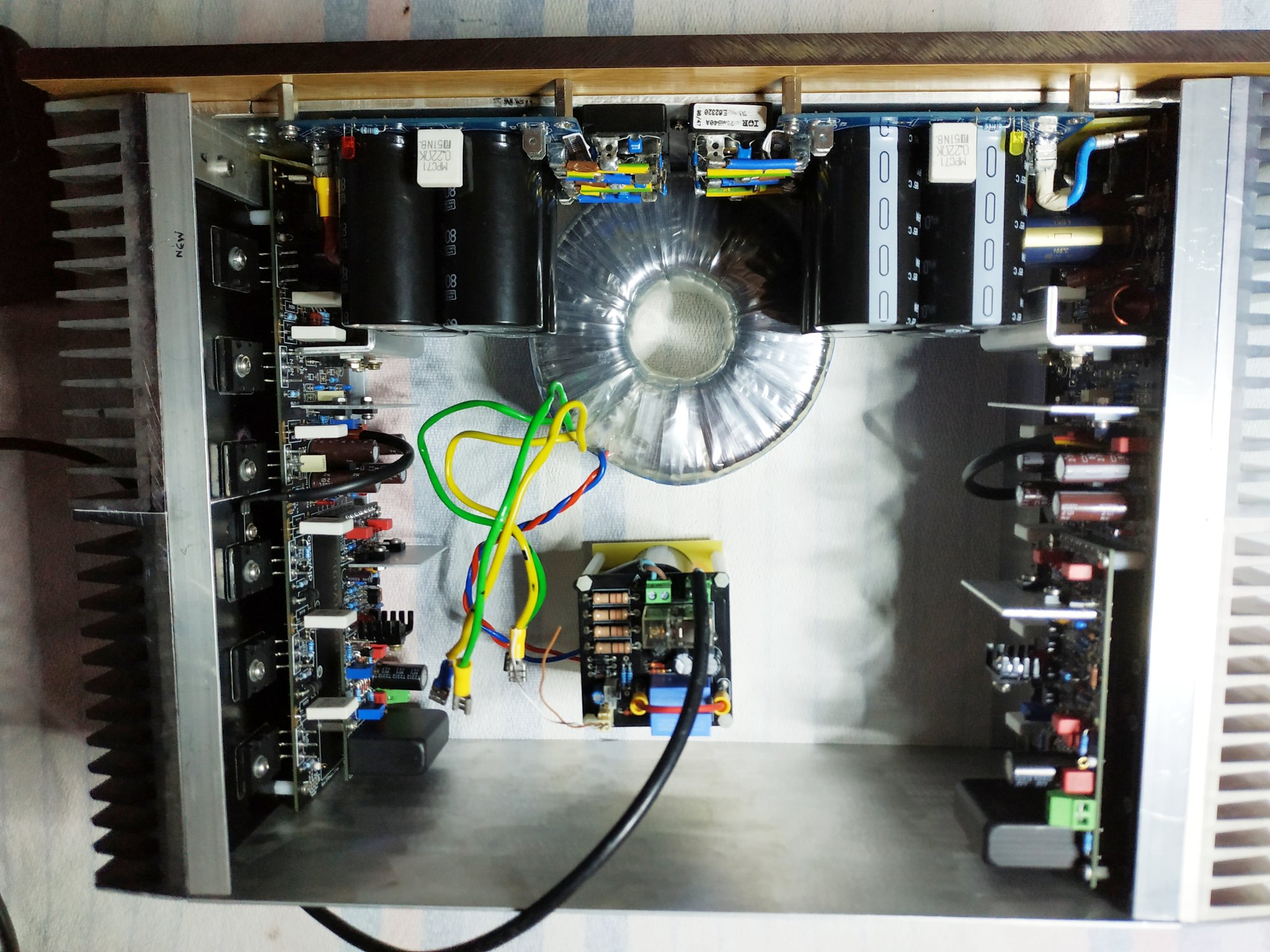

I will give you a tip though, twist the power supply lead rather than plait them and maybe use some sleeving on them.
Also run the dc psu wires on the side of the heatsink which has the output transistors like in the right hand side of your picture above
This keeps them away from the very sensitive feedback trace.
Your build is going great by the way, it will be worth it
Hope this helps,

Αfter hours of monitoring the bias current I concluded as follows. The best placement of heatsinks is with the transistors down, this way the heatsinks perform better ..unfortunately with this way one input will have to go from the side of the transformers..

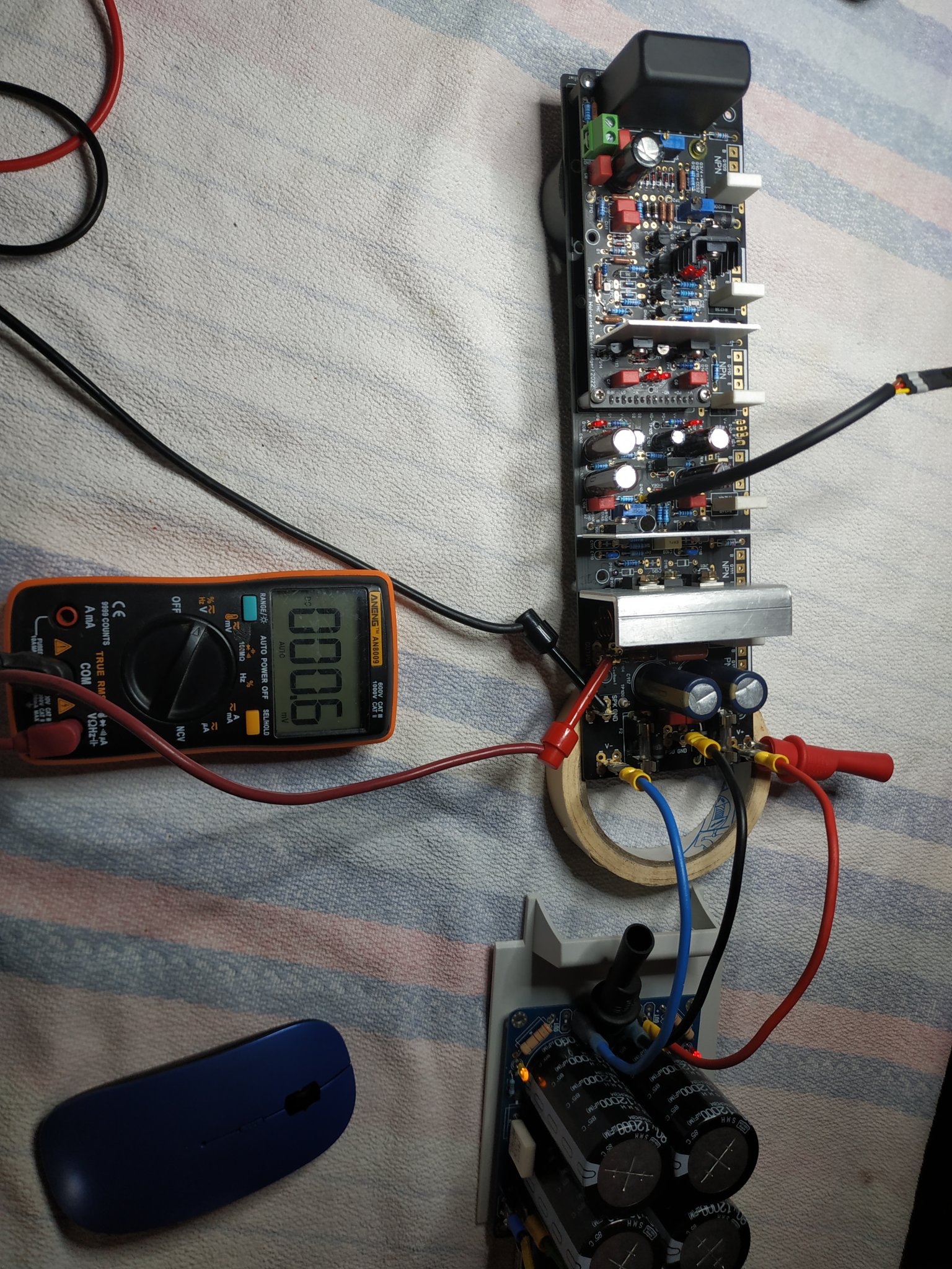

ii. Measure the AC voltage in millivolts across TP104 (output) and TP100 (Speaker ground) ideally this should be less than 0.080 mV. If this value is greater than 1 mV and depending on the sensitivity of your speakers you may hear a small amount of hiss coming from your speaker’s tweater.
My measurmetnts show me about 0.110mV and 0.130mV

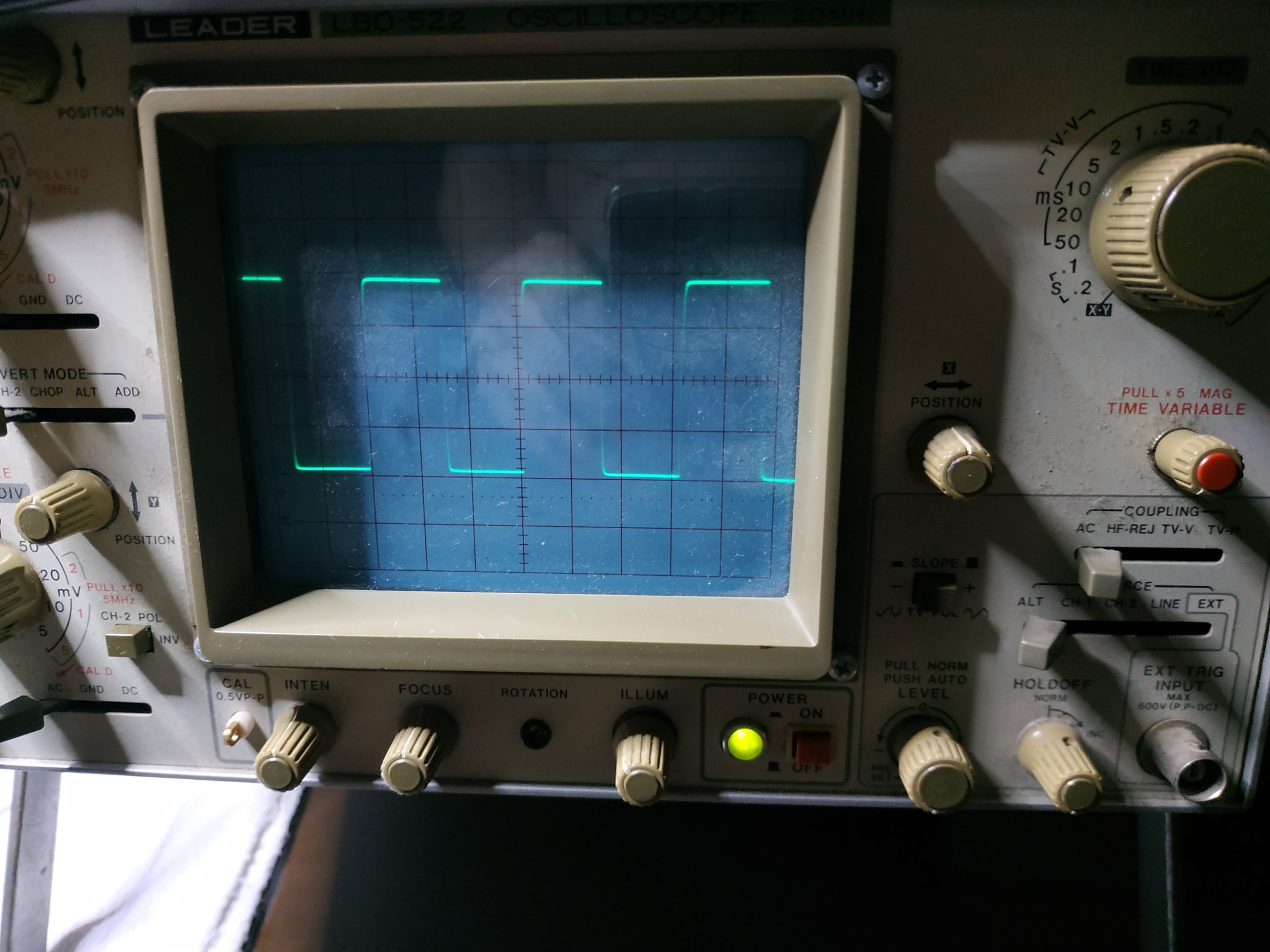

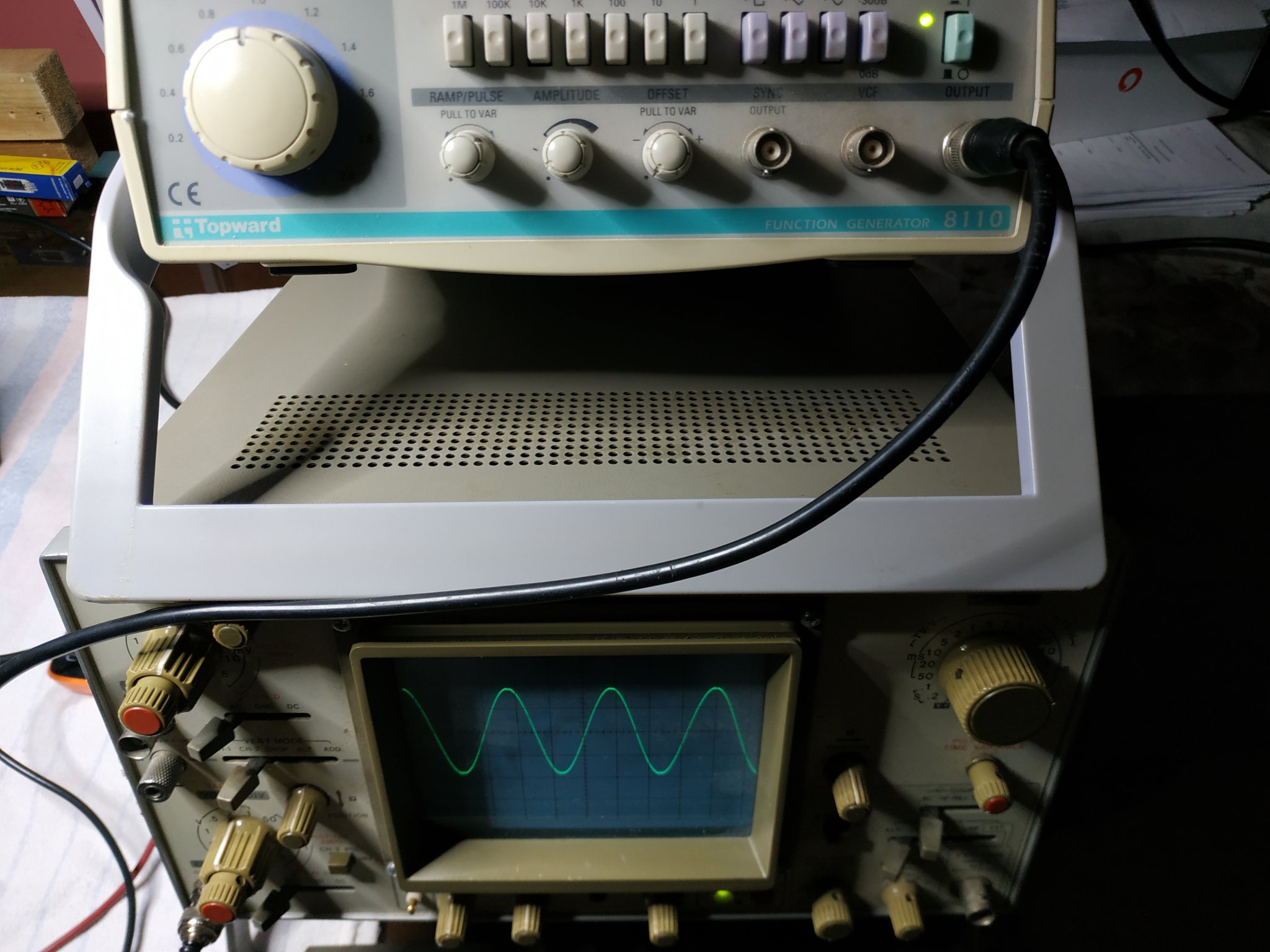

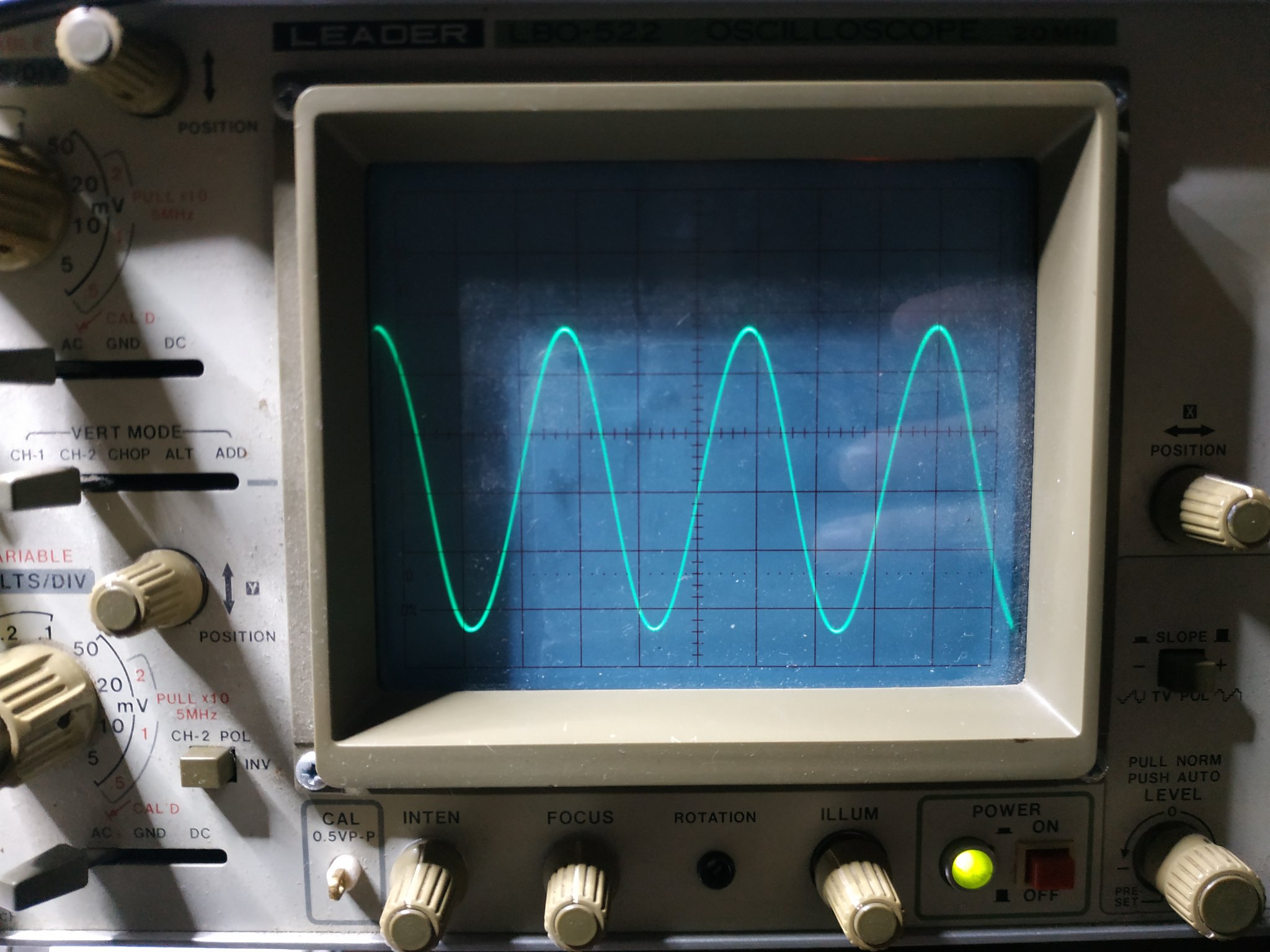

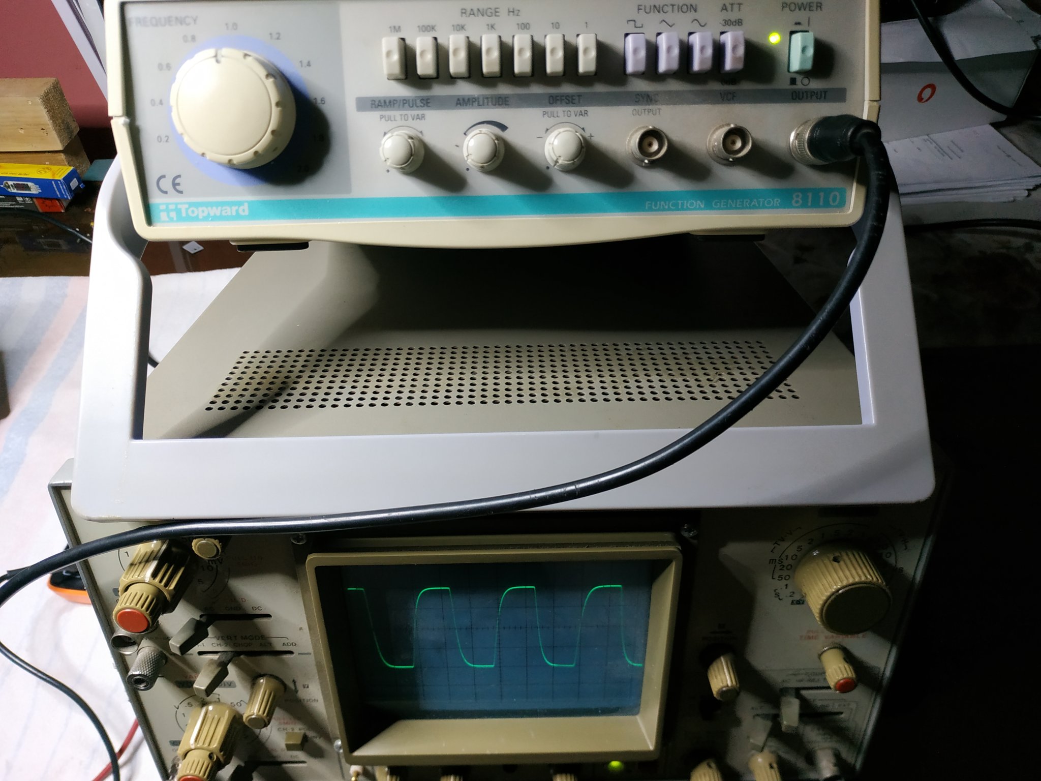

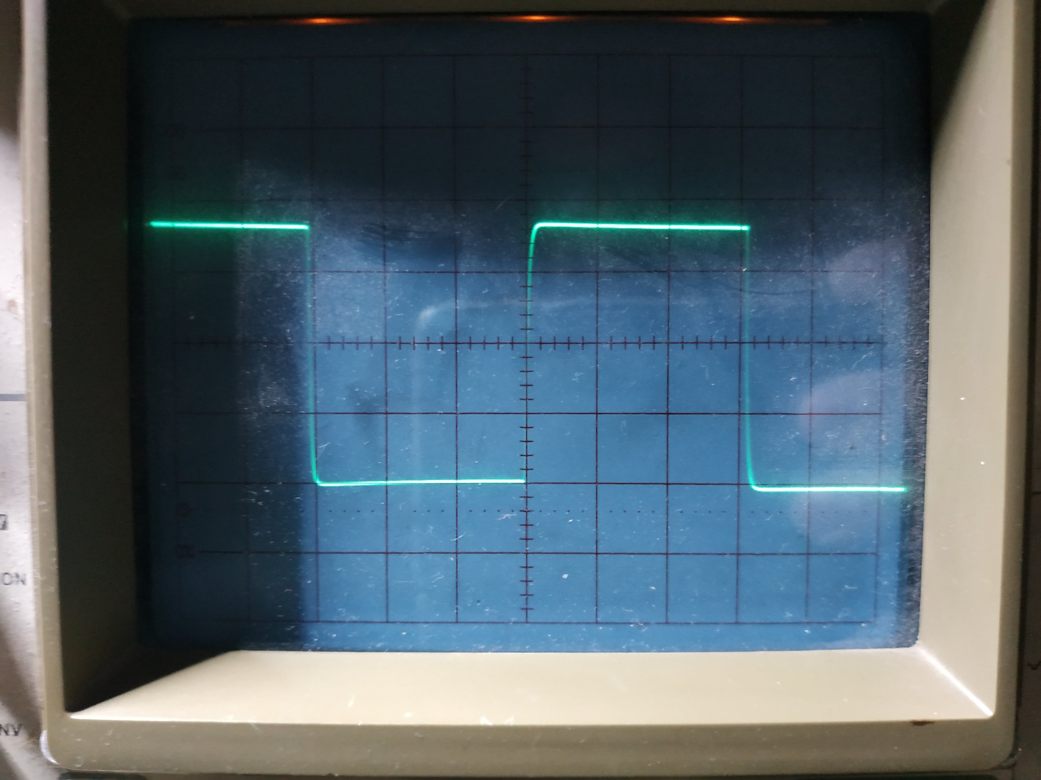

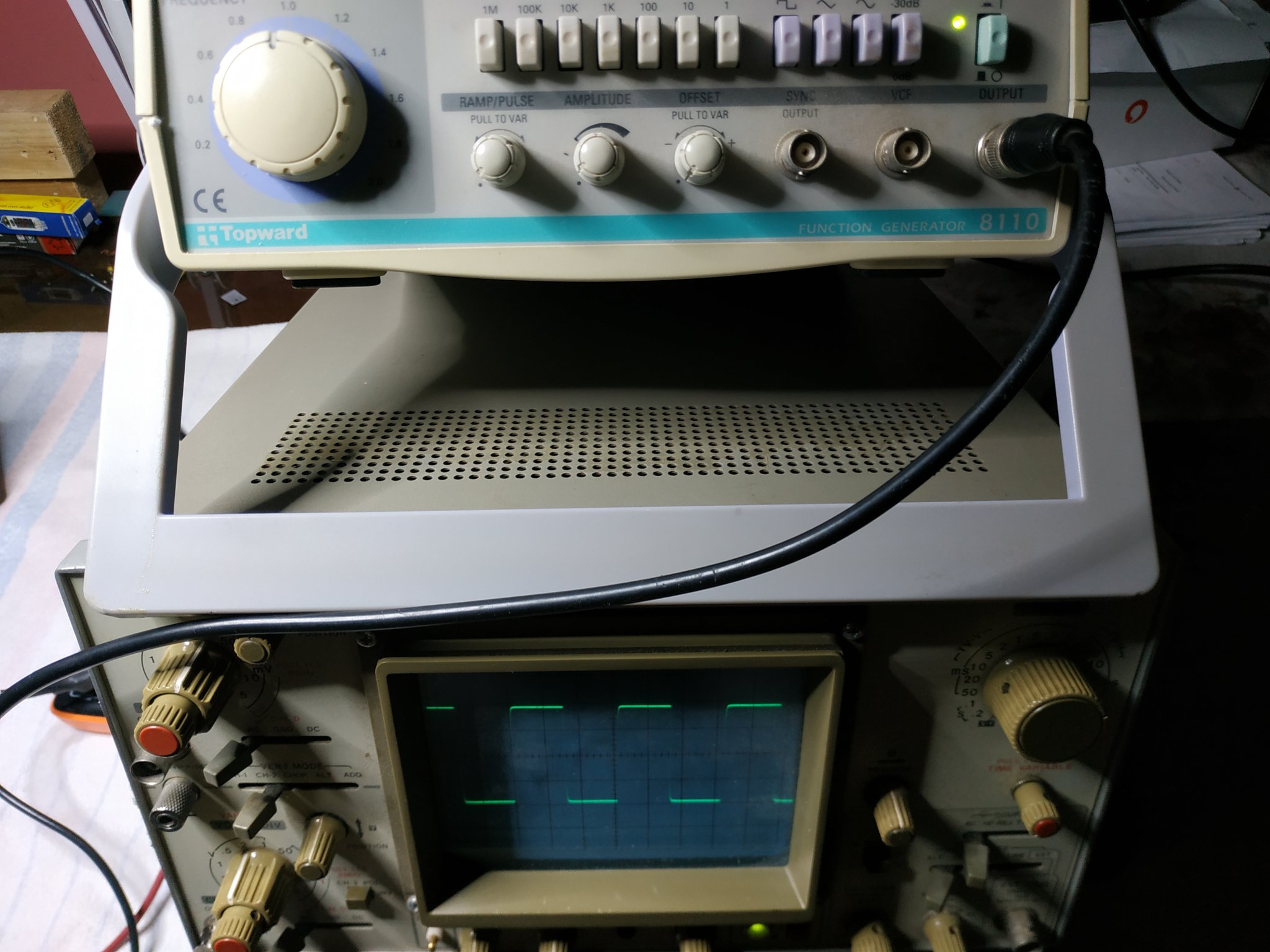

Very nice...10khz sine, 1 khz square , 1 khz sine , 10 khz square .NO LOAD
@stuartmp
Ιt's still early for music, I'm not in a hurry, other tests with load and capacitor will follow. Besides, the power supply must also be changed. The transformer haha is borrowed from the Mimesis 9.2 clone and is also large in voltage of 2x50 AC volts, but so far everything is fine ....

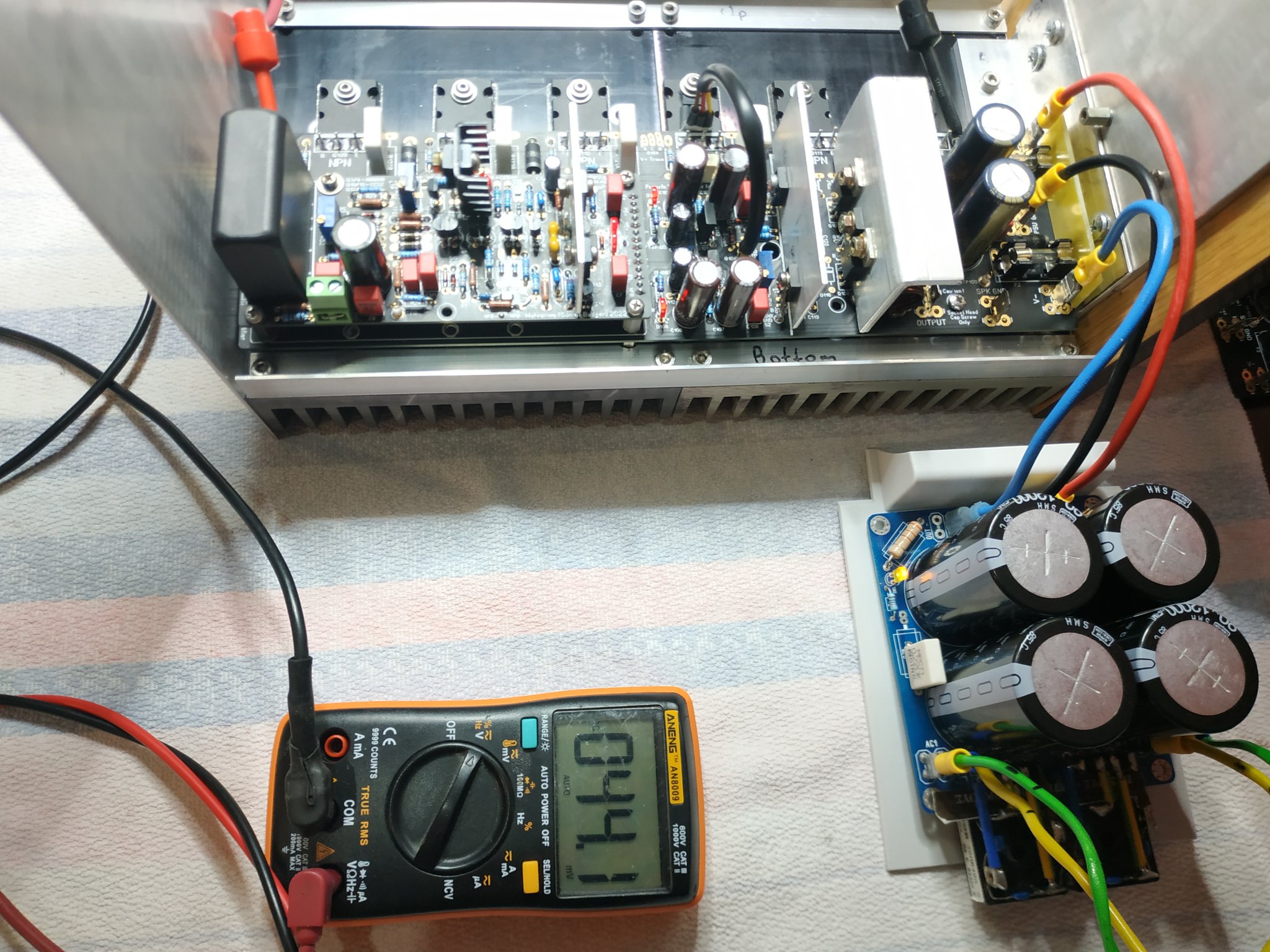

Certainly the quiescent current does not stabilize at 44 mv (100ma per transistor ) as expected with the volts +/-71V applied to related to the limited heatsinks I have 40mm 155mm 280mm . The new circuit with Q103-104 BD136S shows that it works very well and actually stabilizes the quiescent current at 32mV on this heatsink with the transistors down....the other module stabilizes the quiescent current at 29-30mV transistors up. ( Ambient temp 26-28 C and temp on heatsinks about 42-43 C)

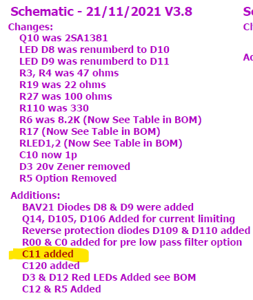

Can someone tell me what the value of C11 is? On the IPS schematic it says "see BOM" and on the 4 BOMs I have there is no C11 listed part. Additionally, when I look at the notes on the schematic, it says it was added on 11/21/21 but again no value notated that I can find.
Thanks for the help on the grounding and support pins for the HS.
