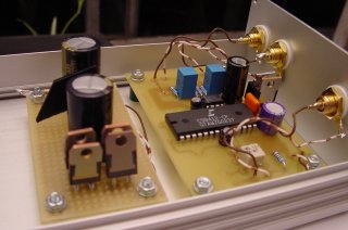

Then, once finished, we'll be be able to focus on a nice DAC like the Nonoz II 🙂 There's even a tube version of this DAC !
