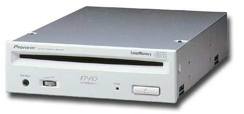

@rikkitikkitavi:
Just opened my PC to get the drive powered. Dropped a CD in, plugged the headphone in, and... it's working without any problems.
Although the drive is not very noisy at all, it seems to run at a much higher speed then 1x when playing an audio CD.
And: it sounds awful . This of course shouldn't be the transport's fault but the unbelieveable bad headphone amplifier...

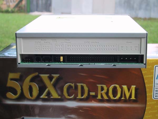

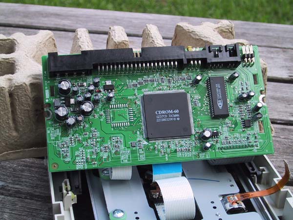

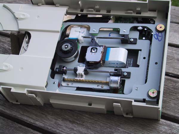

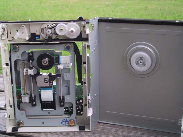

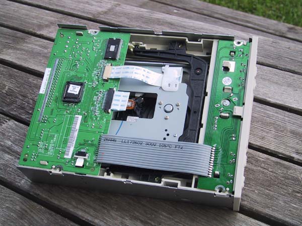

CD-ROM drive
Hai all,
DJ,
Did we all agree about the programming language? Not that I'm aware off. I still feel for a higher programming language. Maybe use assembly for the time critical parts. For the first phase of this project speed is not really an issue. Maybe only for the Infrared part. Is it a good idea to start programming in pseudo code first. First setup a basic flowchart for the program and than fill in the details. That way it's possible to split the programming part into small chunks so different people can work on the same project at the same time. Also modular programming makes it possible to add functionality to the program without rewriting everything. Than when the project finishes, if ever a project is finished, you can add or delete modules depending on what you want with the CD-Player.
Holger,
Your drive looks quite similar to mine (Samsung 48 speed). I inserted a disc without the top cover on the drive and the disc was launched through the room. When I pressed on the disc to keep it from launching I noticed that the drive motor is strong. So a clamp should be possible if we can initialize the drive to run at 1x.
