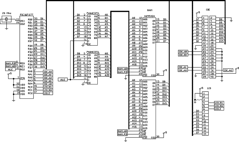

4bit Display
Sorry, we probably can use 8 bit display mode as we will have the entire bus anyway.
here is an example:
While this shows a pic, I think it does show the bus(es) and even with ram buffer. This picture is from this site:
http://www.barrymichels.com/ide/
here is an example:

Looks like our friend have just found the perfect platform for our little project...
