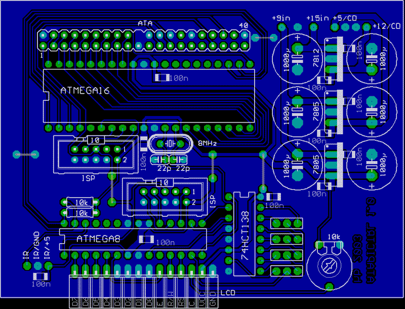

If you would like to go with the Atmels, you may have a look at my (redesigned) prototype board. You can download the design files here:
http://www.hb001.de/atapictrl1_0.zip
The archive contains schematic, 600 dpi board layout (PDF, single sided) and stuffing guides.
It works with two controllers (as stated earlier), allows the connection of 8 switches, a standard LCD can be directly plugged in, a connection for an infrared receiver, power regulators for the circuit and the CD ROM.
I haven't built it yet, perhaps you might have a look and tell me where the errors are - there should be several.
This is how it looks:
Nice work Holger. I'll give it a good look this afternoon and let you know if I see any mistakes.

I agree with Elkaid, and the idea of using PC RAM (that I do have lying around) still looks promising, so the DS89C420 is still on top of my list. I might change my mind though, if Holger's PCB is as good as it looks, and if I can get Atmel chips over here.
What software did you use to do the layout?
