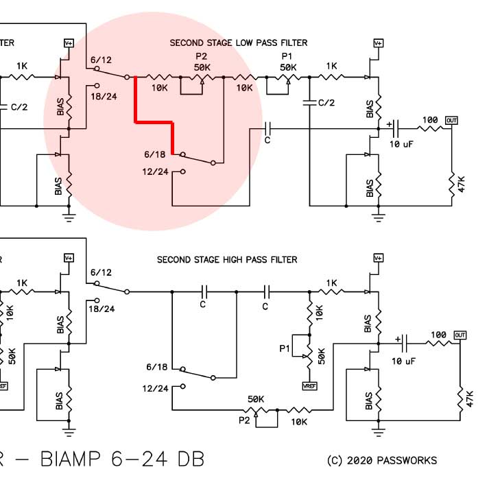

Isn't the schematic missing this connection? I hope it didn't propagate to the PCBs.
That connection is NOT present on the PCB. If one selects a third order filter, the calculation must include the superfluous resistor and pot values. It is also possible to short the resistor and/or pot, but then the flexibility of eventually selecting fourth order is compromised. I did it and it's not difficult to revert to stock. I wonder if this was an error, or was simply impossible to implement in the board layout, which is already a marvel of design.

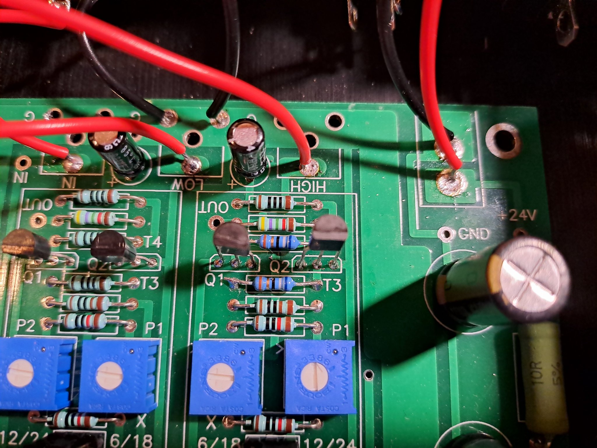

I've been trying to track down strange sounds from the right channel high pass section of my crossover (posts 1,203 and 1,560). At first I thought it was the jfets; replaced them all. Problem not solved.
It turns out that four of the biasing resistors were the wrong value (100 ohm instead of 68 ohm). I stupidly didn't check them before installing (since they came matched to the jfets, I didn't know what value they should be, and the bands were all the same). And by an incredible coincidence they all ended up in the same section of the board (the offending channel). They're now replaced. However I now have a new problem. Out of the circuit they measure 68 ohm. Once installed, two of them still measure 68 ohm; but the other two measure only 50ohm. I take them out: 68 ohm. I put them back in: 50 ohm. They're at the position shown in the attached photo.
Why would this happen? Every other biasing resistor on the board measures 68 ohm. And is this a problem? Just to be sure I replaced the two jfets they were biasing, but that didn't change anything.
Could the board itself be faulty?
Any help gratefully received!
