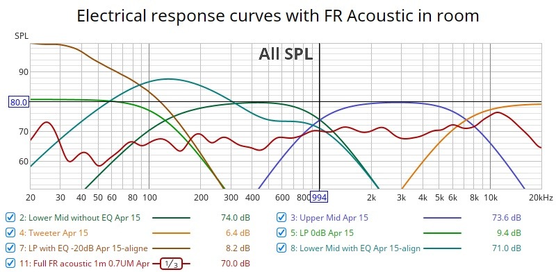

I've attached my latest Electrical and Acoustic measurements for 4-way dipole ASP modeled on SL's LX521 original spec, but a very crude and non-optimized variant, while still based on his XO points @ 120, 1k,& 7kHz LR4 as a starting point.
I improved my Subwoofer to Lower Mid cross by extending the Shelving Low Pass on the LM to 30-400Hz with an added Notch filter @580Hz which has
the effect of steepening the EQ as required (see SL's notes on this https://www.linkwitzlab.com/models.htm#A2).
I'm fairly happy now with the measured in room response, which remains largely within a +-6dB band (outside measurements should be better). Sound now has more pressure punch from the Lower Mid which was previously lacking.
The seven curves are;
4 electrical curves establishing the 3 crossover points (no EQ)
2 additional electrical curves showing the EQ on the Subwoofer and Lower Mid
1 Full range Acoustic measurement at 1m in-room.
added LTspice sim of SLP & Notch with DIY Front end
