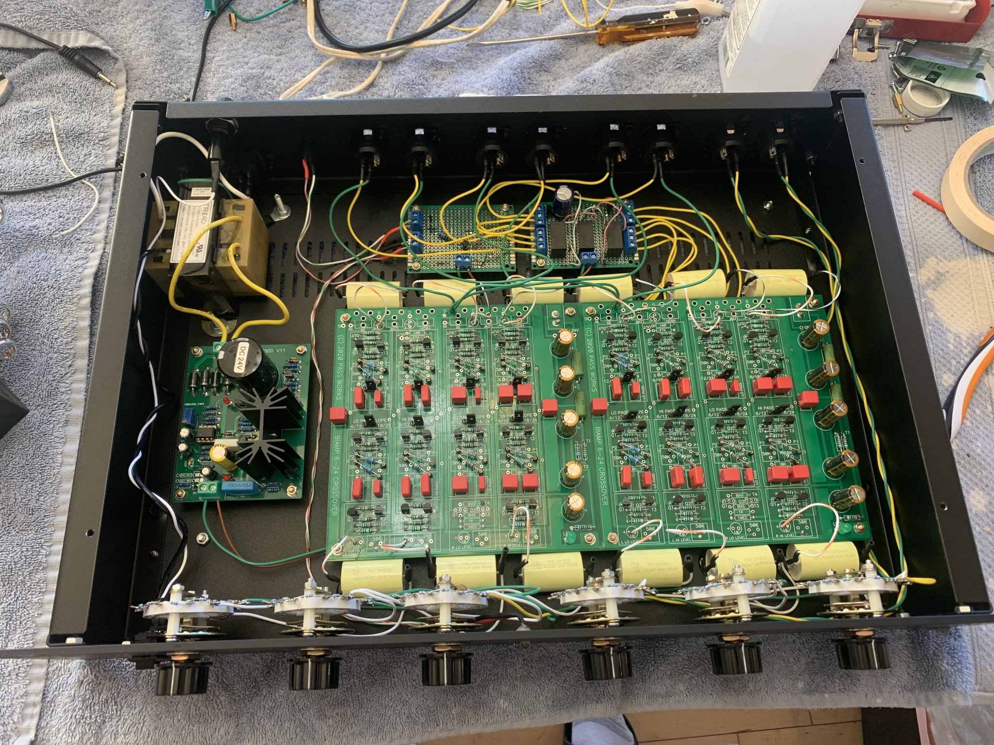

A little over six months since I built this as a three channel active crossover using two boards. Still had some hum at my listening position. Didn't bother me enough to resolve, but c'mon there should not be noise. Audiophile acquantaince came over to listen to some changes I had made in my setup, and mentioned the hum. Likely shamed me into action. Looked at my picture and noted power supply's step down xformer was closest to the area of most hum (left subwoofer out). Used bench power supply no noise. Eureka, found it. Threw in a torodial xformer which resolved, but went the extra mile and fabricated a faraday shield. Love this active xo, or xoxo for the active xo.
Before and after of power supply section.

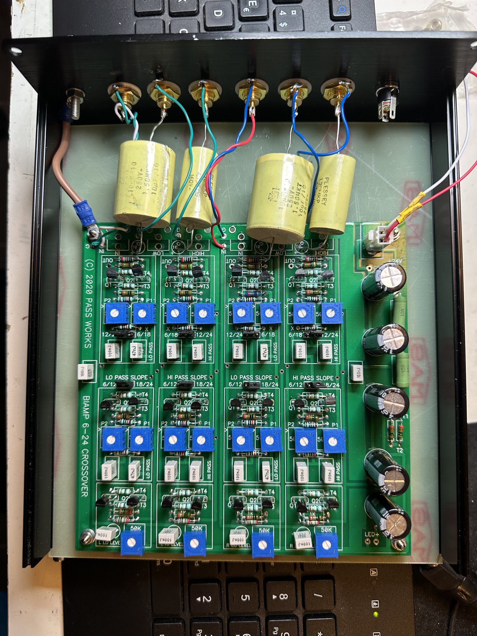

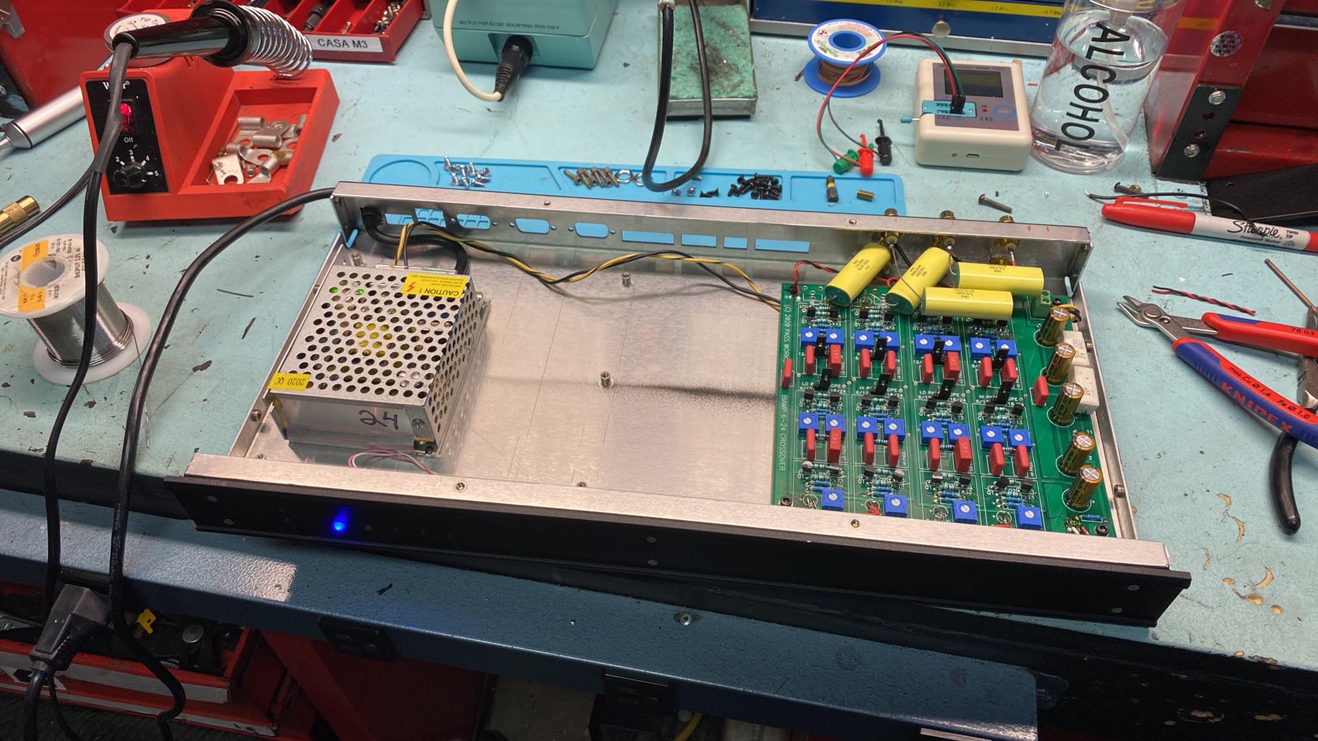

My second 6-24 filter. For external AC/DC with 5.5/2.5 barrel connector. I just wanted to show how some old Plessey 4.7uF and 10uF polypropylene capacitors can be used. Input capacitors are 100nF. To be used with Quad ESL-63s and one Wharfedale active subwoofer.

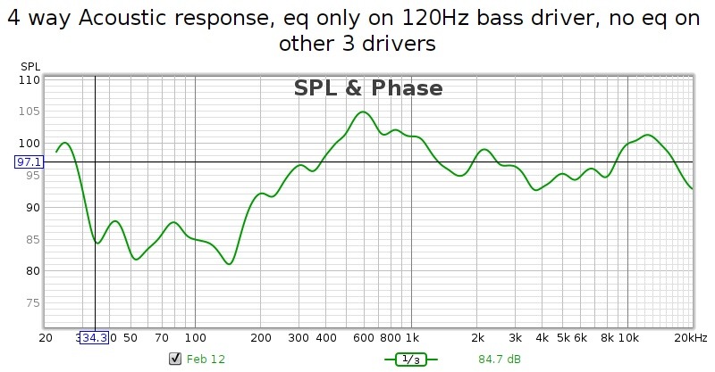

For anyone interested, I've attached overall in-room measurements (REW) of my daisy chain 4 way system with DIY biamp boards at 120Hz, 1kHz and 7kHz through drive units Seas LR26O4Y 10", Seas U22REZ/P-SL 8", Seas FU10RB and B&G Neo3 PDR (no back cup) respectively.
Analog EQ only on the bottom 10" channel, no EQ on other channels at all.
I was quite surprised to see such a lumpy graph. Aside from the huge 25Hz hump which I suppose is due to my garage's poor acoustics, there is a noticeable 12dB/Oct roll off from about 400Hz down to 120Hz, presumably due to no EQ and no appreciable front baffle on the 8" drive unit.
Multi channel amplifiers are DIY LM3886 (inverting), so I'm thinking to modify negative feedback components of the 8" channel amplifiers (120Hz to 1kHz), in order to incorporate a Shelving Low Pass filter to EQ this 400Hz to 120Hz roll off in the Lower Mid response.

@davidkou Your results don't look surprising at all. This is why I queried you about equalization in your project. 🙂
Generic crossovers just won't work with this type of open-baffle configuration without equalization.
I suggest to use a DSP platform to develop your design.
And if your ultimate goal is to use an analog-only circuit design, keep that in mind while using the DSP so you can actually realize the final result with an analog circuit.

@Davey I don't disagree, I started with the DSP approach some years ago with my Orion inspired 3 channel version (with totally different drivers to SL's) using upgraded Behringer Ultradrive and Ultracurve processors. I was able to get very nice sound with fairly flat in-room responses.
Ultimately I found that my own very basic Analog crossover based on LR4 B1 followers (without any EQ on top end drivers) similar to these Biamp boards gave better openness and dynamics. I was surprised the minimalist ASP better suited my taste despite the major compromises in the measured response and lack of room correction.
I think technical measurements are indeed very important but need also to be interpreted with a certain caution as they simply don't reveal some precious qualities such as Transparency.
With this in mind I'll try to improve on recent measurements without compromising those aspects which I hold dear, but accept I may have to live with some large bumps in the measurements. For me this ASP is useable as is, and I'll post as I go further.
