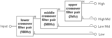

So I just want to make sure I am reading this right.
If we want a 3 way crossover, we simply daisy chain the output of one crossover into the input of another?
If this is so, which output should feed the second crossover? High or Low?

Two questions about the circuit. First is, Is there any insertion loss? possible gain?
Second is, am I correct in seeing the lower of each vertical jFet pair as a current sink under what in tube terms would be the equivalent of a cathode follower?
No gain. Slight loss.
Yes, the circuit is a Jfet follower, biased by a constant current source to ground,
so it would be similar to a Cathode follower biased by a constant current sink.
