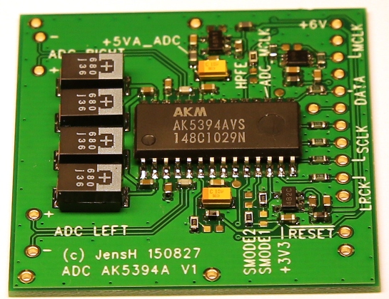

I got the AK5394A add-on boards back a few days ago. One board has been mounted. I have connected it to the main PCB using one analog input channel to feed one ADC input. The other analog input channel is still connected to the AK5397, which is quite convenient, because I can use both converters simultaneously, making it easy to compare the performance.
I have modified one ADC driver to fit with the AK5394A. The total gain had to be changed a little (around 1.3dB) to get the same sensitivity on the AK5394A channel and the AK5397 channel. The difference is less than 0.1dB.
I have attached a picture of the AK5394A board and some measurement results. All the measurements shown are at 192kHz sample rate. The red (right channel) is the AK5397.

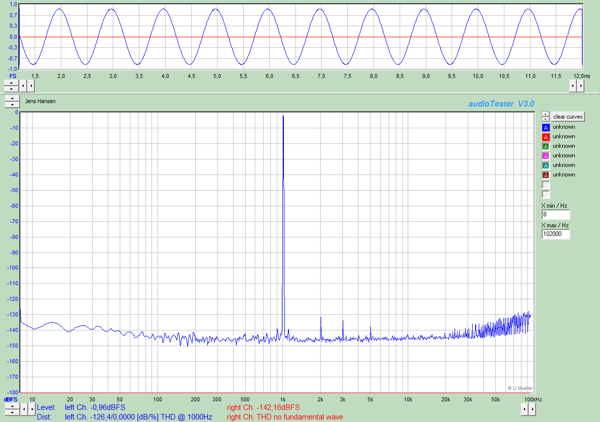

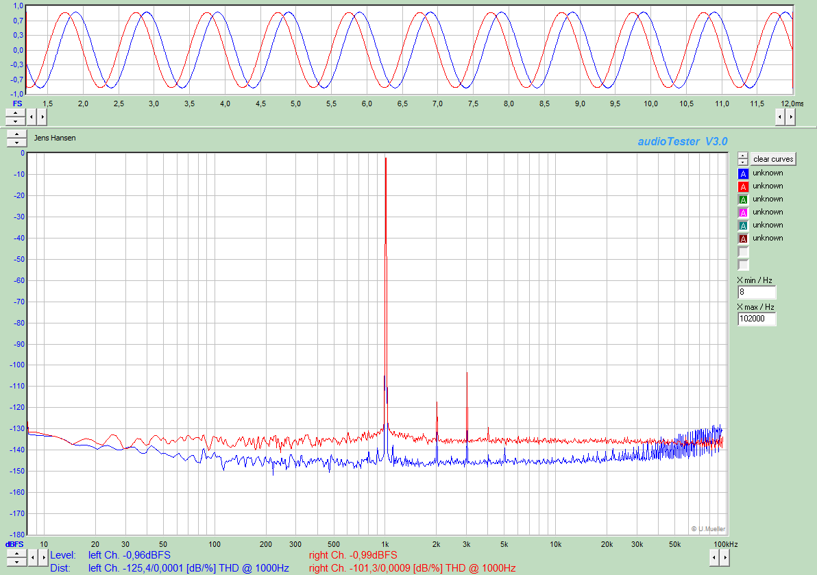

Distortion: The AK5394A is a clear winner! With an input signal of -1dBFS I measured THD at around -101dB for the AK5397 and -125 to -127dB for the AK5394A! To get to the results of -125 to -127dB I had to cool the AK5394A a little. When left running for around 30min the distortion increased to around -119dB. Not quite as muxh as what I saw on my older AK5394A design. This may be due to the fact that the AK5394A add-on board is mounted vertically and therefore gets more natural cooling than the older design, which was a flat design.
The ADC temperature clearly changes the 3rd and 5th harmonics. The 2nd harmonic is almost constant when changing the temperature.

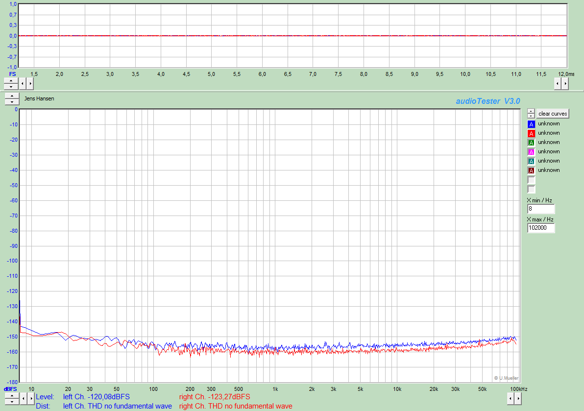

Idle noise: The new AK5397 wins by just over 3dB, which was expected. The measurement was done with a 150ohm resistor across each input, set to the 3V range. The noise level was measured over a 20kHz bandwidth.
While the idle noise is low on the AK5397, the noise increases quite a lot when high signals levels are input. See the last figure.
The noise at the upper end is from the generator (AK4490). It depends on the output level. It disappears at high levels, but then the distortion increases.
To rule out differences in the two channels of the generator, I also tried swapping the leads. This made no difference. I also tried the Stanford Research DS360. The results were almost the same, but I could not quite reach the -126 to -127dB distortion. Around -125dB was the best result I saw.
So the preliminary conclusion is that for this design I need to go back to the AK5394A. Perhaps with some temperature control to get the best performance.
This means a farewell to the sample rates above 192kHz, but if the choice is between THD of -101 and -125, this is a small sacrifice.
Idle noise_150ohm across each input_AK5394A left_AK5397 right_input 3V range_128k FFT_average ov.png36.6 KB · Views: 1,108
1kHz distortion_AK5394A channel_-11.4dBFS out from AK4490_input 3V range_128k FFT_average over 1.png36.3 KB · Views: 1,058
1kHz distortion_AK5394A left cooled by blowing with a straw_AK5397 right_-11.4dBFS out from AK44.png41.1 KB · Views: 1,103

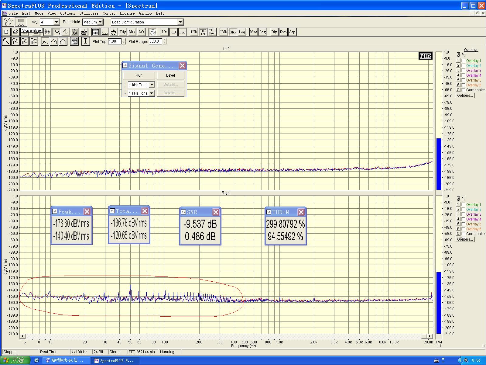

Yes, there is definitely some noise from the power supply. Could be magnetically coupled or coupled due to the layout.
But apart from the 50Hz and harmonics there is some additional noise, with a distance of around 10Hz. This looks a bit strange.
Once you add some gain to the input there will probably be even more noise. In my measurement I set the input to the 3V range, which means that the gain is around 12dB higher than it is in your input circuit. It takes a careful circuit design and layout to optimize the noise performance.
I don't think that the temperature influences the noise floor in any significant way (except for the usual thermal noise of course). I have seen a much larger influence on the distortion.
If you connect the inputs of the ADC directly to ground the ADC will not really work and you the output is meaningless. I assume that you have a 2.5V reference voltage on the OPA1632 although it is not shown in your schematic.

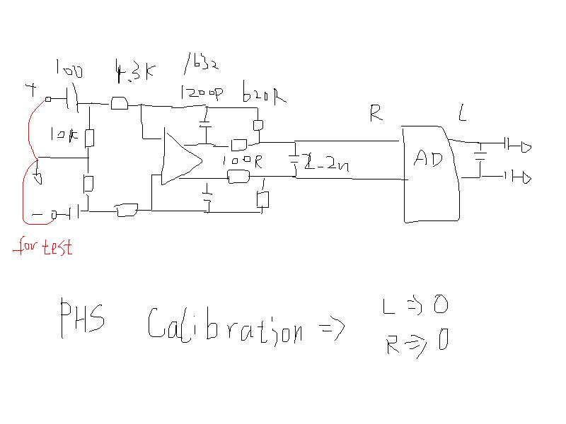

thanks for THx-RNMarsh , JensH .
MY PSU is 78xx/79xx , Vref is 10K+10K+100uf from AK5394 AVCC 5V .
I will build another PSU and check the " GND "
