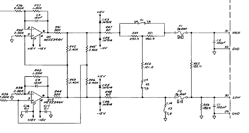

I think the real issues on the output is voltage into 600 Ohms vs. open circuit and whether the balanced output is isolated from ground. The last is really important for systems that will have ground loops and other problems between input and output.
At the moment the outputs are not isolated from ground. I will consider that also. It may not be too difficult, but it will require some additional power supply circuits, some digital isolators and perhaps a transformer for the MCLK.
Would it be sufficient to have all the outputs on one separate ground, so that the two balanced and the two single ended outputs share the same ground plane or does each of the two channels need to have a separate ground? The latter will complicate it further.
At the moment the output impedance is 25 ohm single ended and 50 ohm balanced. I have not included other impedance options.
At the low levels the output impedances are even lower, since I connect the attenuator directly to the outputs, when using the -20 dB or -40 dB steps. There are no resistors in series with the attenuator outputs to achieve a 25/50 ohm output impedance. It does give a small advantage in terms of thermal noise at very low levels.
Does anyone see a problem in the non-constant output impedance?

I have found that having known impedances has been very important when I add esternal networks. I have an RIAA network and an attenuation network both of which interact with the source Z so it is an issue for me. I built these for testing really sensitive circuits (Moving coil inputs) so low impedance at the output and good isolation from ground noise was important.
I have used the self correcting balanced circuit with success. I can dig it up and post it later. It uses feedback to ensure the output voltage follows the output ground, not the generator ground. Max output is limited but may be enough for most applications. The option you mention with optoisolators and transformer coupled clocks may be more complicated, or not. Mostly depends on the power supply.

Output circuit suggestion
Below is what I'm suggesting. With buffers it can be scaled to 50 Ohms (but needs plenty of power supply). As long as the difference between grounds is not a lot the output will track the output ground reference. It only needs a handful of resistors and works quite well. You can add a center tap and have an active balanced circuit tracking the load. however you will be limited to around 6-7 volts RMS with a 15 volt supply.
If the difference between the grounds gets too high then you will run into problems but that seems unlikely in this application.
