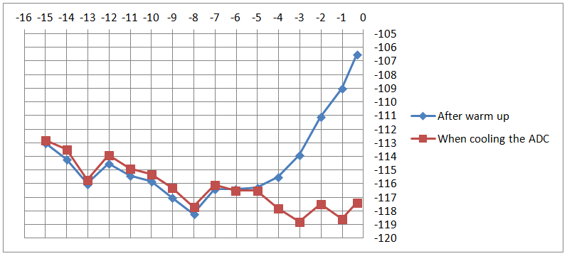

I have measured the distortion of the AK5394A versus the level. With and without "cooling".
The cooling was done by blowing on the ADC through a straw. Without cooling the surface temperature of the ADC seems to be around 65 degrees C, measured with an IR thermometer.
After power ON I had previously seen some fairly high levels of distortion. I now think that this may be related to the initial internal calibration. The reset timing is fairly long, but perhaps not quite long enough. In case of problems I gave it a manual reset. So I think that it is probably OK (right after power ON) as long as the initial calibration is done correctly.
The figure below shows the distortion with and without cooling. There definitely seems to be an advantage in cooling the ADC.
The X-axis shows the measured level in dBFS. The levels measured range from -15dBFS to -0.3dBFS.
The Y-axis shows the distortion (THD) in dB.
The generator was a Stanford Research DS360.
The results have improved a lot. At high levels they may even be limited by the distortion of the DS360.
It would be interesting to find out if others can verify these results in other setups.

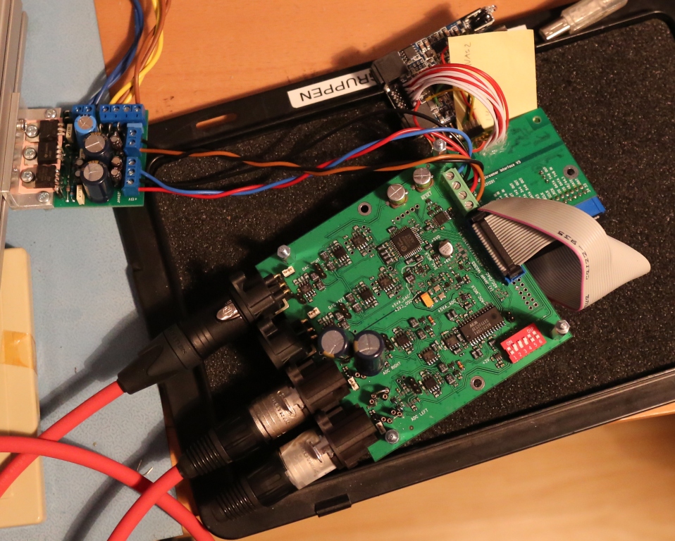

The measurements on the AK5394A were done on a design I made last year. The basic concepts are the same, but the input and output stages are much simpler. And parts of the power supply are off-board. I have attached a picture below.
Hopefully I will find the time to make the same measurements on the AK5397 board soon.

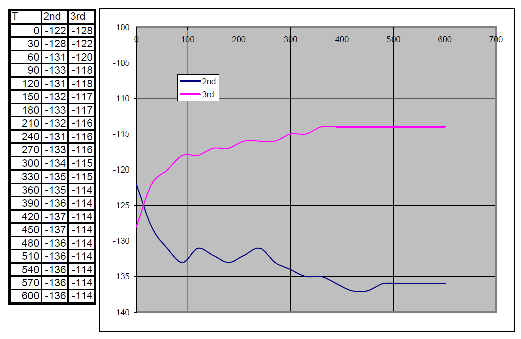

JensH - do you have a possibility, to try another 5394?
I make some measurements, and even I have seen the tempersture/puwer_up issu, my results are not correlate with yours.
Measurements were taken at -1dBFS, signal from Victor's generator.
See the picture - the 2nd harmonic drops from -122 to -136dBFS, the 3rd - rise from -128 to -114dBFS.
Graph sows the first 5 min. after power up.
After 20 min, 2nd harmonic level was ~-139-140, the 3rd - -114dBFS.
When I worm the chip with the blower, the 2nd rise to -120 and the 3rd - to -100, but it was extremally high temperatire (I think >80C).
P.S. Experiment with overclocking failed, 5394 not works at 352/384 with 22/24MHz MCLK with any DFS0/DFS1 combination.

I do have some spare AK5394A's. But they are not mounted at the moment. I plan to either cut out a part of the PCB shown in the previous post or perhaps make a small PCB with just the ADC and a couple of LDO's + passive components around the ADC. This could then be used in a test to replace the AK5397 in the larger design,
At least your tests also show a strong temperature dependence. Your second harmonic goes to much lower levels, but my measurements may be limited by the performance of the generator. It does seem like the OPA1632 input circuit that I have prefers a differential input. With single ended inputs (from either my 1kHz low distortion generator or the VP7722A) I see increased distortion at high levels.
A difference in the sensitivity to warming up (temperature increase) could perhaps be caused by the PCB's. Perhaps your PCB has a better heat distribution than mine? Or gets warmed up less from surrounding circuits?
I made these measurements with SE input.
I also tried to cool down the chip with the freezer spray: 2nd rise to -112, 3rd - to -105.

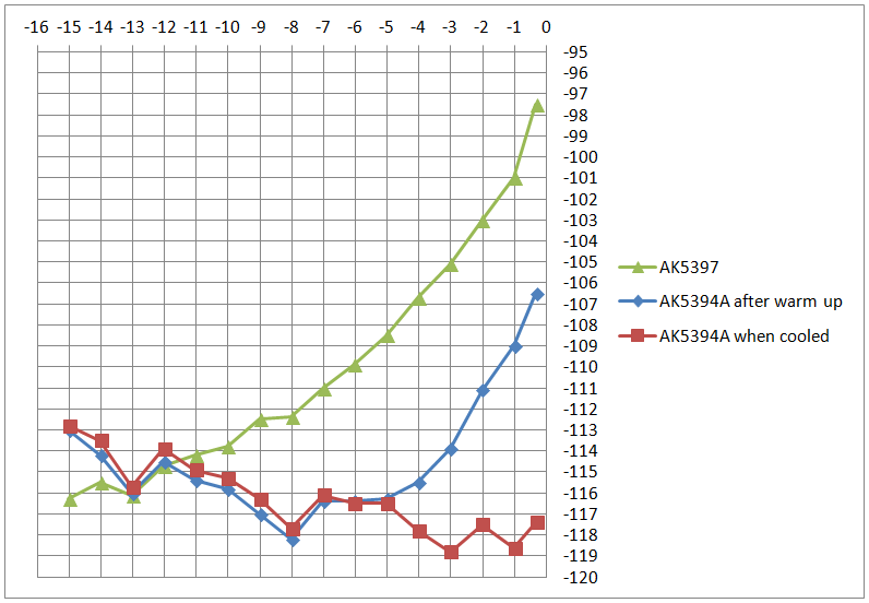

I have just made some measurements on the new AK5397 based design for comparison.
The good news is that the AK5397 seems to be very stable over temperature 🙂
The bad news is that the distortion, at least in this setup, is much higher 🙁
The input circuits are quite different, but I think that the input stage in front of the AK5397 should be OK. On a test board that I made some time ago, I measured a distortion of around -132dB at 10dBV input.
I have used a design based on LME49990 to drive the ADC. In the AK5397 data sheet this op-amp actually seems to deliver poorer distortion performance than the LME49710, which is very strange. So there may still be room for improvements.
I have attached the comparison of the AK5397 and AK5394A results.
