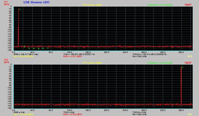

With the USB streamer I am limited to 192kHz.
Hmm, not really while the streamer as 8 I/O channels and those can be used with channel bundling for 2x, 4x stereo or 8x mono speed of the base sample rate as 192kHz.
I implemented already those using the ASIO interface where you could have 1x on output and 2x,4x8x on the input using the same sample rate.
Required is a custom HW solution how does the channel I2S bundling and un bundling for the I/O... see picture 4x stereo as 768kHz using local loop-back (as jumpers on the USBStreamer) ... Jens already know this 😀

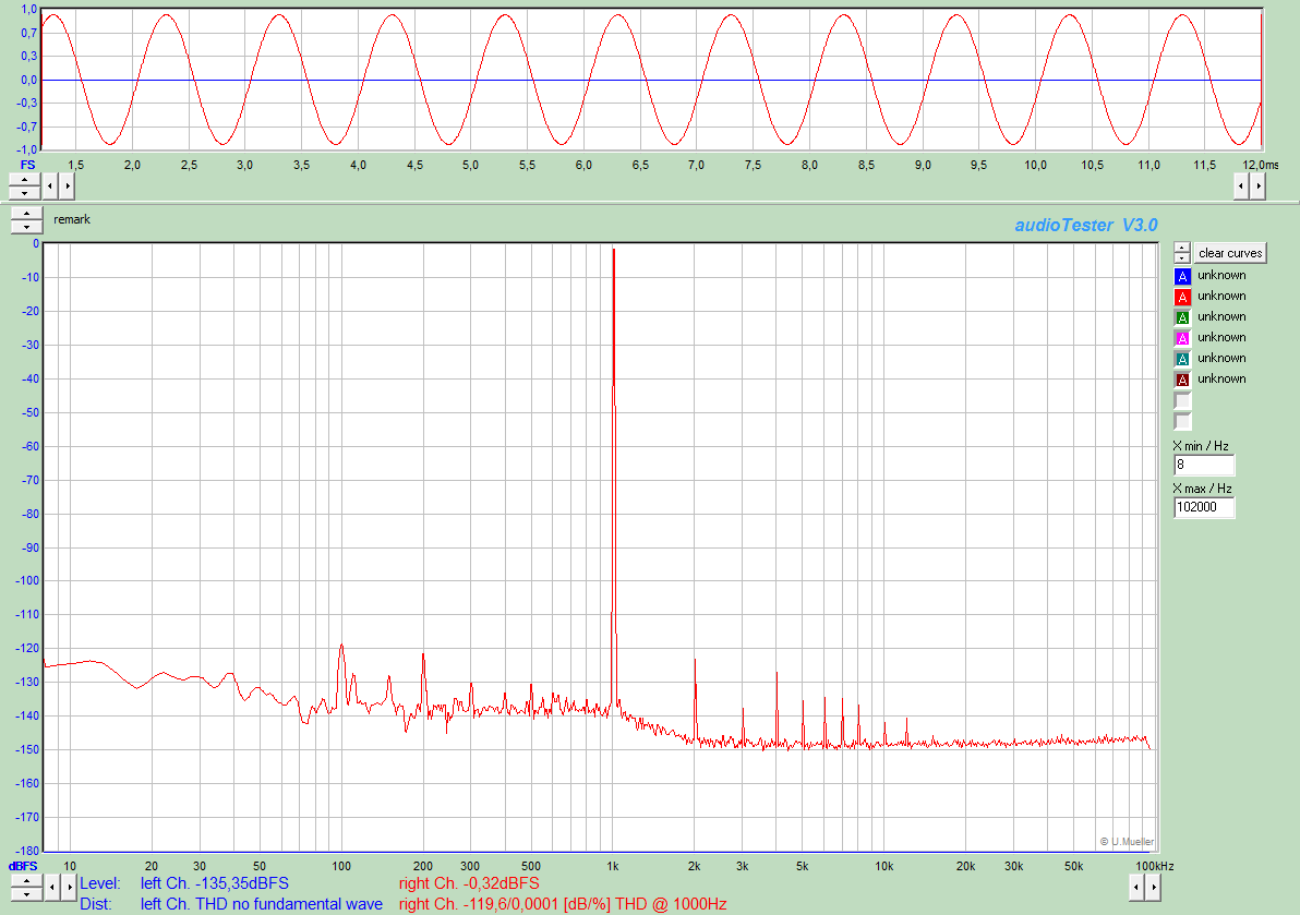

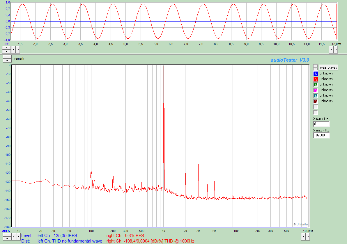

I took a look at the design around the AK5394A. I had made an alternative design around the decoupling of the VREFL+, VREFL-, VREFR+ and VREFR-. That turned out not to be a good idea. I have now added 4 x 330uF/10V tantalum caps on these four reference voltages. And this gives a huge increase in the performance.
I have shown two measurements below. The best result I have seen until now was on an input with just an OPA1632, connected through 2 x 1000uF/25V capacitors to the generator (DS360). The THD at a sample frequency of 192 kHz and a level of -0.32dBFS is -119.6dB. BUT: it changes over time (temperature)! I noticed that the distortion seemed to increase over time. I then tried to cool the ADC by blowing on it and the distortion dropped again. After around 5 minutes of warming up the distortion has increased to around -108dB. This is shown in the second figure.
At initial power-ON the distortion is even higher (above -100dB). It then drops and finally increases again 😕
It seems like it is primarily the third harmonic that changes with the temperature.
Has anyone else seen such a strong temperature dependence with the AK5394A?

The 4 x 330uF capacitors are used as reference decoupling capacitors. I could try e.g. normal electrolytic capacitors instead of the tantalums. But they are not getting terribly hot. At the moment they are hanging in the air, connected with short wires.
It seems to be the ADC IC itself, which is temperature sensitive. When I cooled it down, I used a straw, so that only the IC would get any real cooling.
I am not aware of any method to trim the distortion of the AK5394A.
